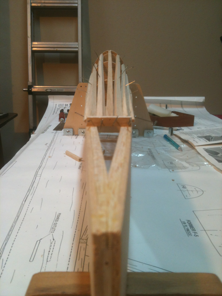

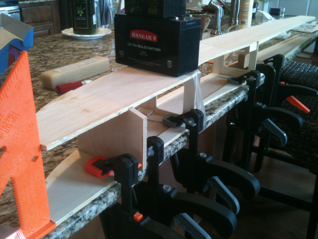

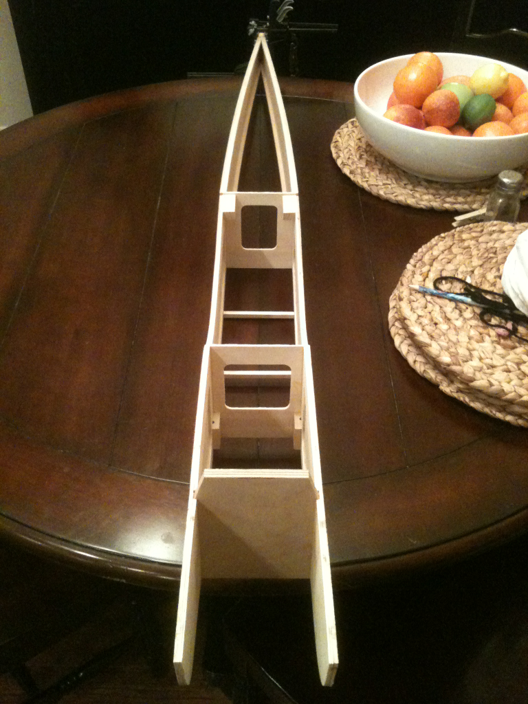

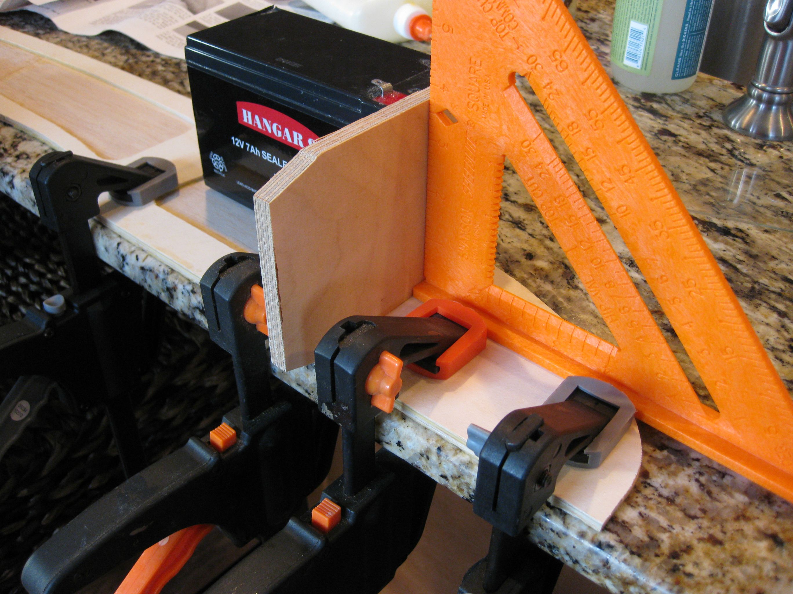

So, longerons (I think is what the manual called them) are now on the fuselage halves.
and the firewall.

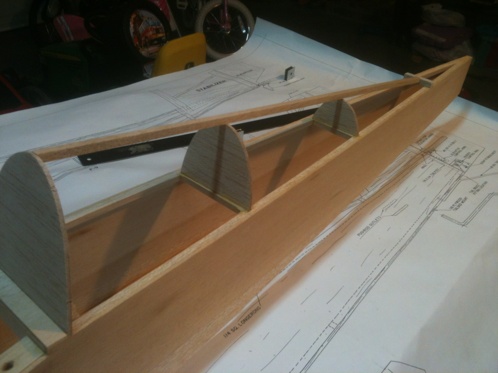

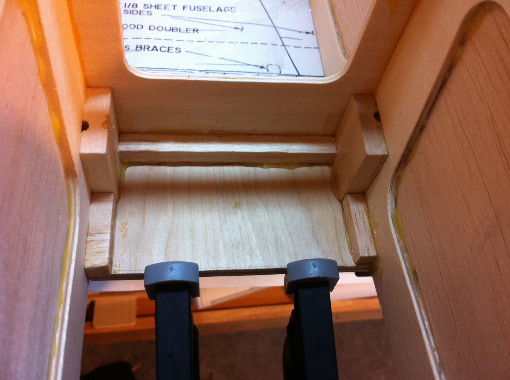

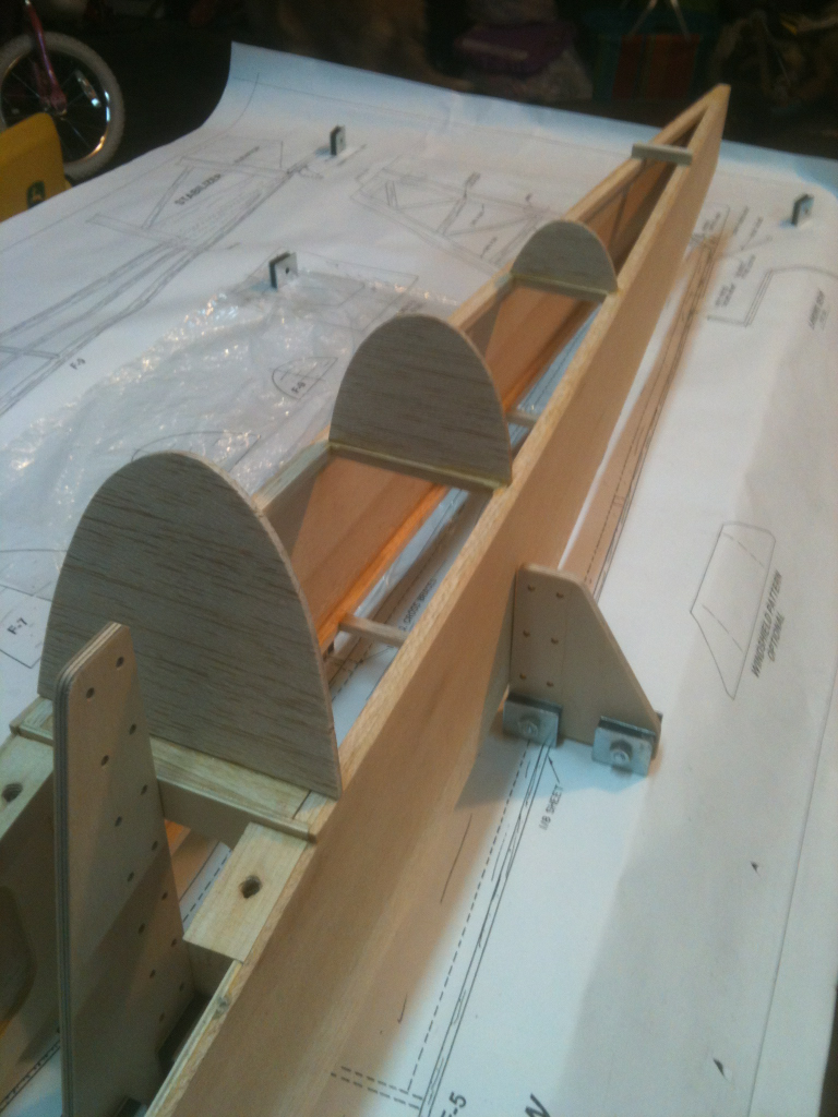

The fuselage is starting to come together, finally!!!

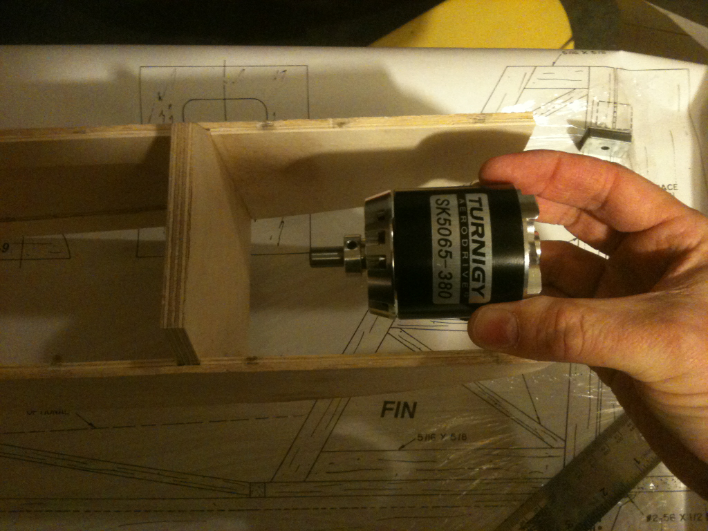

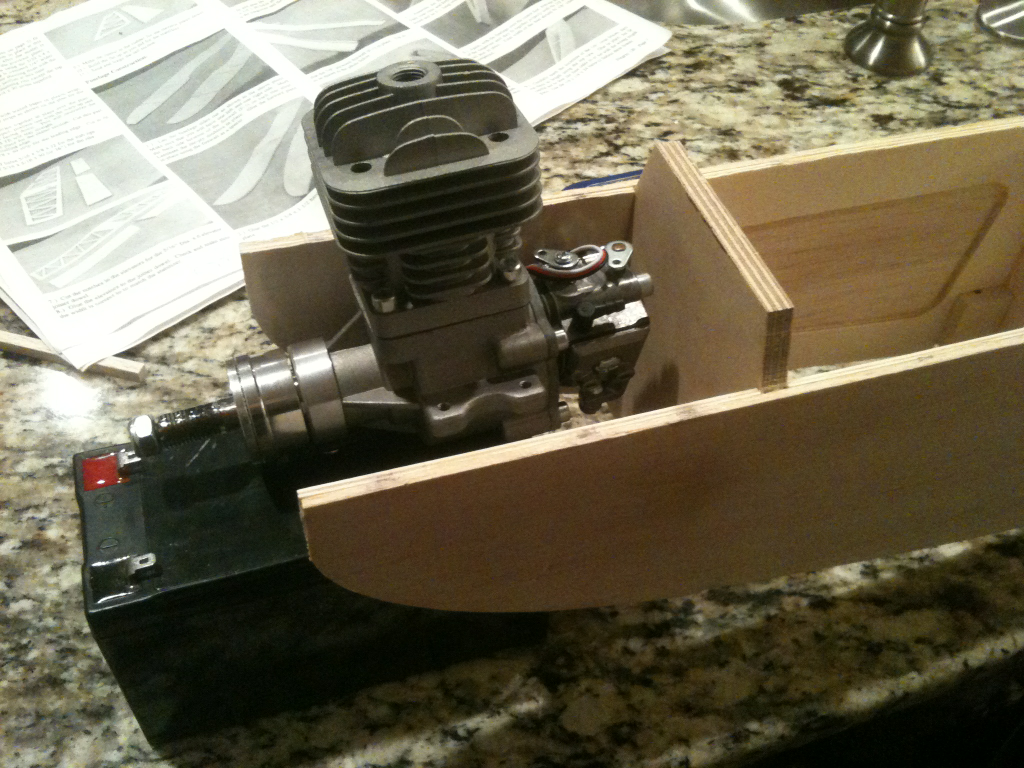

Thanks for the awesome comment! It's been fun but I was a little intimidated to start with a BUSA kit but I'm glad I did and it's much easier than I expected. I've really enjoyed adding things not in the manual.

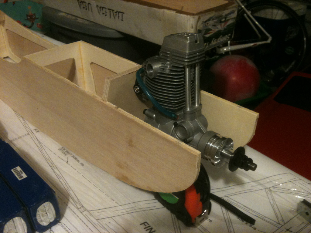

I think for now, I'm going to throw the electric motor on here just for the ease of setup. If it survives the maiden and looks to be a plane i won't get bored with after a half dozen flights, I may throw a four stroke on it.

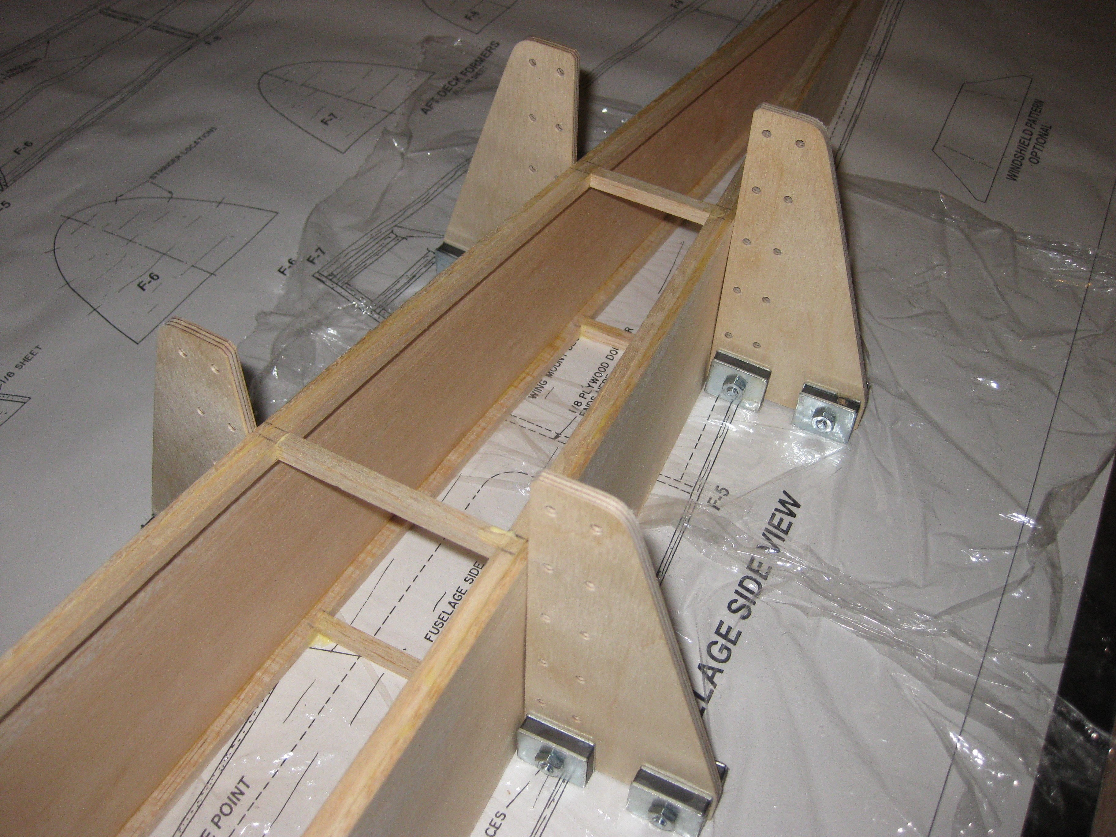

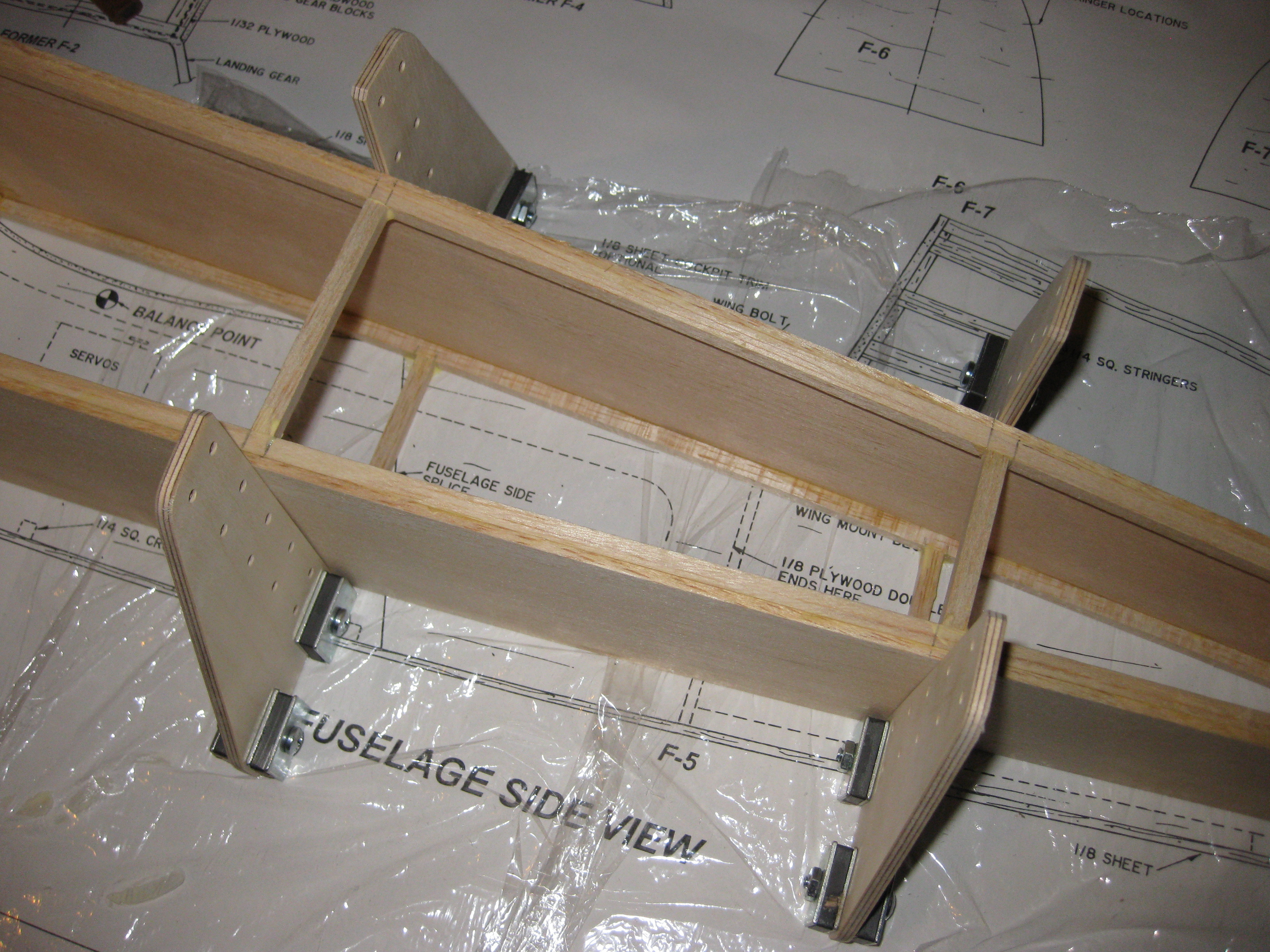

Finally getting to use some of the fixtures for my magnetic building board to glue cross braces.

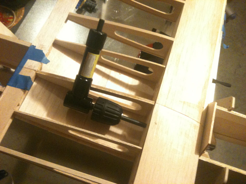

I've been waiting on a couple drill bits to arrive in the mail so I can drill out the wing dowels.

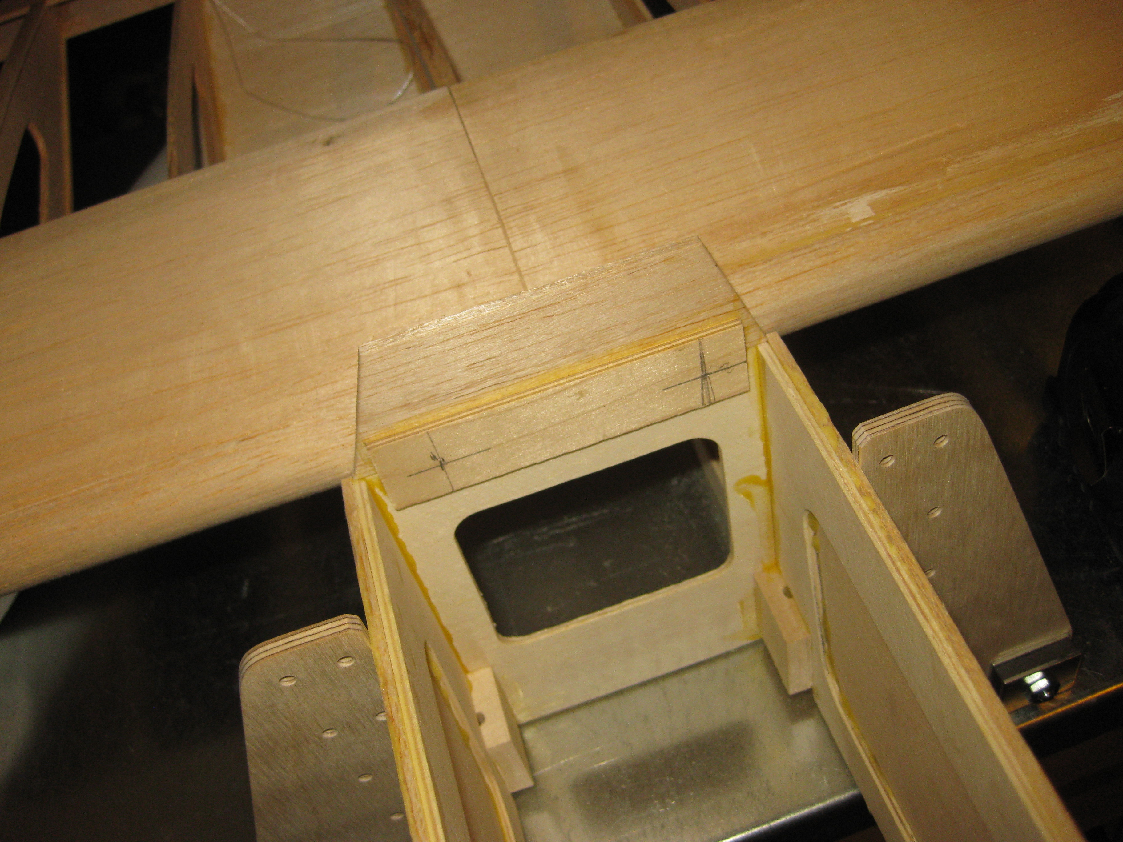

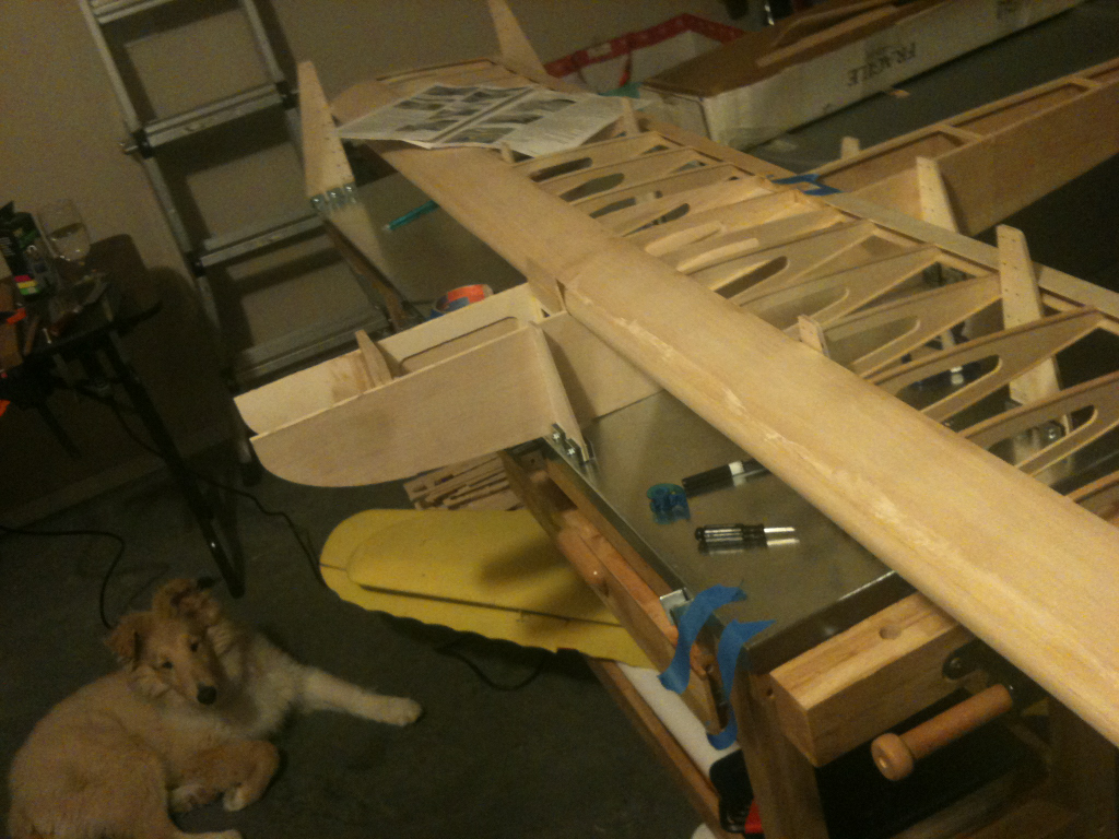

Got the wing dowel holes drilled!

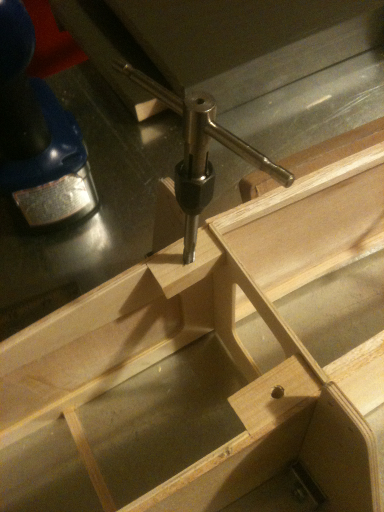

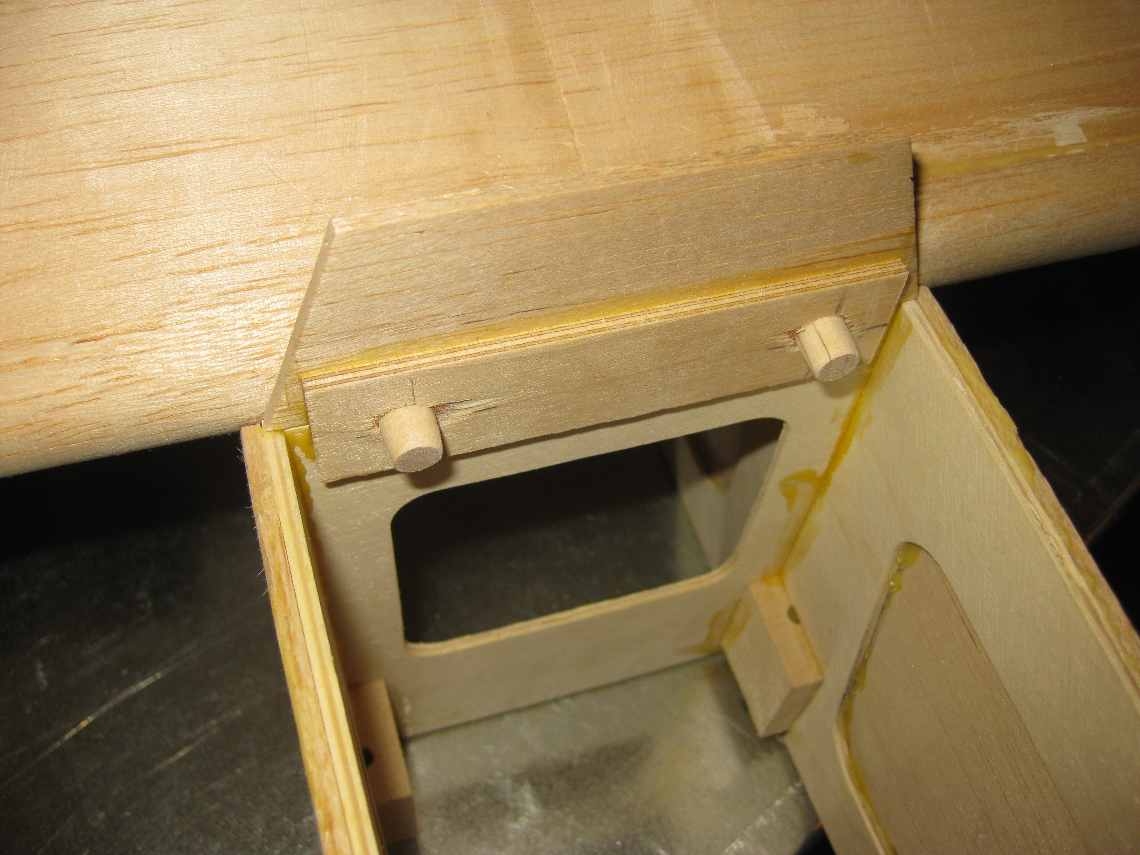

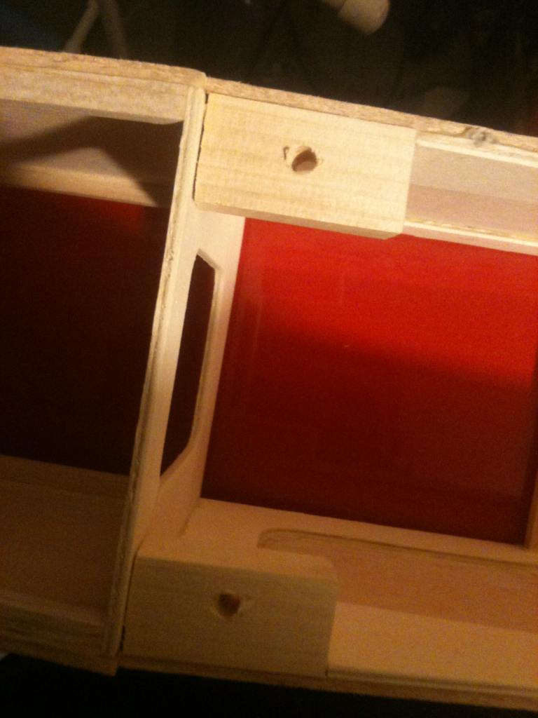

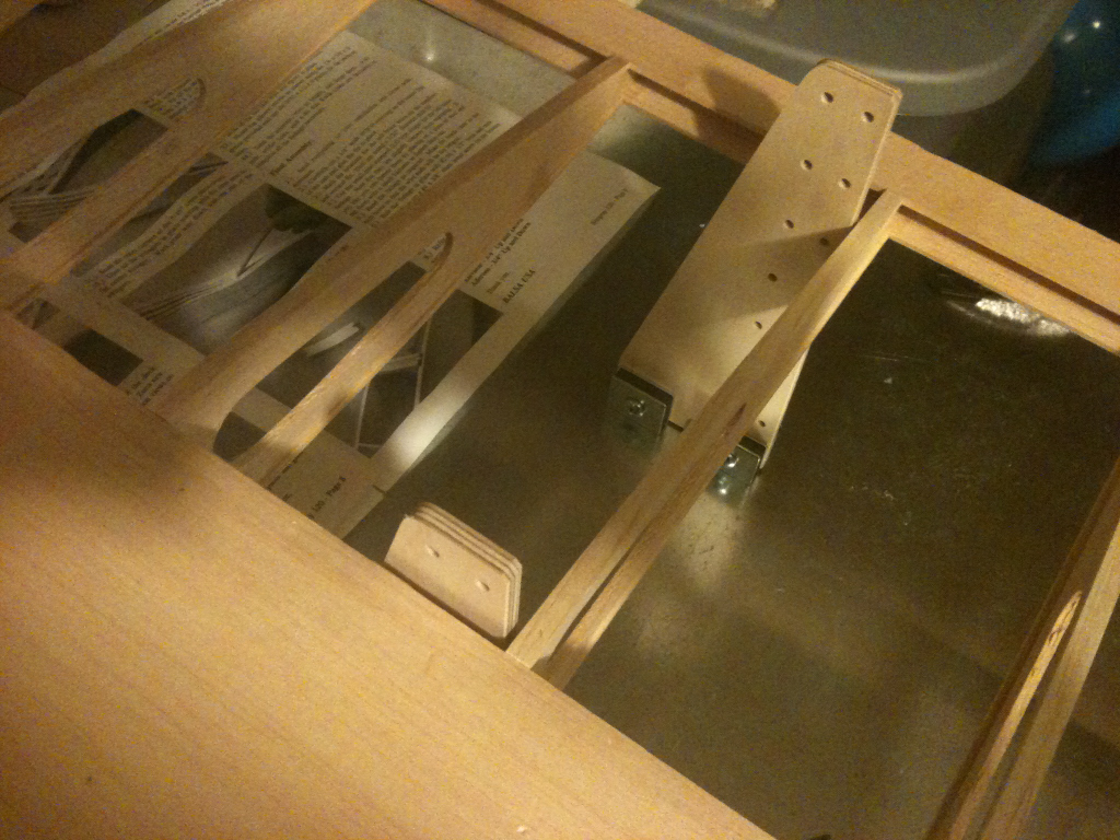

Wing dowels in place.
Drilled the rear wing bolt blocks.
I tapped them for the nylon wing bolts then hardened with thin CA.

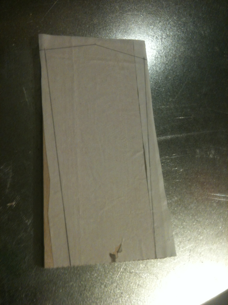

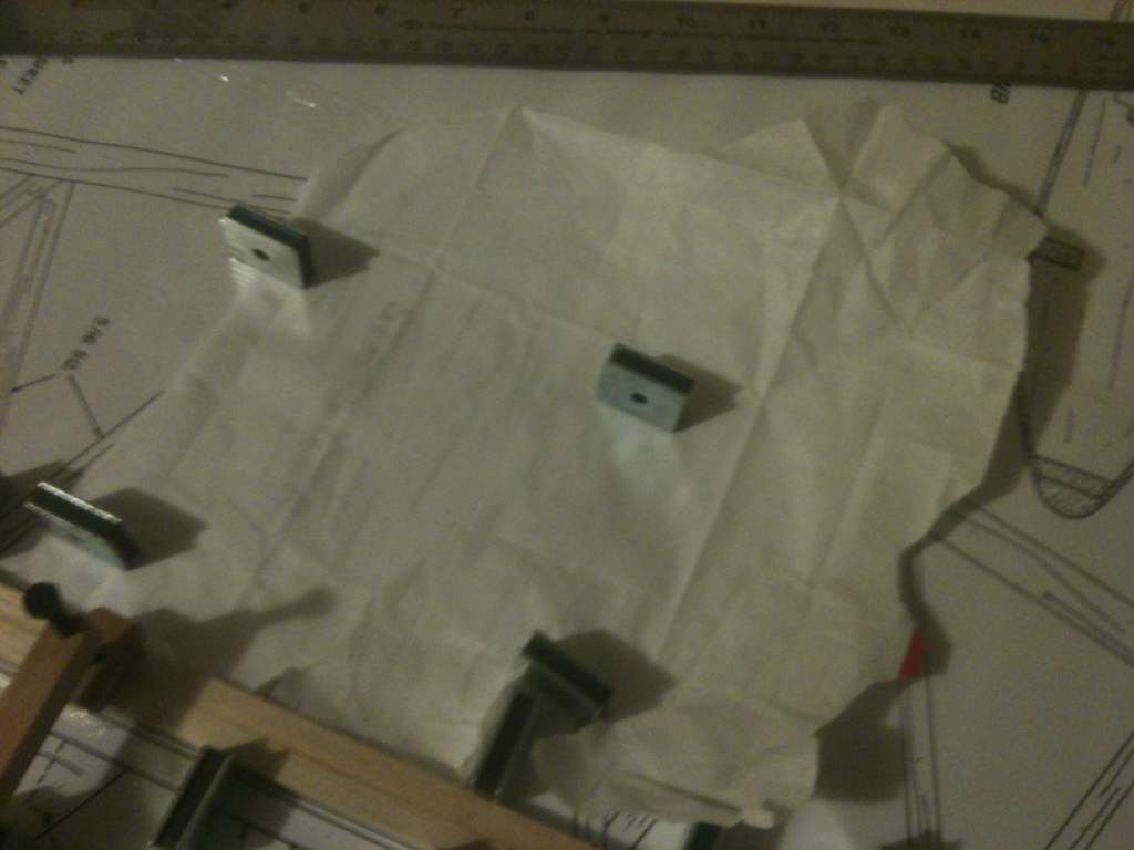

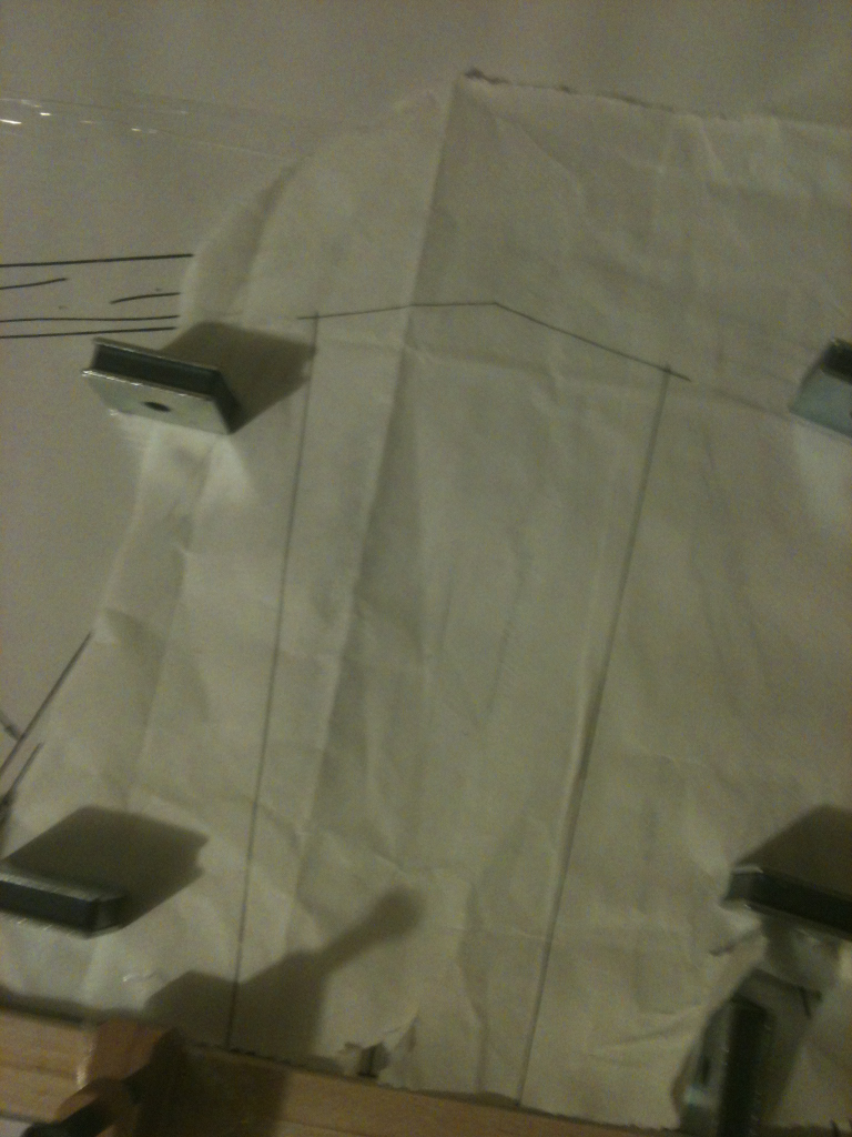

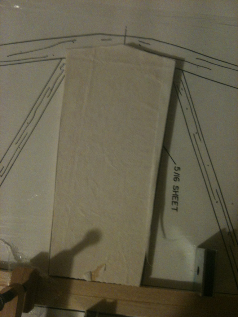

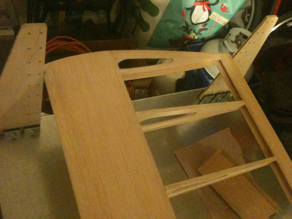

Back to the tail. I have to cut down this piece for the center section of the horizontal stab.
I found a piece of somewhat see through paper from my recycle bin.
Trimmed it up a little and used spray adhesive to stick to the balsa.
Ran it through the scroll saw.
done.

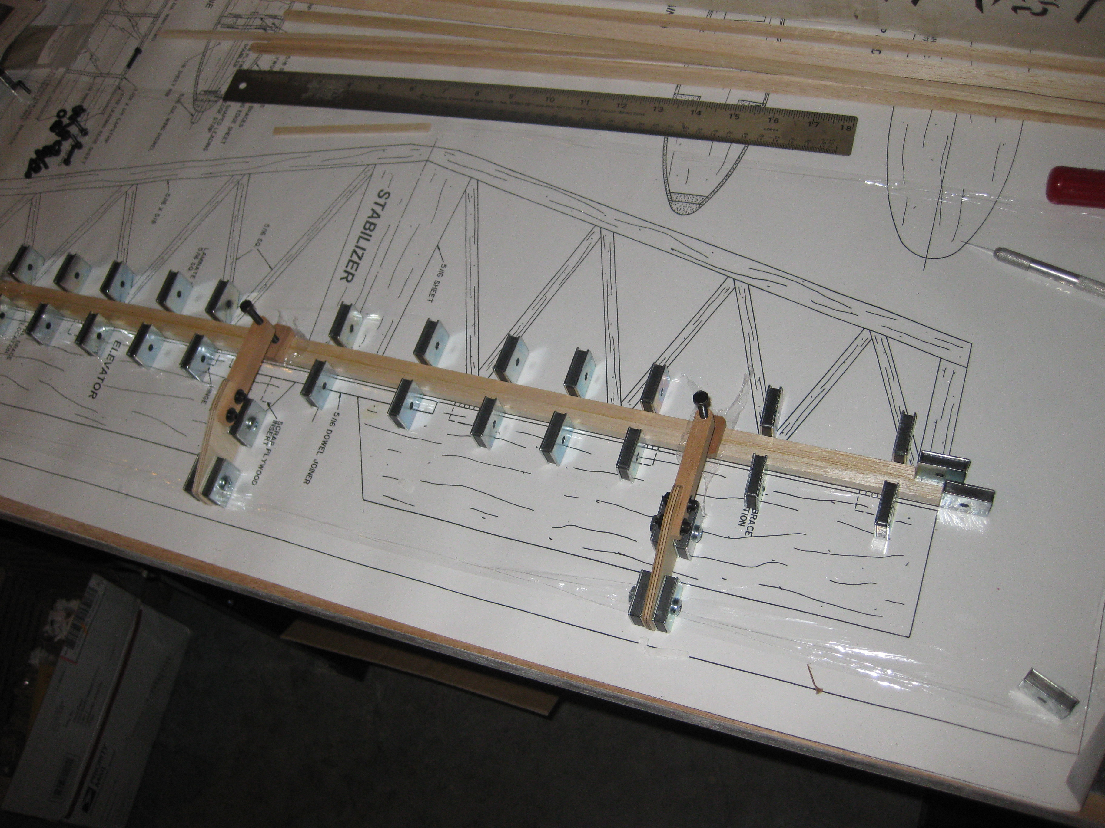

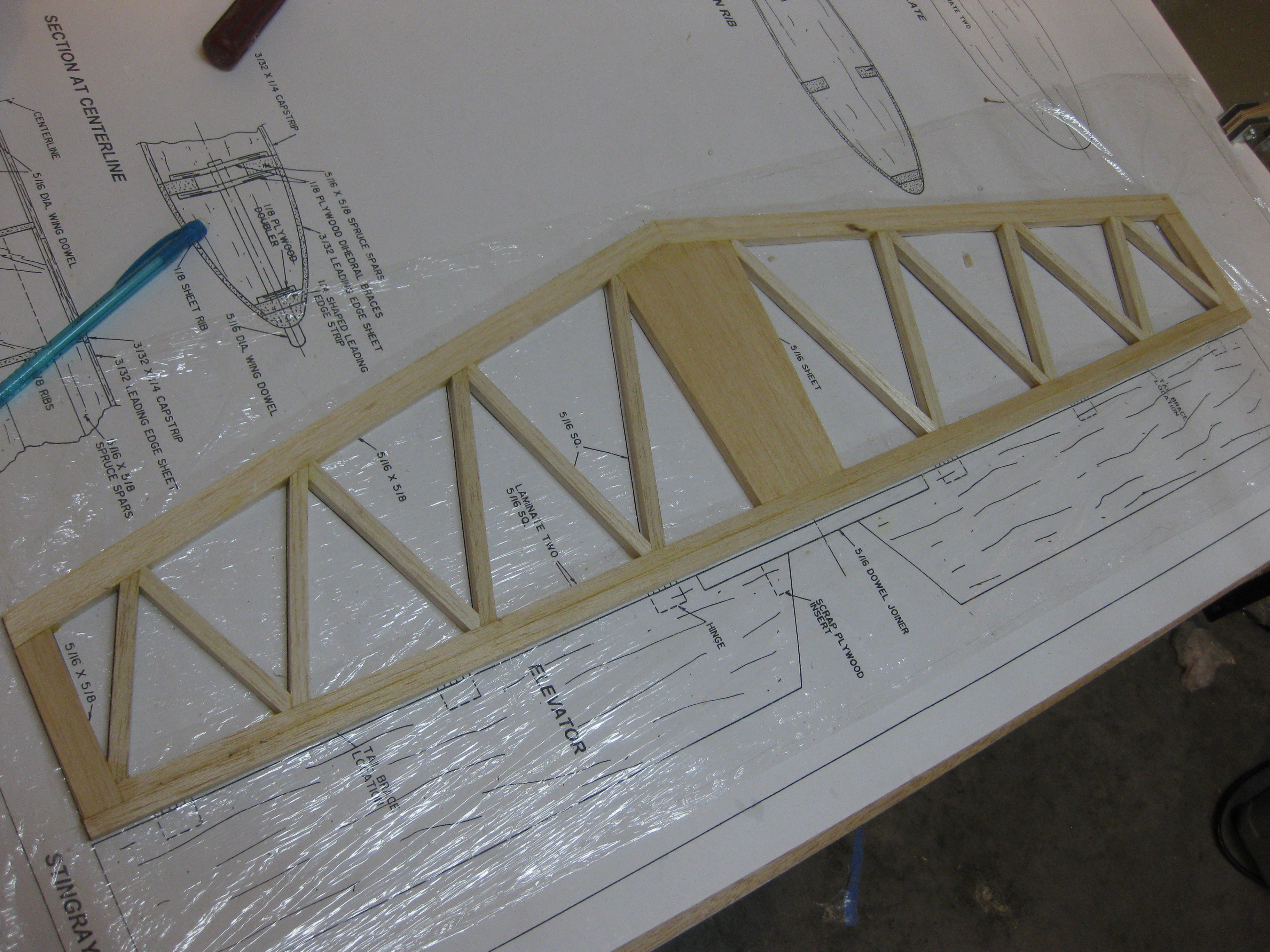

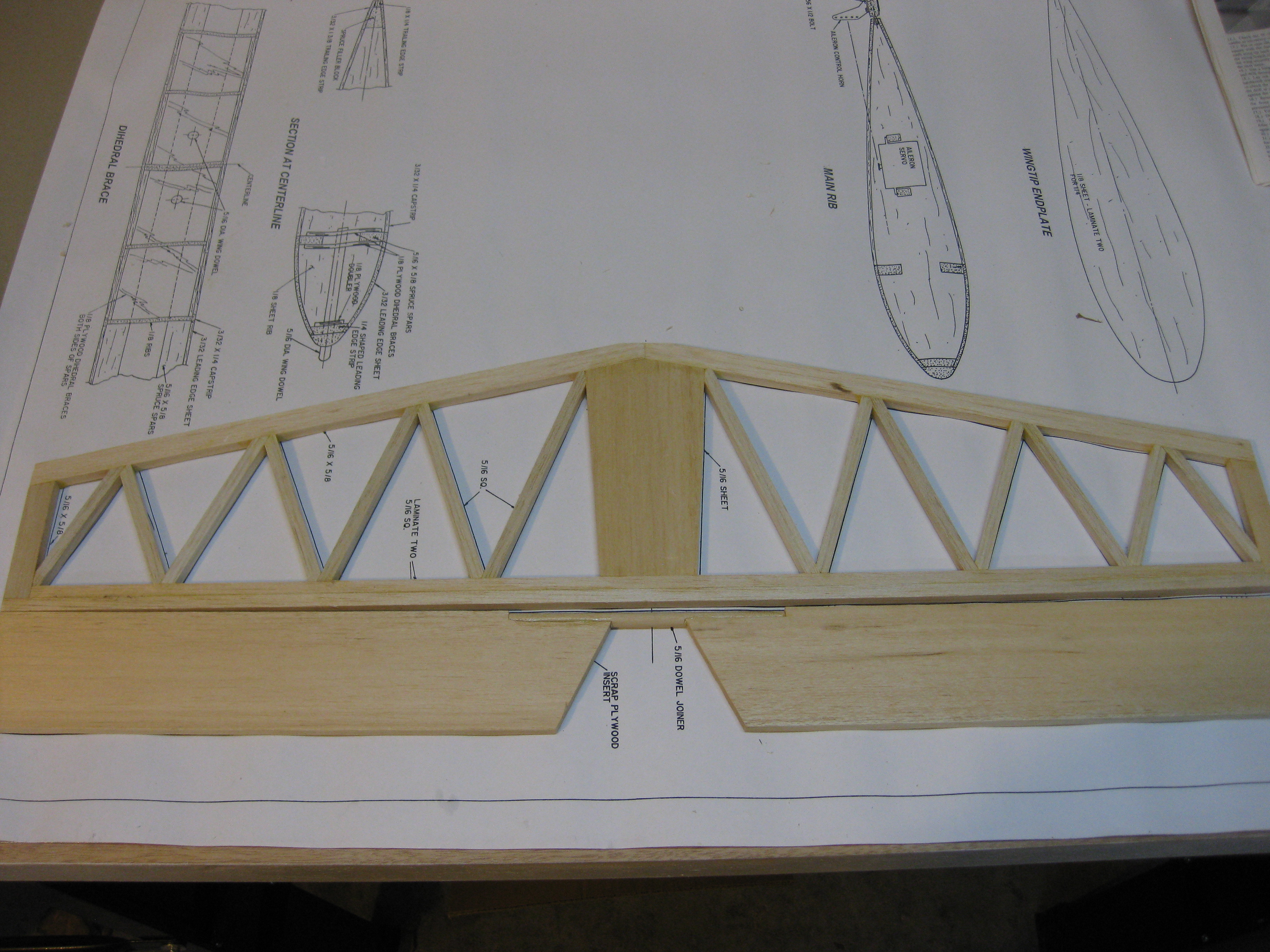

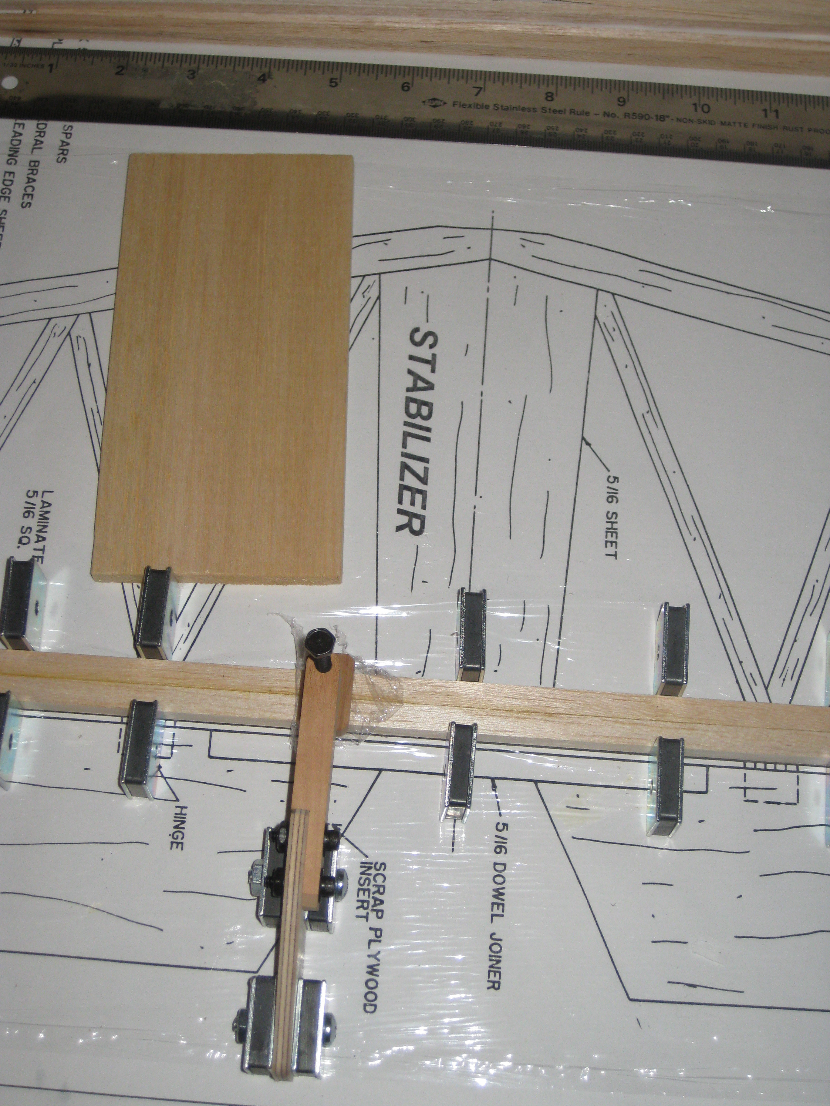

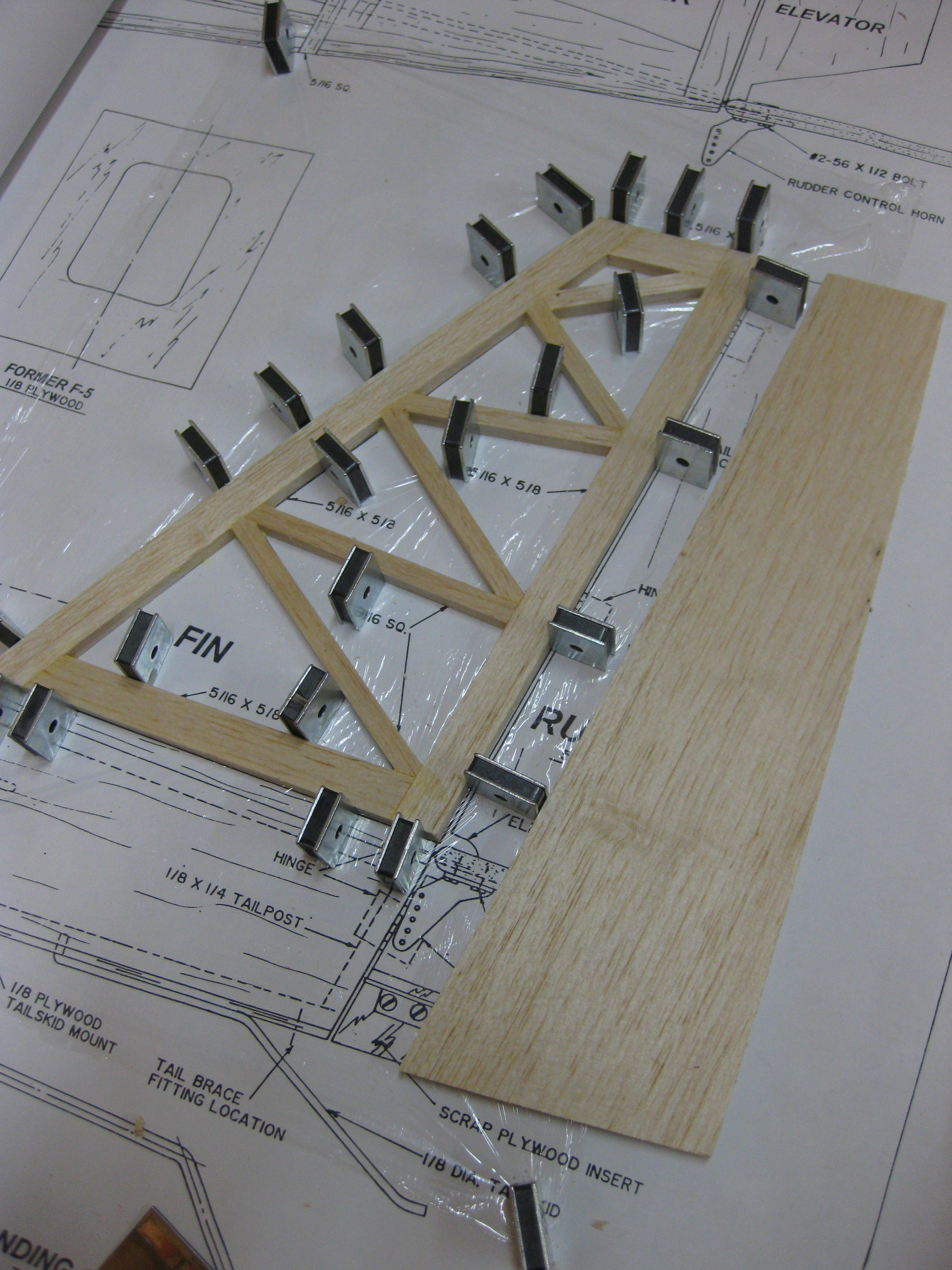

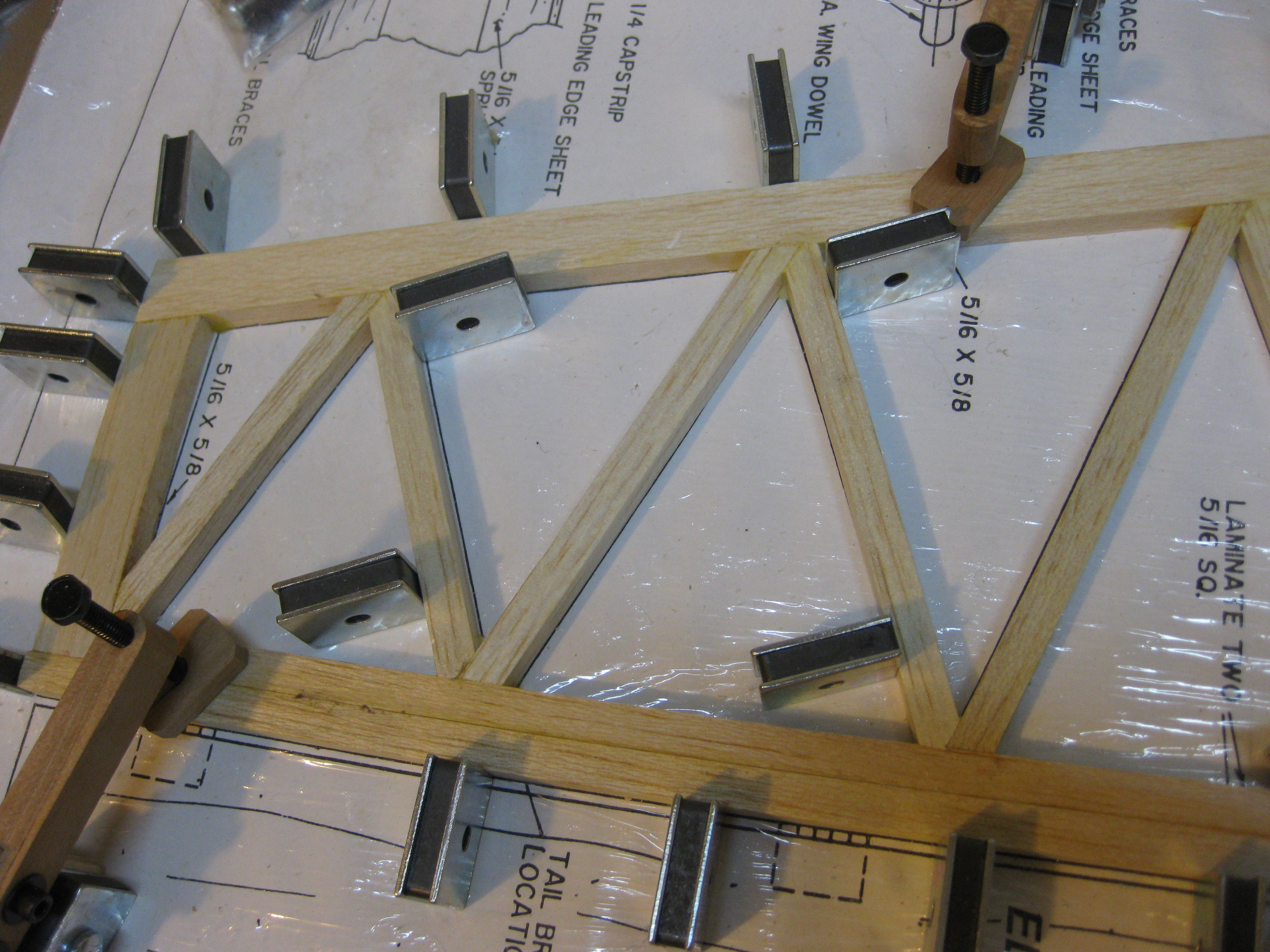

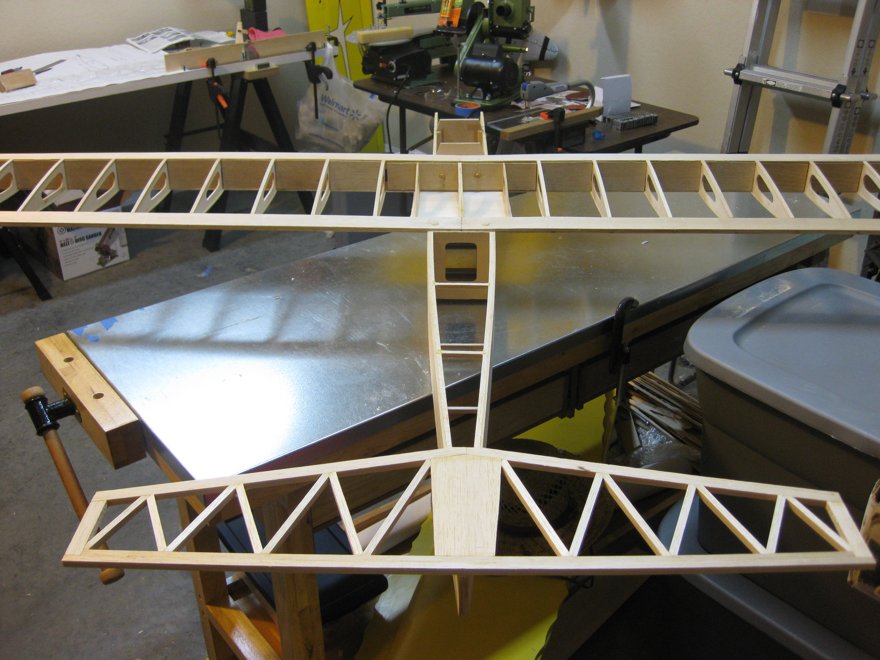

Finally finished framing the H-stab. (and added some extra lights in the garage).
I think I'll go ahead and build the elevator joiner like the plans call for.

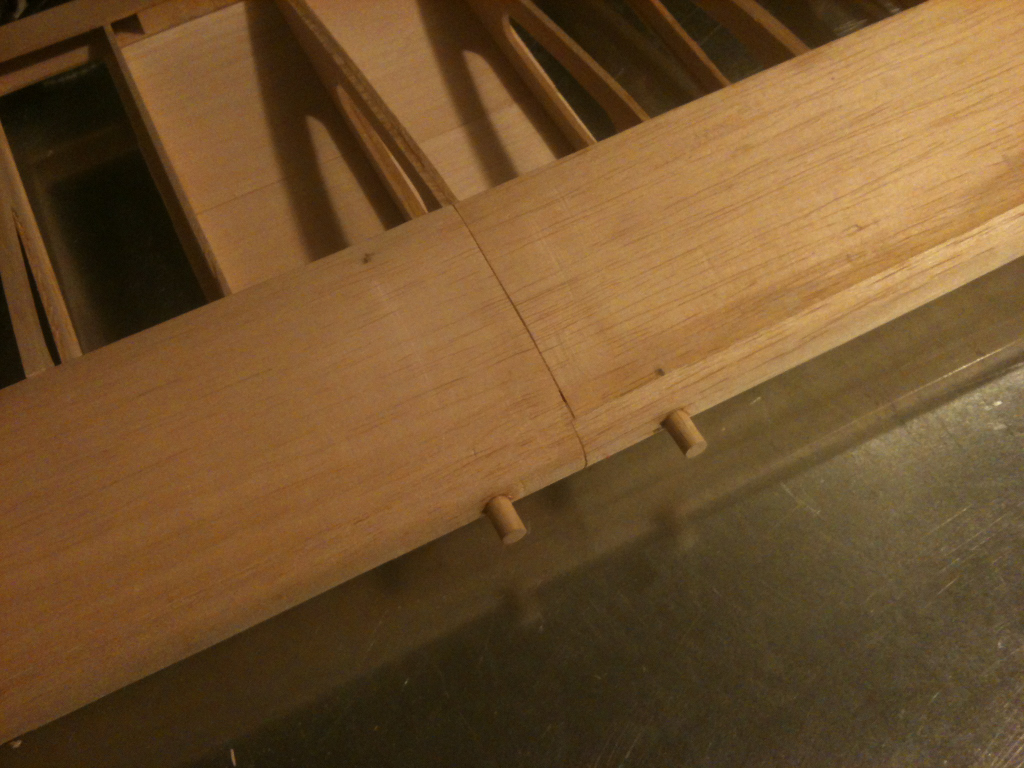

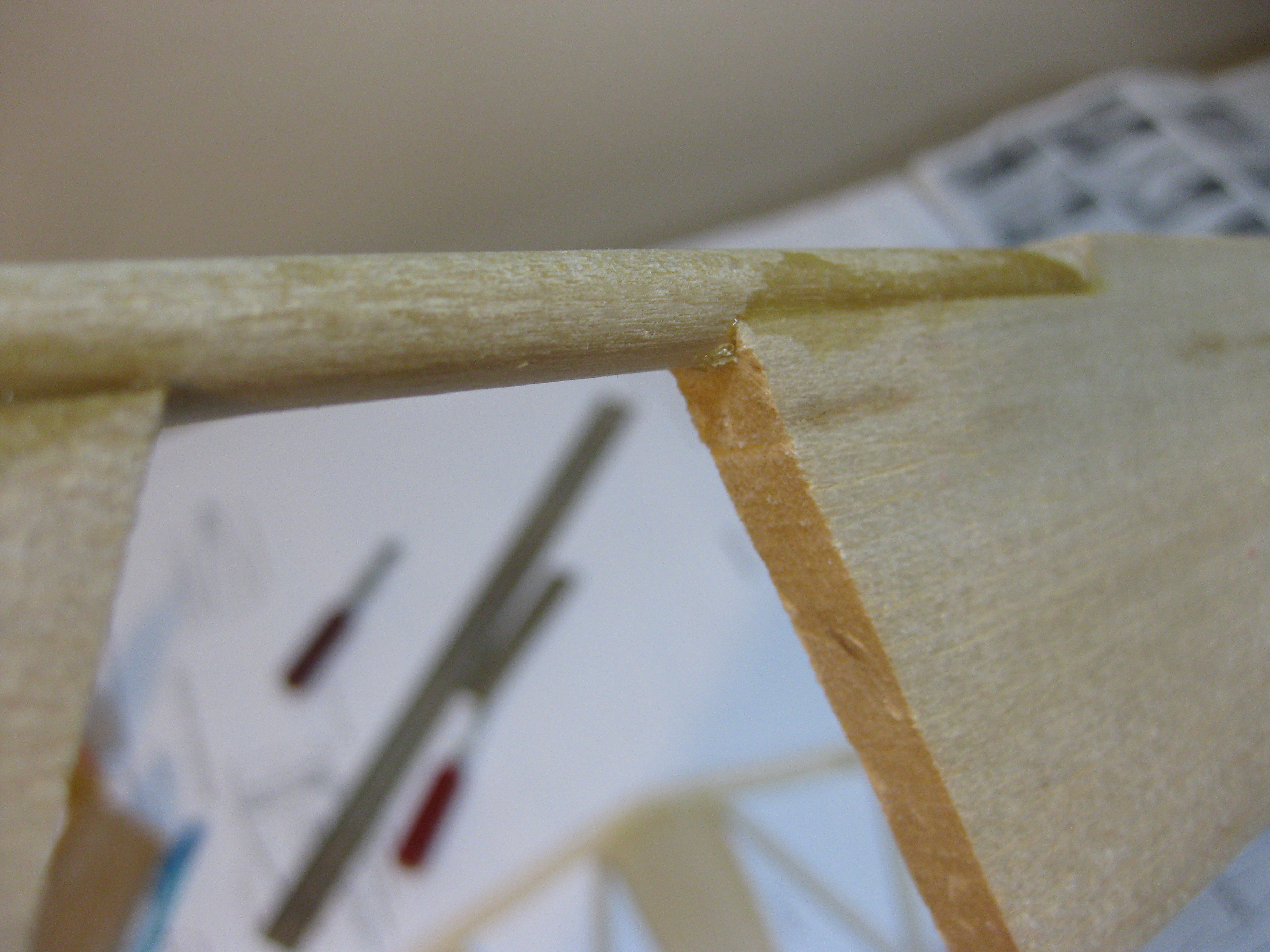

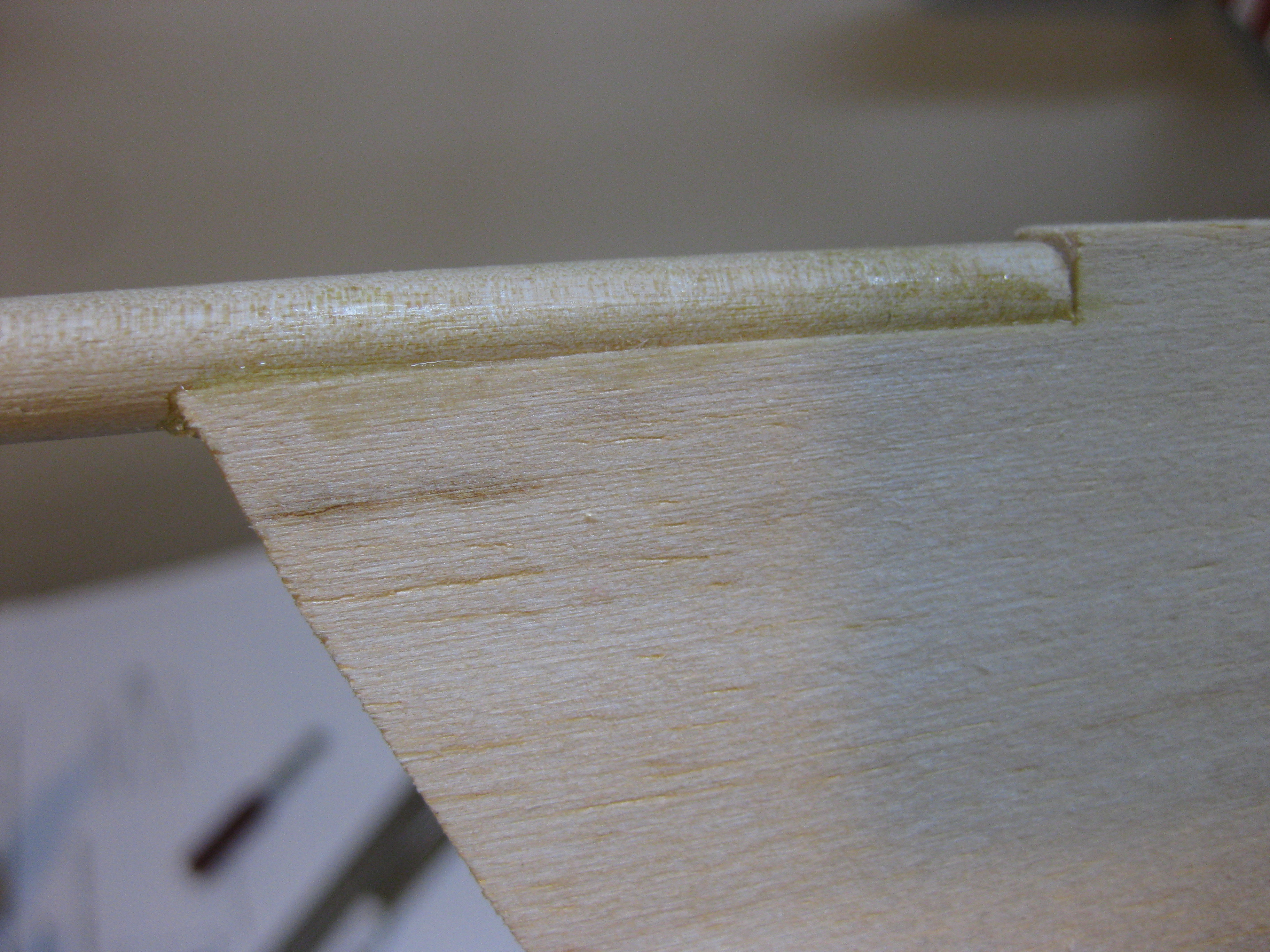

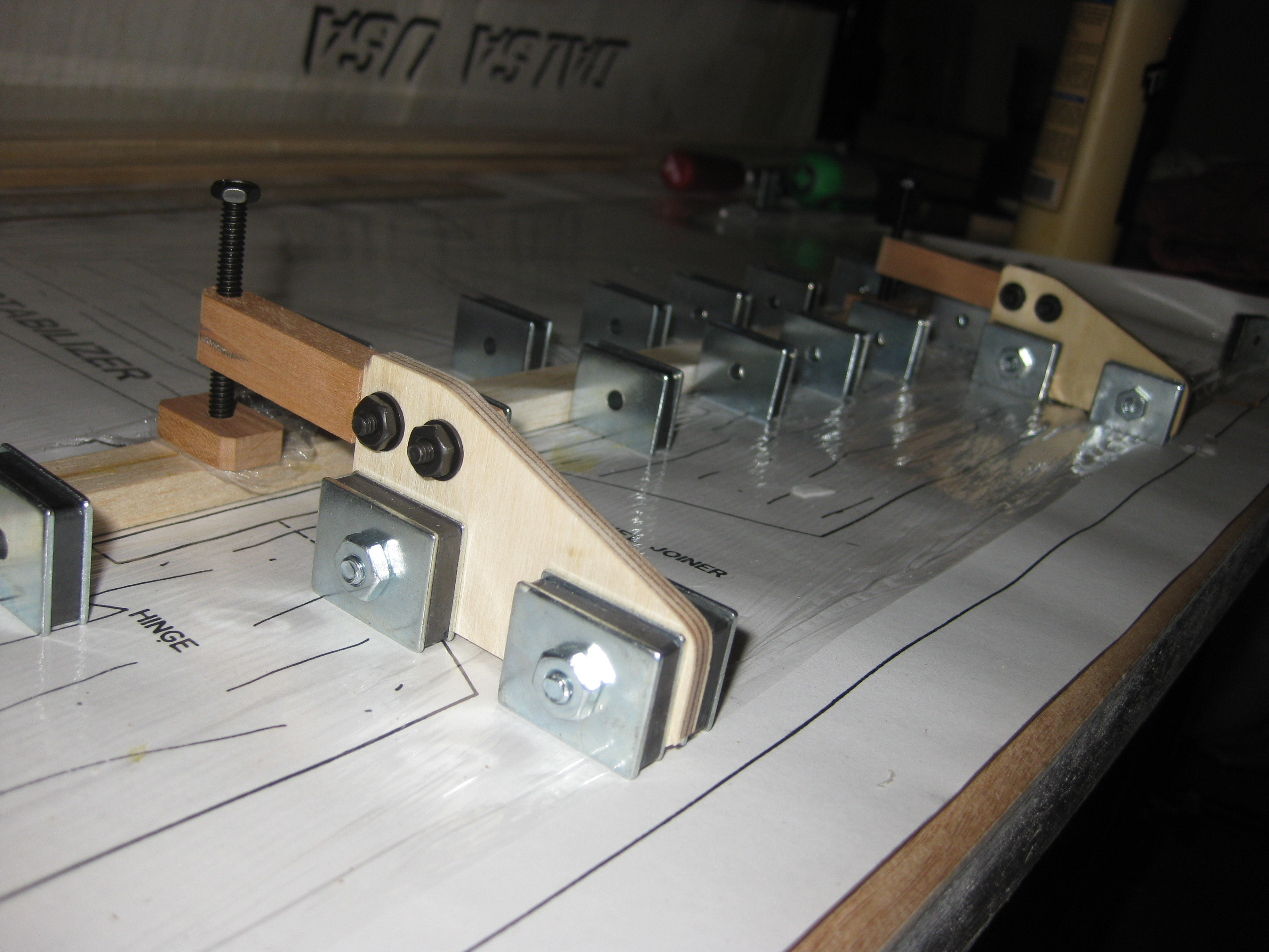

Got the epoxy applied. For the dowel rod, wrapped a round pencil, which was a bit smaller diameter than the dowel, in sanding paper and it sanded a perfect size curve.
Here it is without all the magnets in the way.

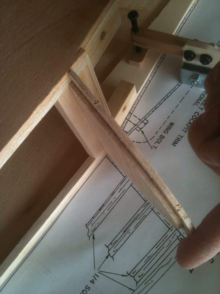

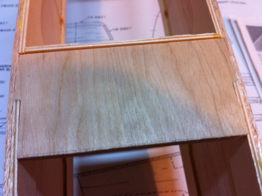

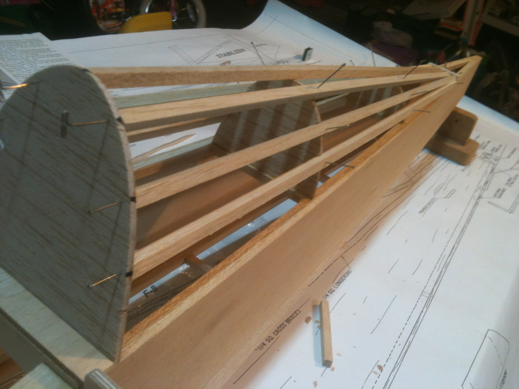

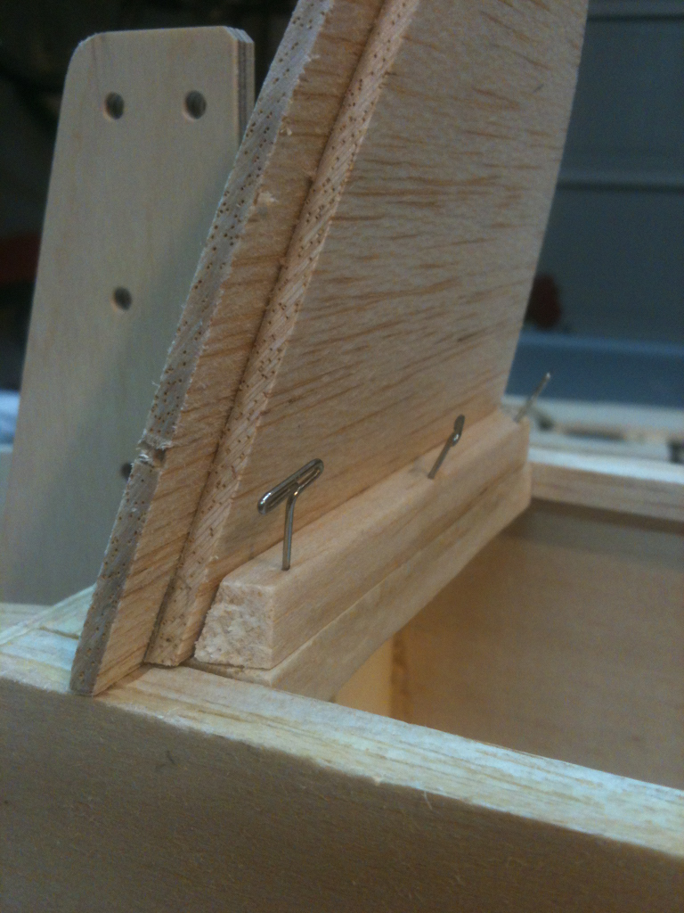

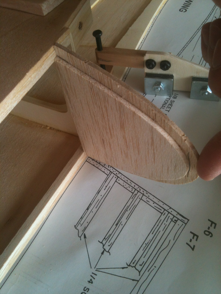

Started on the turtle deck. The instructions called for gluing this like so:
It seemed it would break off easy just being connected on each of those 1/4" balsa sticks so I added a wider balsa block underneath.

This is just a sport plane, not much more than an advanced trainer. If this is how Balsa USA designed it, it'll probably be just fine. Then again, like with the dowel rod, it's kinda twisty.
Old build threads here on RCU stated that the first former of the turtle deck is a weak spot and needs bracing if you use a 1.20 or larger engine. Since I'm not 100% sure of the power source I added extra material.
ID:	1985202   Click image for larger version
ID:	1985203   Click image for larger version
ID:	1985204   Click image for larger version
ID:	1985205   Click image for larger version

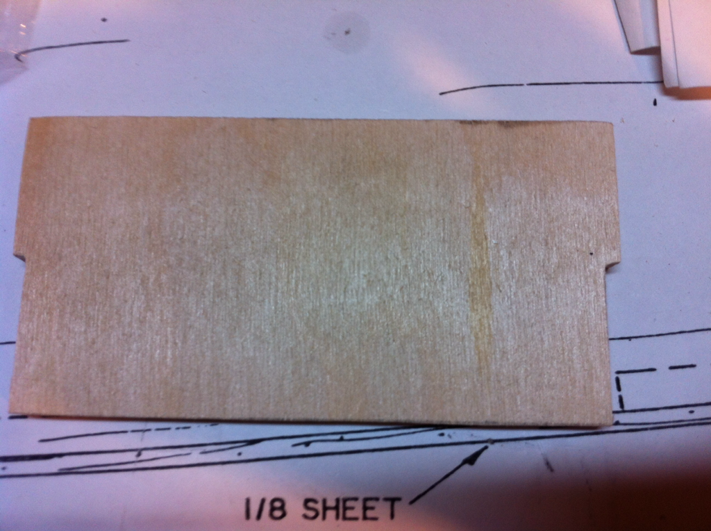

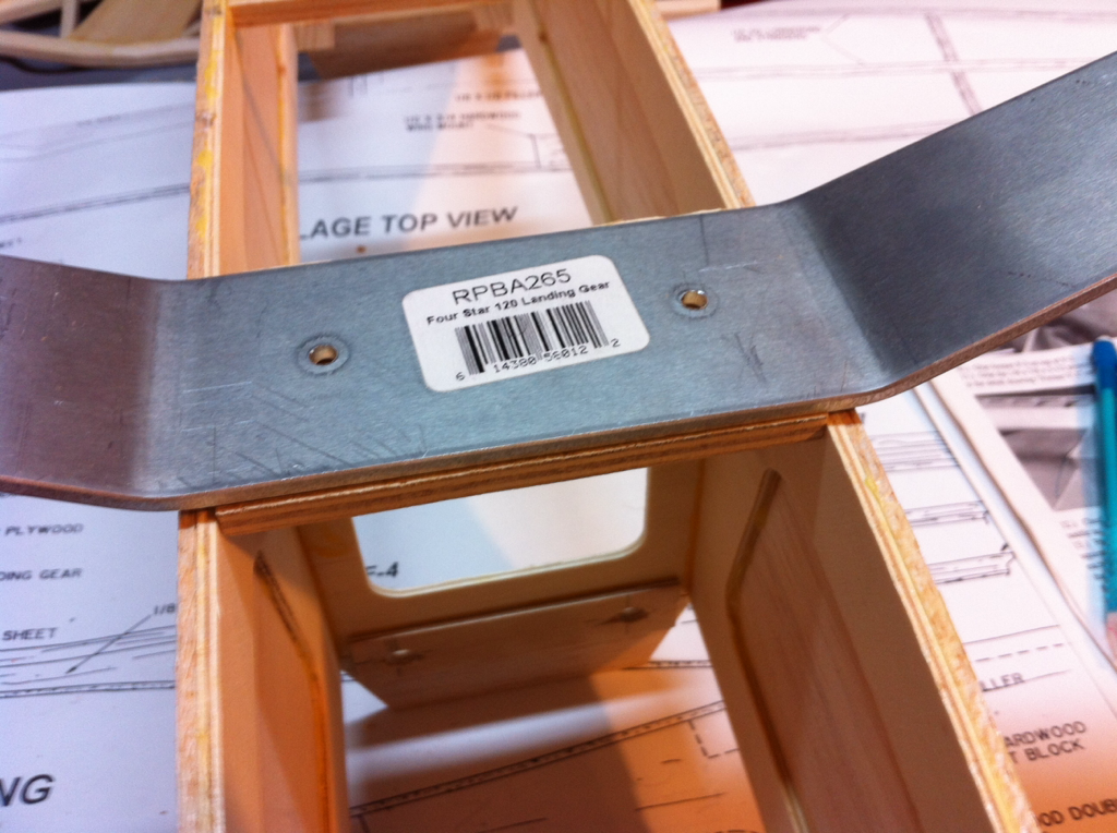

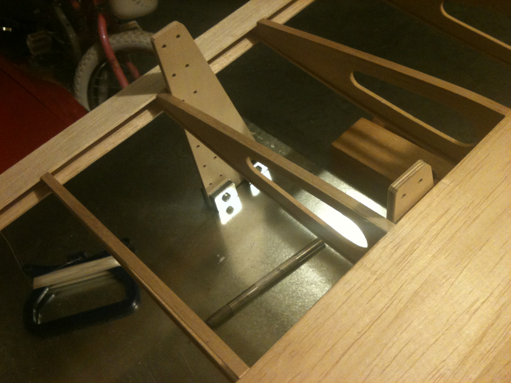

Got the landing gear block in place for the upgraded landing gear I'm going to use. This will look much better than the bent wire gear the kit came with.
I cut 1/4" ply to shape with my scroll saw.
Good fit.
I added some square stock for added strength.
ID:	1985877   Click image for larger version
ID:	1985878   Click image for larger version
ID:	1985879   Click image for larger version
Old 04-12-2014 | 06:01 PM
  #50
Posts: 394
From: Jacksonville, FL
Where did you get the landing gear from?
