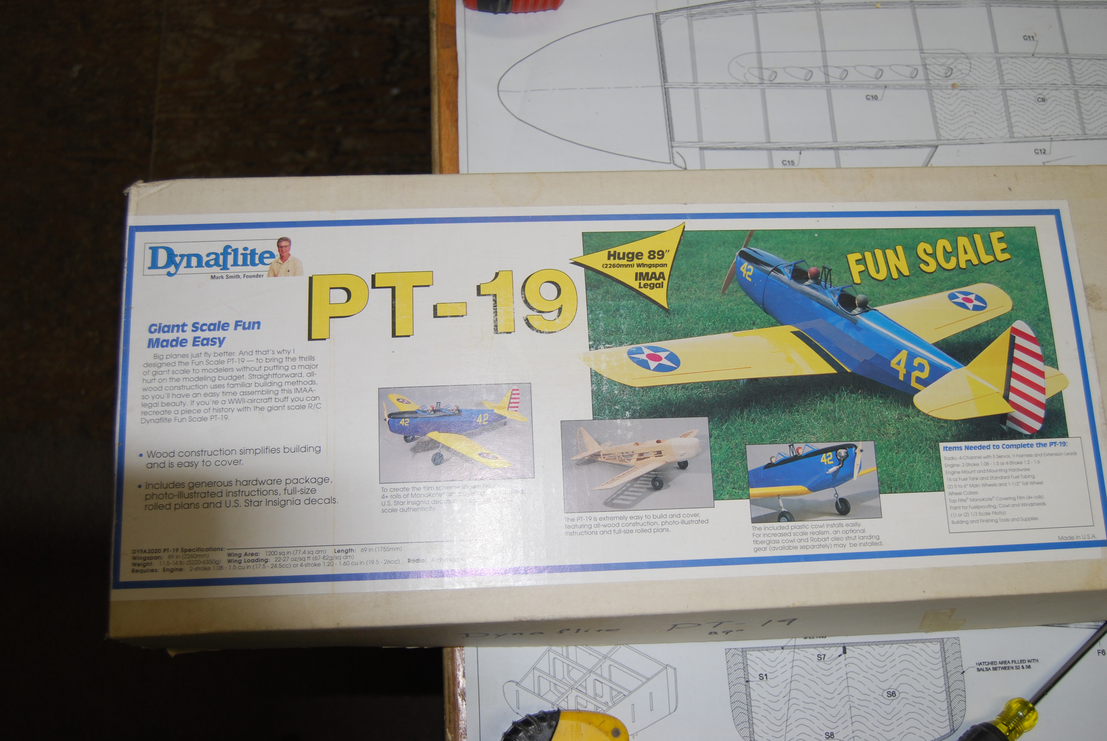

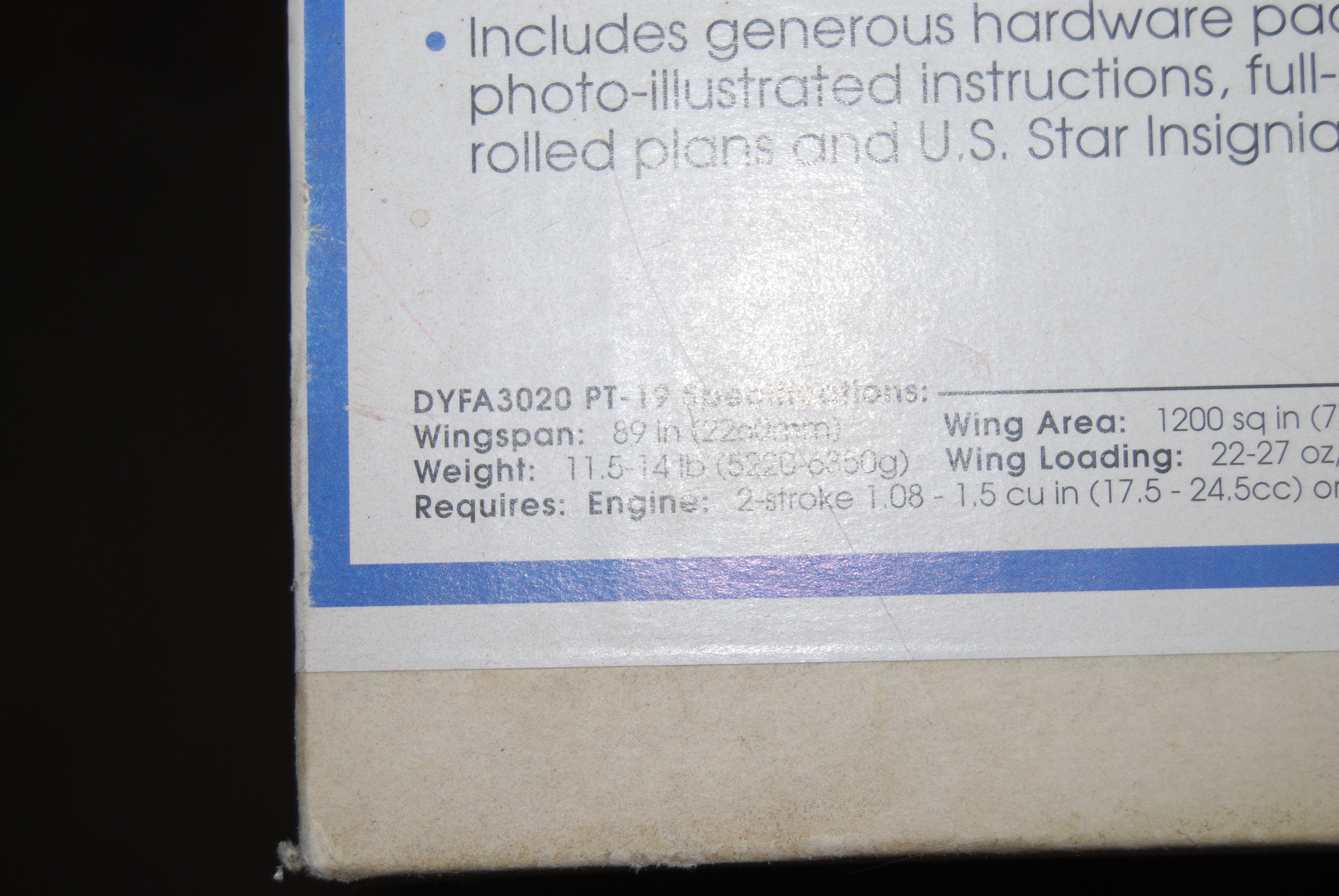

89"

Thanks Luft-Gangster, I knew it was larger than 82" and nobody clips the wings on a scale PT-19 (do they?) so if it has an 82" W.S. it's not a Dynaflite. It's likely a Hanger 9 or Great Planes ARF. Photos of the inside fuselage structure would help to pin it down. I have the Hanger-9 ARF and could compare the photos to mine if the OP is interested. The Dynaflite C/G spec will be wrong for the ARFs. Or the OP could measure the wing cord of the root rib, measure the wing cord of the outermost rib (ignore the wing tip), average the two measurements (add together and divide by two), (this is the Mean Aerodynamic Cord) and then use 25 to 33 percent of that number for the C/G range. Start flying at 25% of the MAC and adjust as needed..

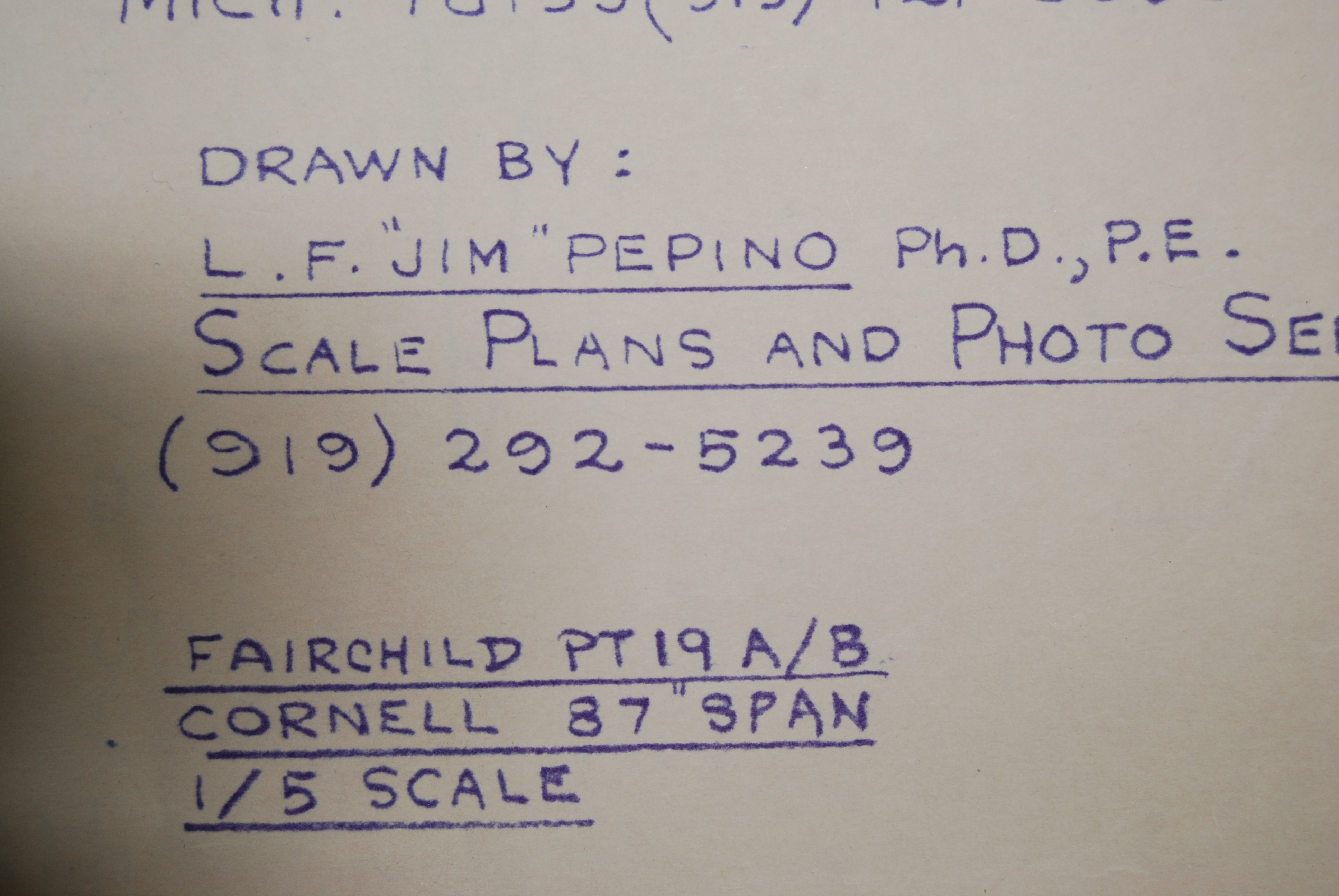

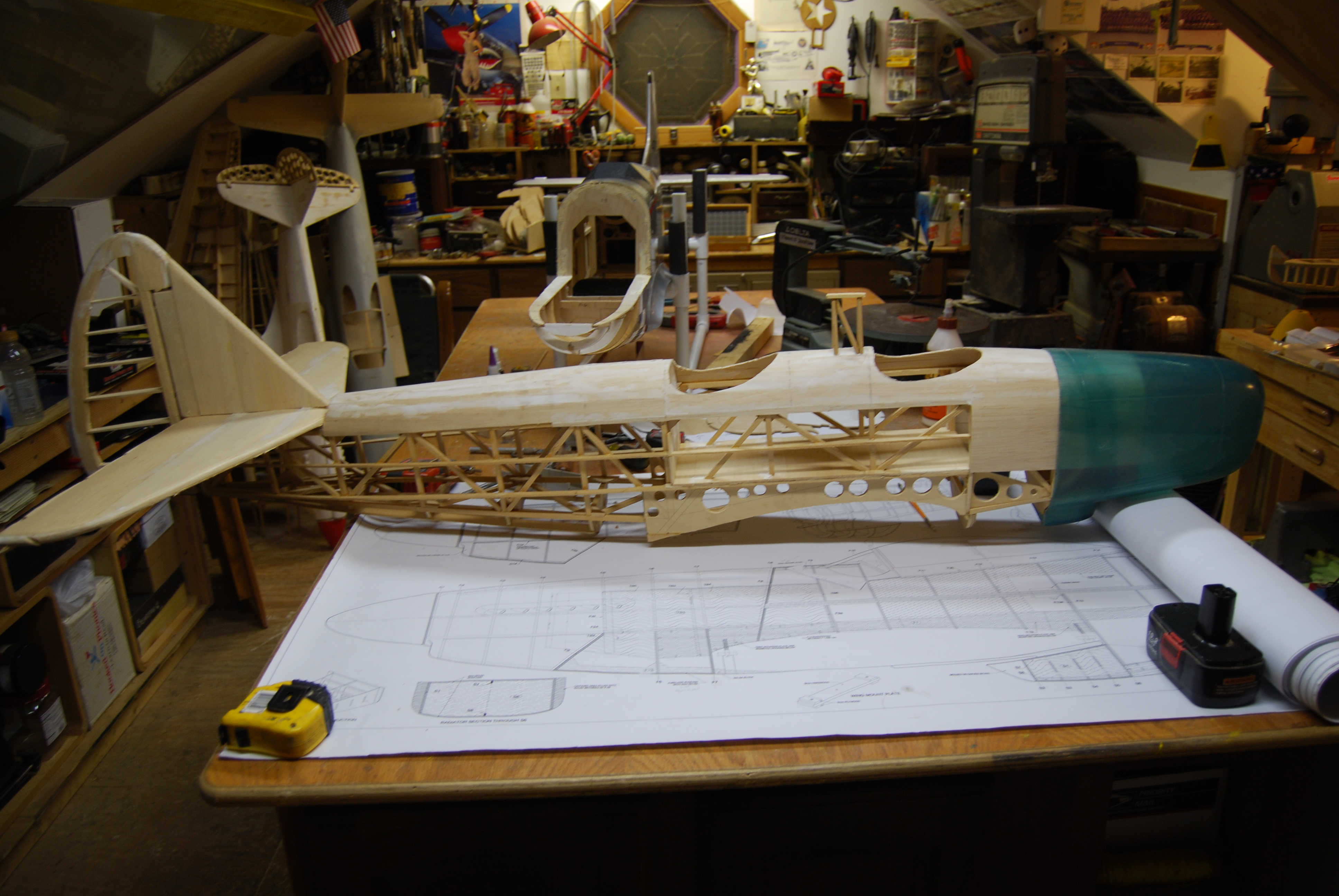

I am currently scratch building a Jim Pepino PT-19 at 87" among several others.
