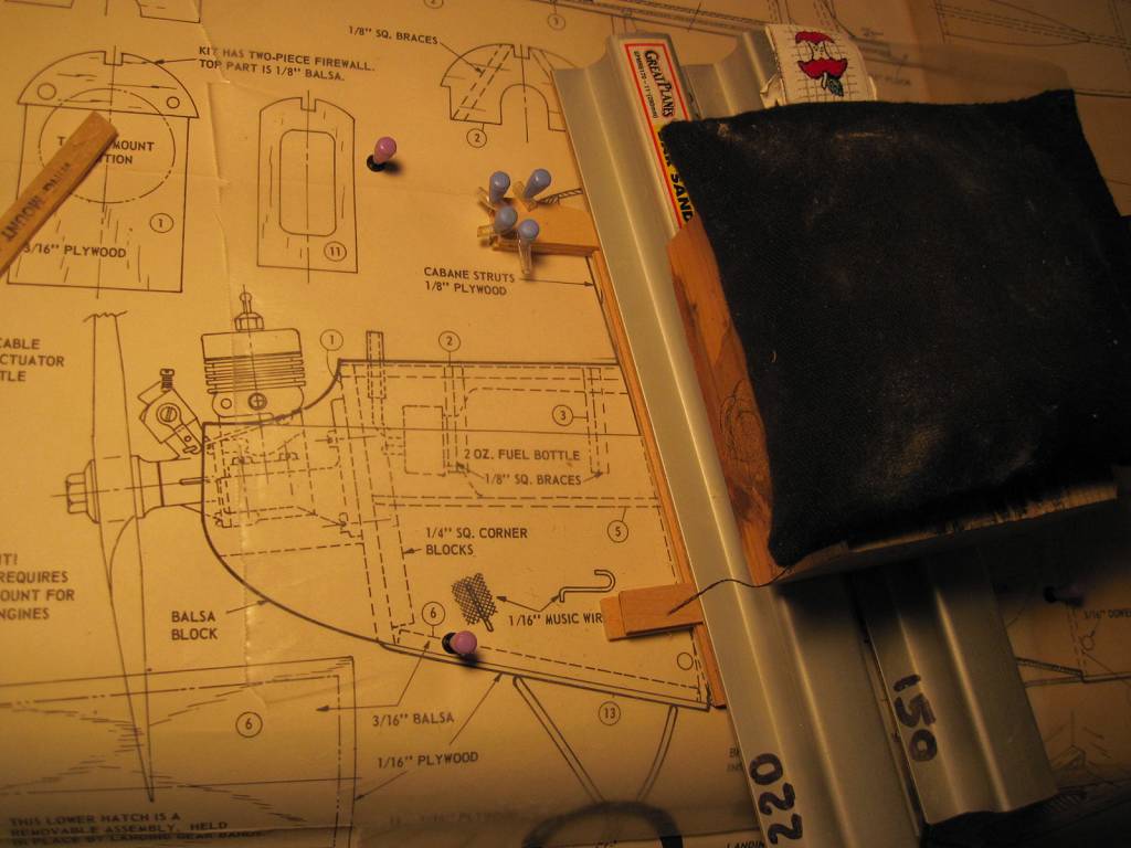

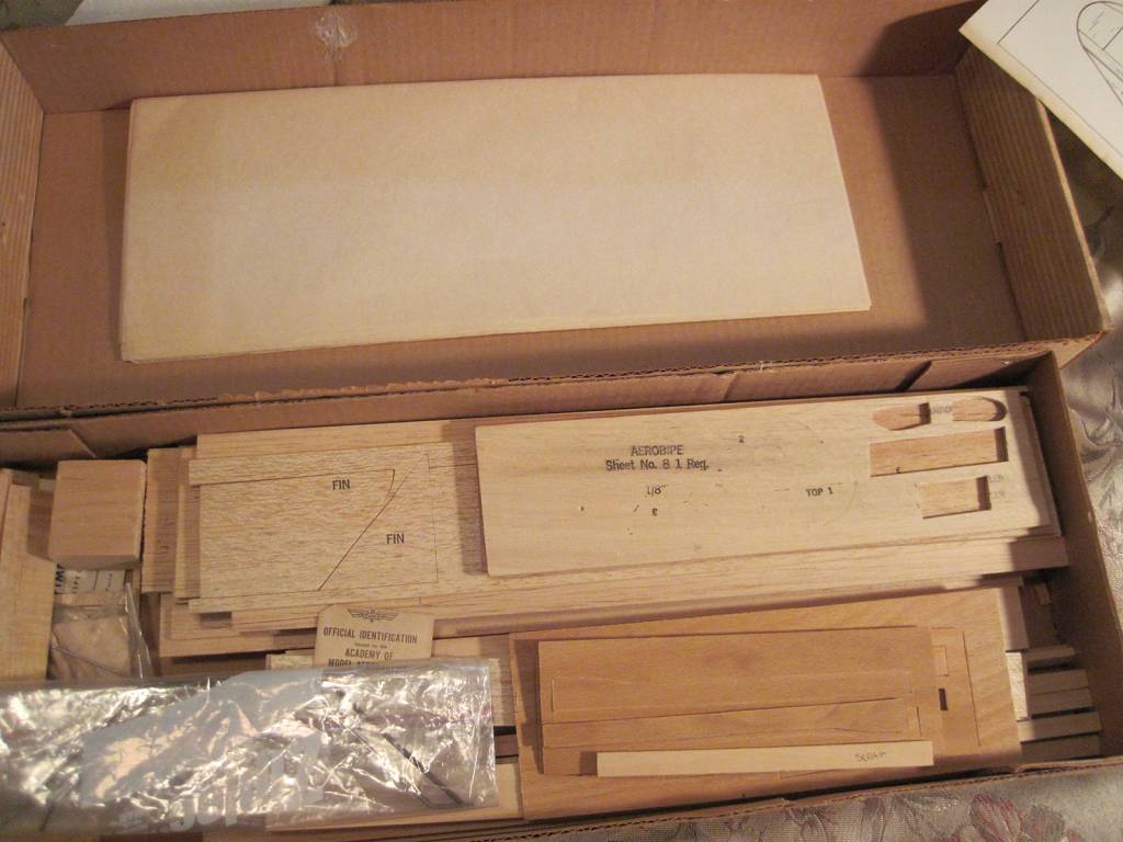

Here's one you won't see every day, a SIG Aerobipe. Apparently produced in the 70's. In fact, in searching the internet I can hardly find anything at all about this kit. Apparently it is related to SIG's "The Baron's Buggy". It is a 34" wingspan 3-channel biplane for 1/2A power. I picked this kit up on Ebay and thought it'd be an interesting build and something no one else at the field will have. I'm going to build it pretty much stock except for some minor changes, such as the landing gear mounting (changed from the rubber band mounting to a bolt-on arrangement).
Even though it says a .10 size engine will work, I'm going to put in a Fox .15 RC engine just so I know it'll take off on the grass field we use.
Enjoy the build log and if ANYONEhas ever built one of these or seen one in person, I'd be interested in knowing about it!

Since you built this, do you remember how you did the interplane struts? The instructions don't even mention them, they're not on the plans but they ARE in the photos!!
Mark

Well I'll be darned......isn't that adorable! I've never seen one but you can tell from the plans she's from Sig. Have to admit I'm stunned by the amount of downthrust on that engine. Must be at least 5 degrees. I think you've made a good choice with the .15 engine. Having never built one I can't offer any help but perhaps that fellow who built one in an afternoon can give you some insight on the struts. It takes me longer than that just to flatten out the plans!
Thanks for starting the thread.....keep us posted. And good luck with the Galloping Ghost installation : )

didn't do them as they were not required for flight.if I remember there were small tubes epoxied to the ribs that wire on the ends of the struts plugged into.I used an os max 15 back then .do not try to add airlerons as it won't turn with them.found out the hard way.while it will bank and roll will not turn without using rudder.
Thanks, Aerowoof. I'll try to come up with something regarding the interplane struts. Maybe a scaled down version of what's used on a Goldberg Ultimate or SIG Liberty Sport.
Good to know about the ailerons. I pondered them for a while, and then figured I'd have to take the dihedral out...and then wondered how much to leave in...decided I didn't feel like redesigning the plane. So stock it'll be!
Thanks again,
Mark
