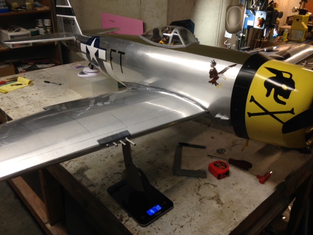

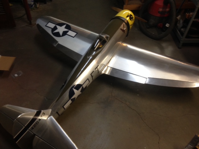

It's the best film covering I've ever used. Far better than monokote. I used the "bright silver" on my P-47 and get compliments on the "real aluminum" finish all the time.
