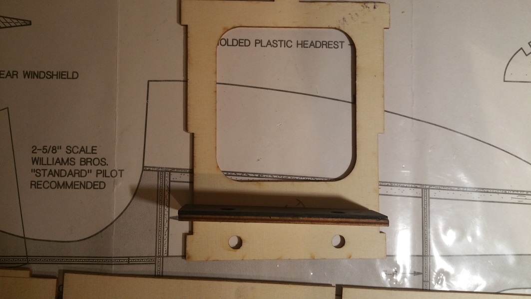

2) I am planning on carving the headset from Balsa rather than using the plastic. I just don't like that plastic.

OK. so here are a few pics I took yesterday. This is not much, but at least I started to take some pics. I'll take more tomorrow and share what I have once the glue is dry (and I got off from work!).

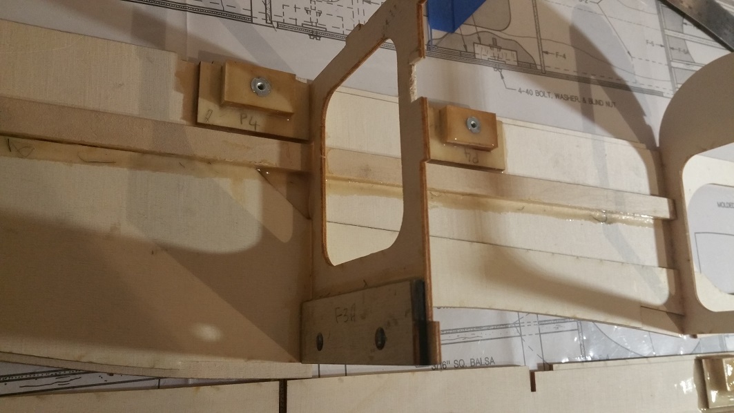

Here are some of the pics I took yesterday as I was progressing on the fuse.
I will explain what is happening inside the fuse.
Since I'm electrifying and need to find te correct CG I've decided to use as much of the fuse to mount the batteries on, as I can. Therefore, I epoxied a piece of 1/2"x 1/4" basswood on each side. This will act as the "rail-hanger" for the actual battery mount I'll be creating. Since the battery-hatch will be in the bottom -front (just before the landing gear) - I decided to let the batteries hang, rather than "Sit" on the battery-tray. If you look carefully, you can see the basswood "rails" in these pictures.
If you look carefully, you will see tha 1/8" gap between the "rail" and the bottom of the cabane mounts, - this is where I'll place the actual battery-tray.
In the second picture, you can see the result form the CF-enforced wing mount (or whatever it's called.

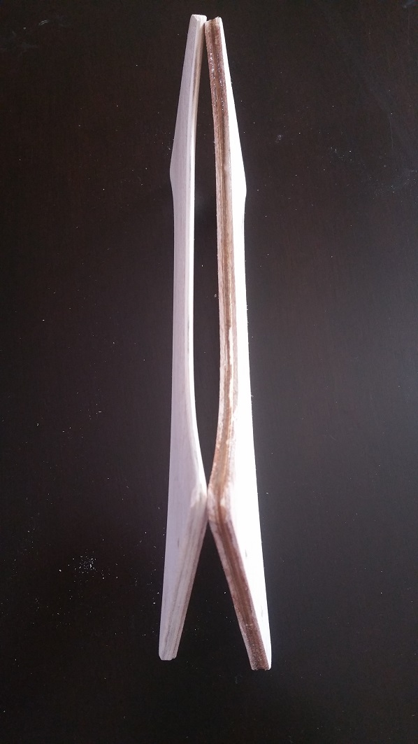

Yesterday, I also started gluing the two sides of the fuse, together. Here you can see my fire-box and a DVD case, weighing it down a little. I must say, I think the result came out pretty well.

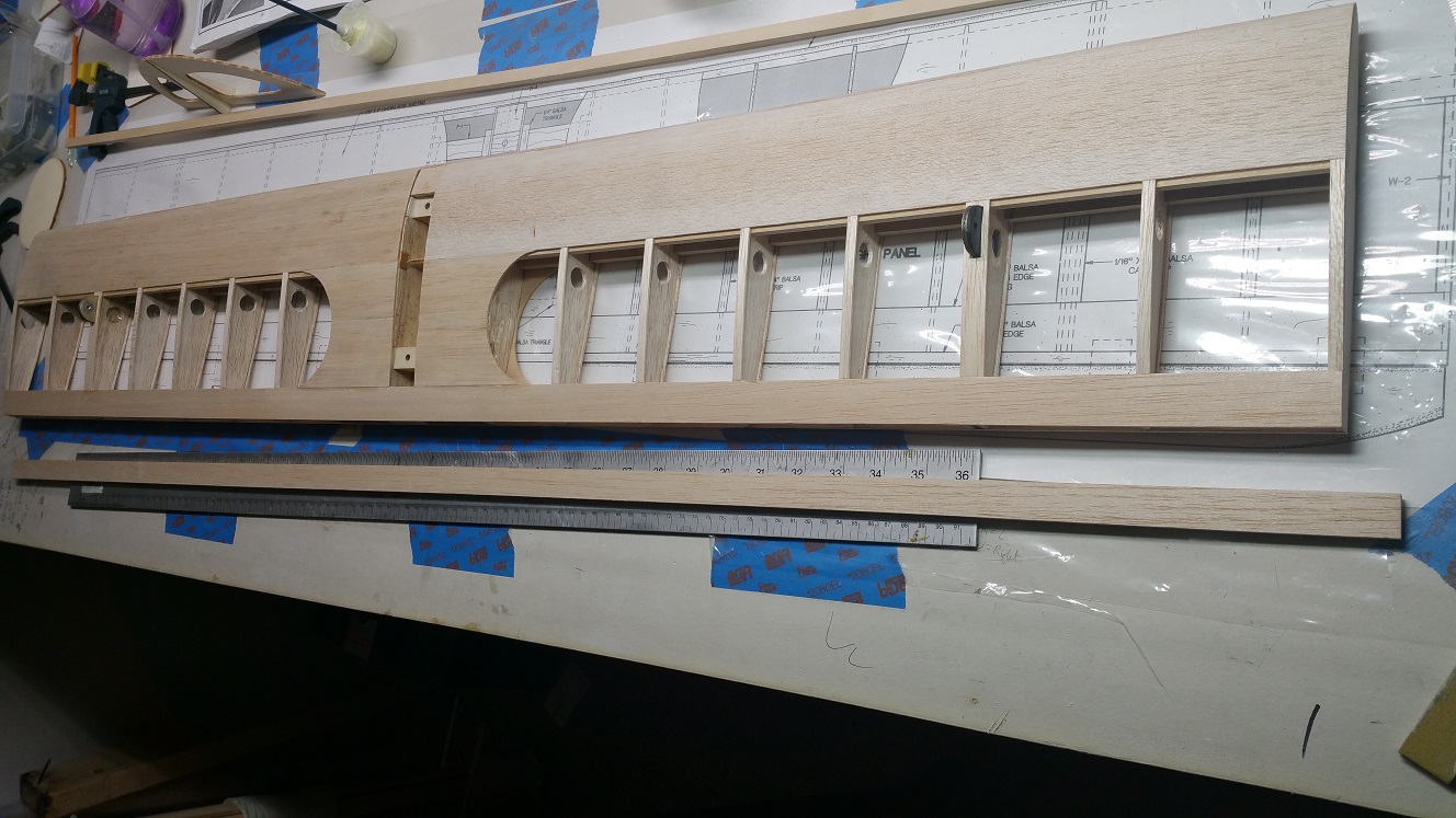

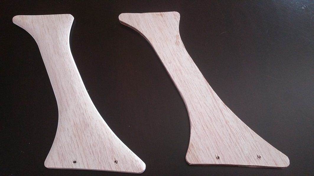

While I was doing the long process of getting the fuse into shape, I started with the wing-struts, this morning.
I used the supplied struts (which is actully 3/32"!!!) and epoxied a 1/6" balsa on each side.
Here you can see (on the left) the one that I started sanding, to give it some airfoil.

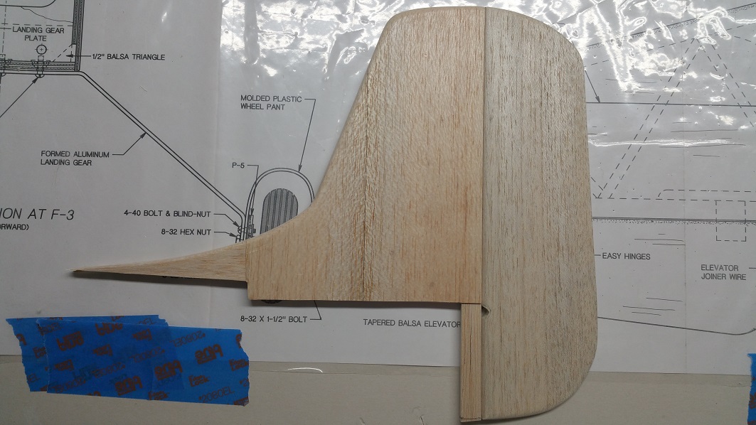

I got a few things done this past weekend. I finished most of the back feathers (stab, fin and rudder). I decided, since the stabilizer is 3/8" thick and the fin/rudder only 1/4", to add 1/6" balsa on both sides of the rudder. This mean I had to order another piece for the rudder (that is not 1/4" but 3/8"). Here is the result from my attempt. It may add a little weight, but I cannot see why the stab and rudder two were not the same thickness from the start.
All I have to do is add the hinges and the tail-wheel hook (if I am going to do that and not let the wheel turn freely - have not decided what to do here, yet). I am still working on the elevators, to get them equal size and shape.

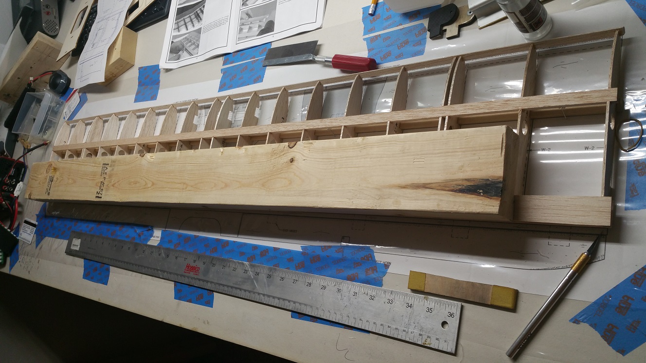

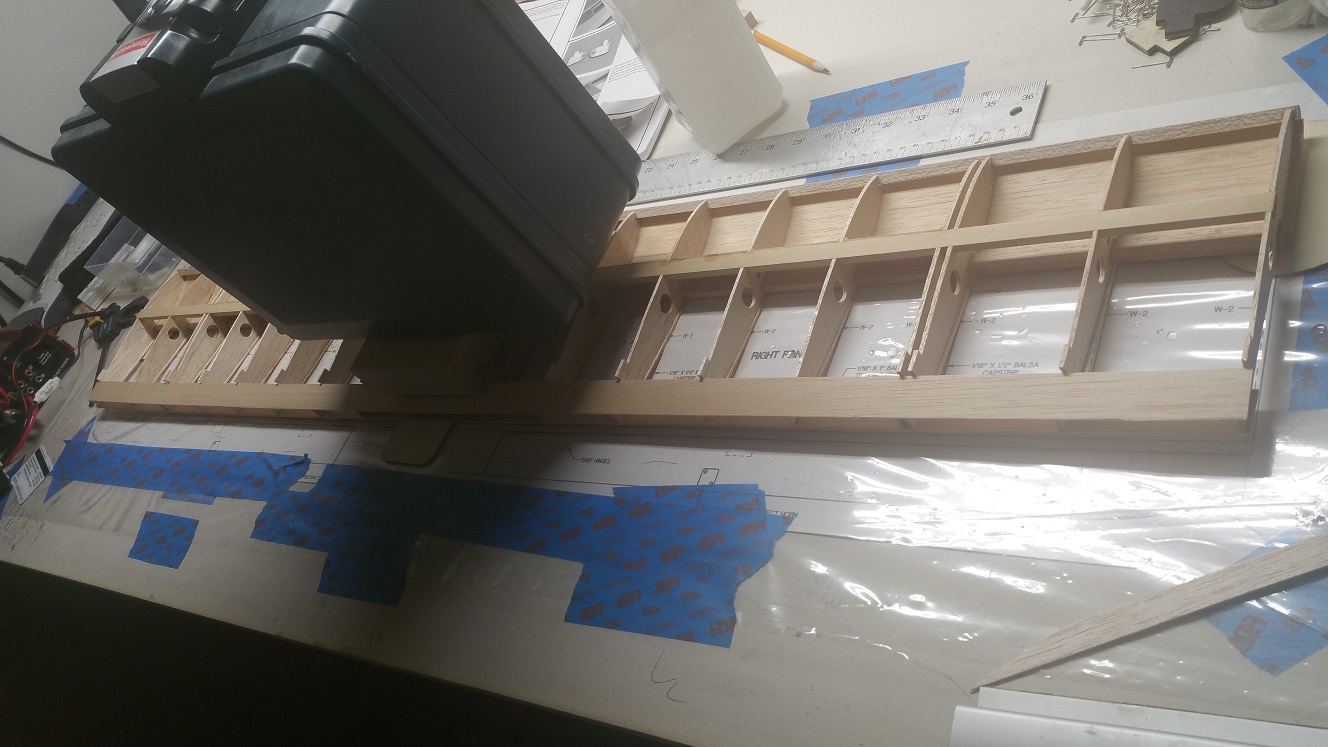

In the mean time, I have also started the top wing. This is the progress of that:

Below you can see the progress of the top wing. The first pic was to hold it down before gluing the top sheeting in place and the second on was after the top sheeting was in place, I discovered a little upward twist at both tips - which I am trying to straighten out (second picture) with some weight. It's not a lot, (about 1/6") and it all happen after the top sheeting was glued in place. I recall although the edge of the sheet was straight, it had a weird twist in the sheet. So I soaked the whole wing with spayed on water and let it dry. Hopefully it will cure. The last resort to fix this, will be when I place the bottom sheeting on the make sure everything is straight. But it still is strange, since my work board is totally flat!
More to come as I progress with the top wing.
Instead of using the supplied two 1/4"x1/2"x24" balsa sticks for the bottom spar, I used a 48" basswood piece from my own supply. I just think it would be stronger for the needed support and do not think the weight difference will be that much, compared to the added strength. As you can see in the font of the above picture (and below), I also strengthen the P2 mounts with a equivalent cut-out piece of Carbon Fiber.
