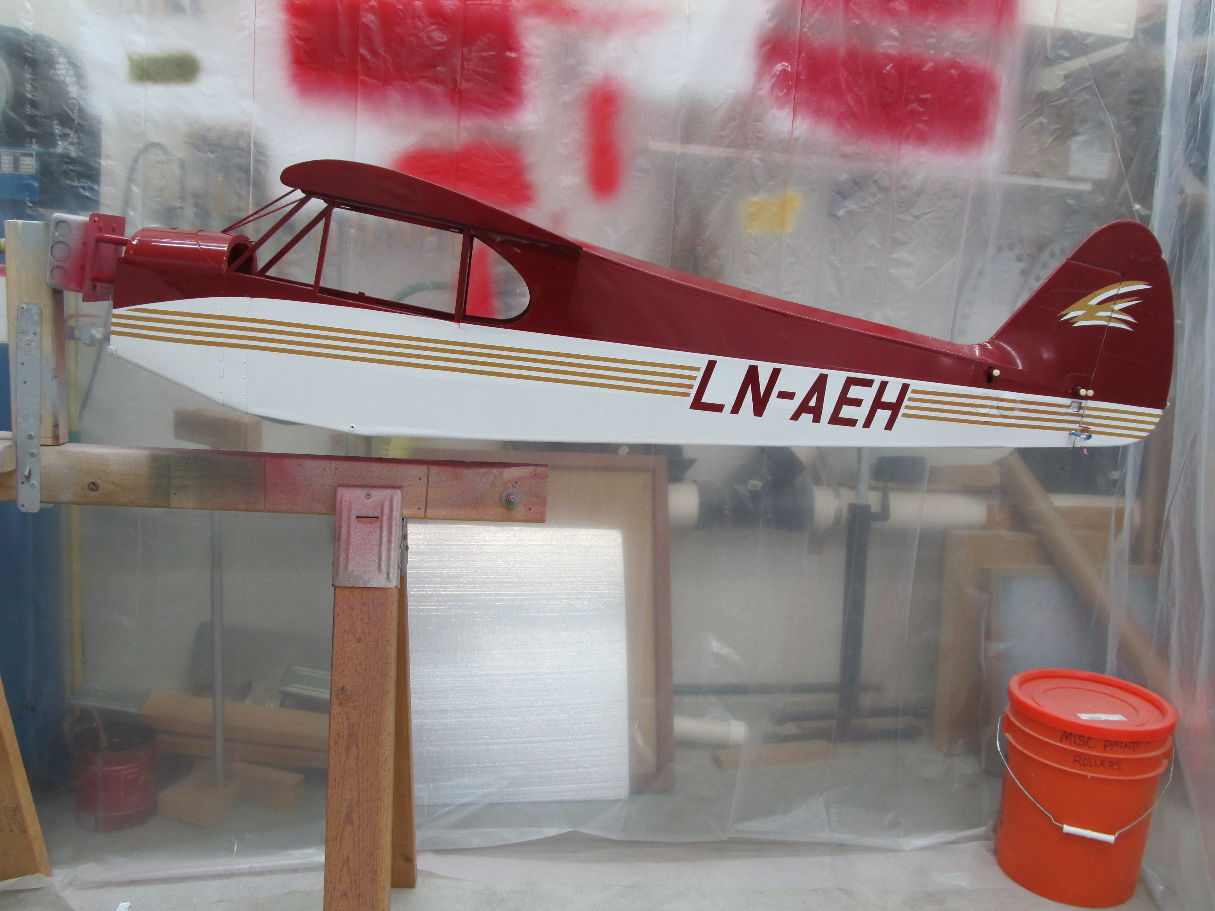

I use automotive paints on all my planes and they are covered with Natural Solartex, it takes a nice paint job and you can't see through it.

It's PPG's Omni base coat/clear coat on the cub, Spacewalker has Sherwin Williams 4th Dimension base/clear coat, both over natural non primed Solartex. All exposed wood is sealed, sanded and sealed again with nitrate dope, no need to primer it.
All aluminum is sanded and primed with self etching primer, fiberglass is primed with hi build Dupli-Color primer sanded and painted. There is a lot of paints and primers out there, one needs to know the compatibility of all the products he's going to use, Google Compatible paint charts and then do some tests. Knowledge will make you a good painter, without it you'll become a mess maker.
Leroy

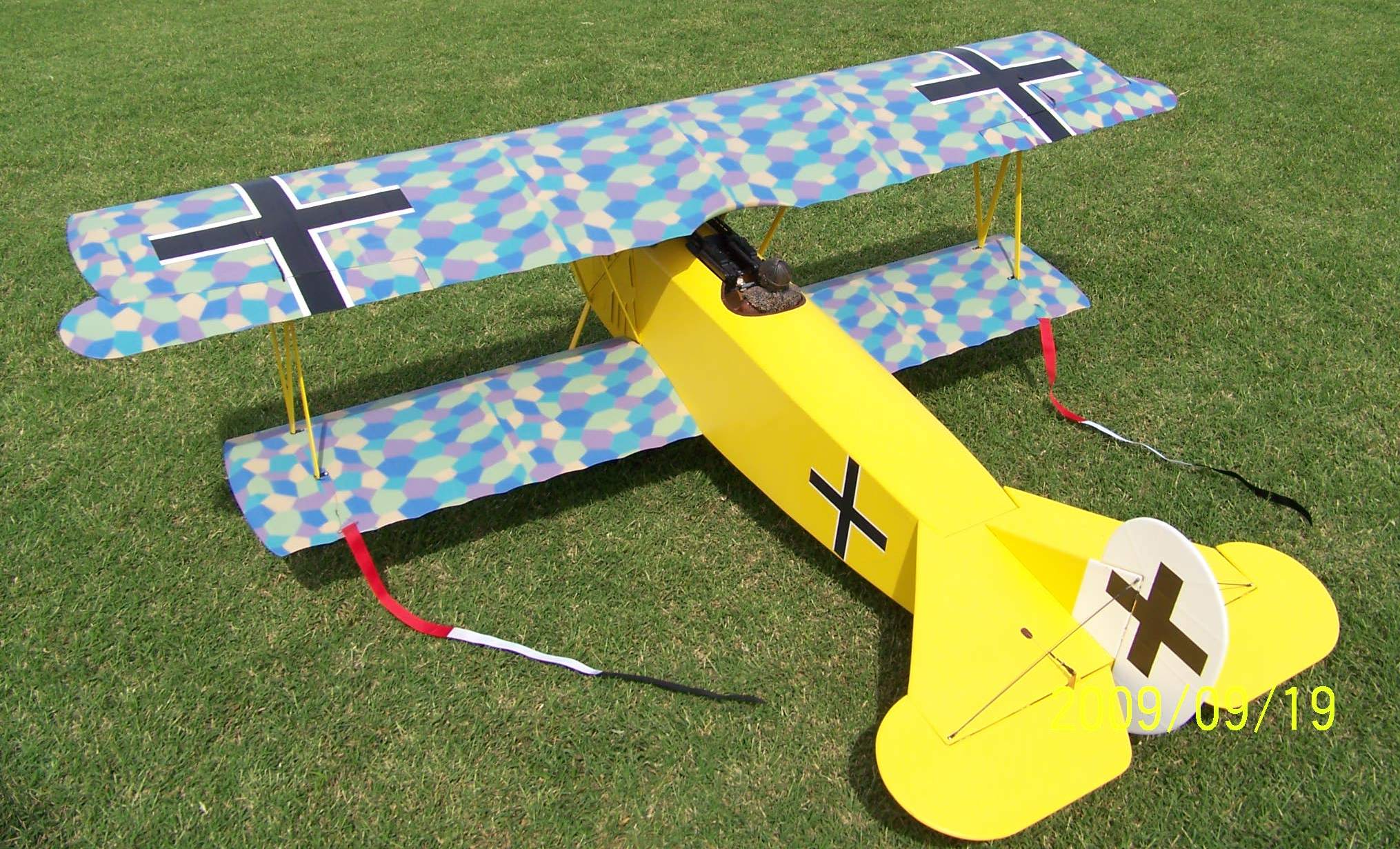

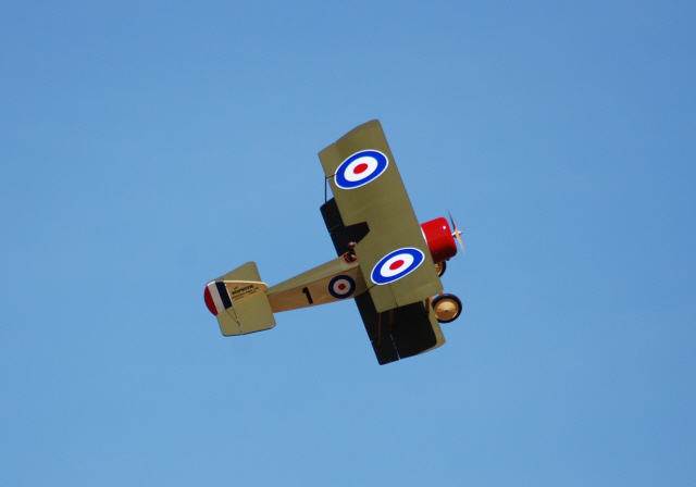

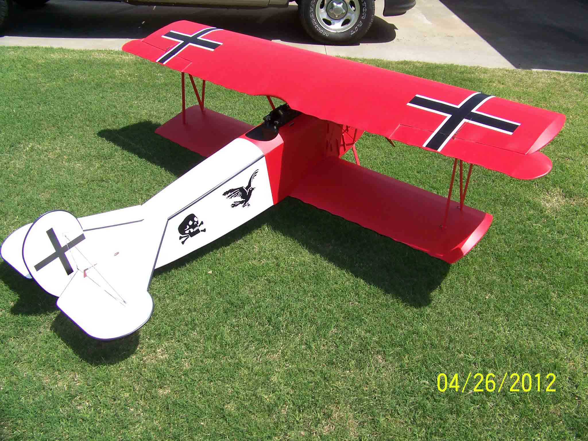

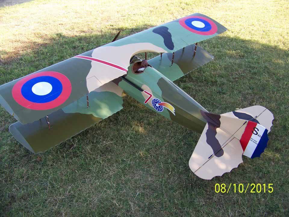

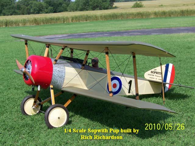

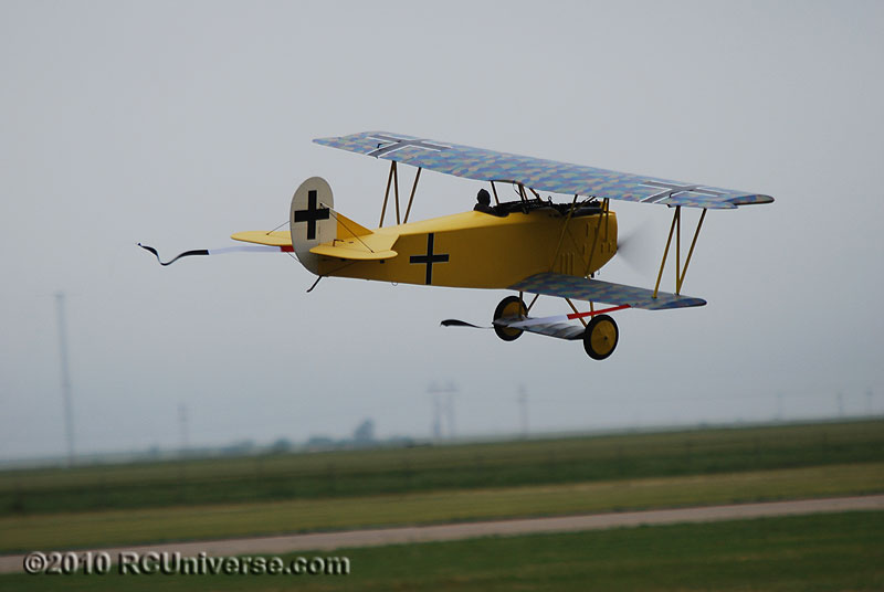

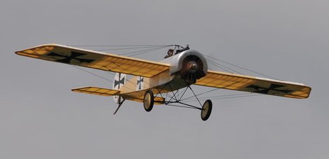

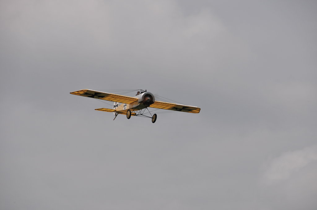

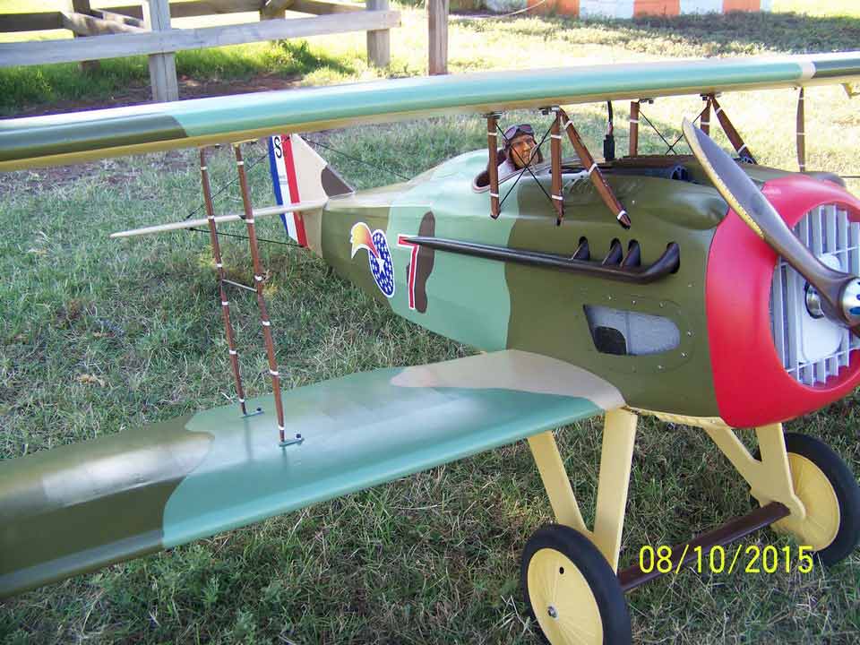

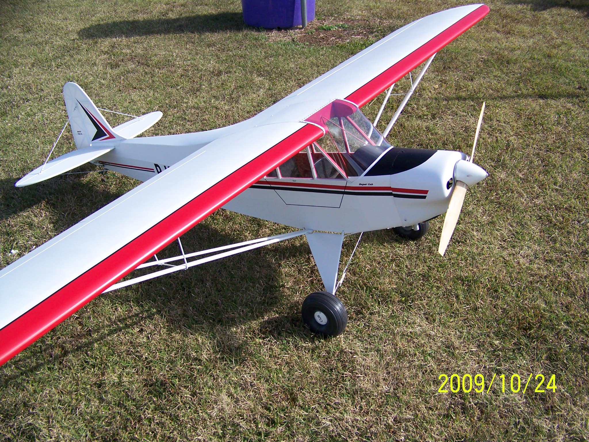

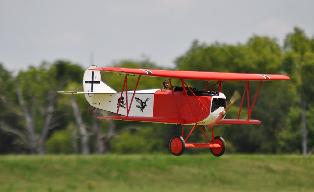

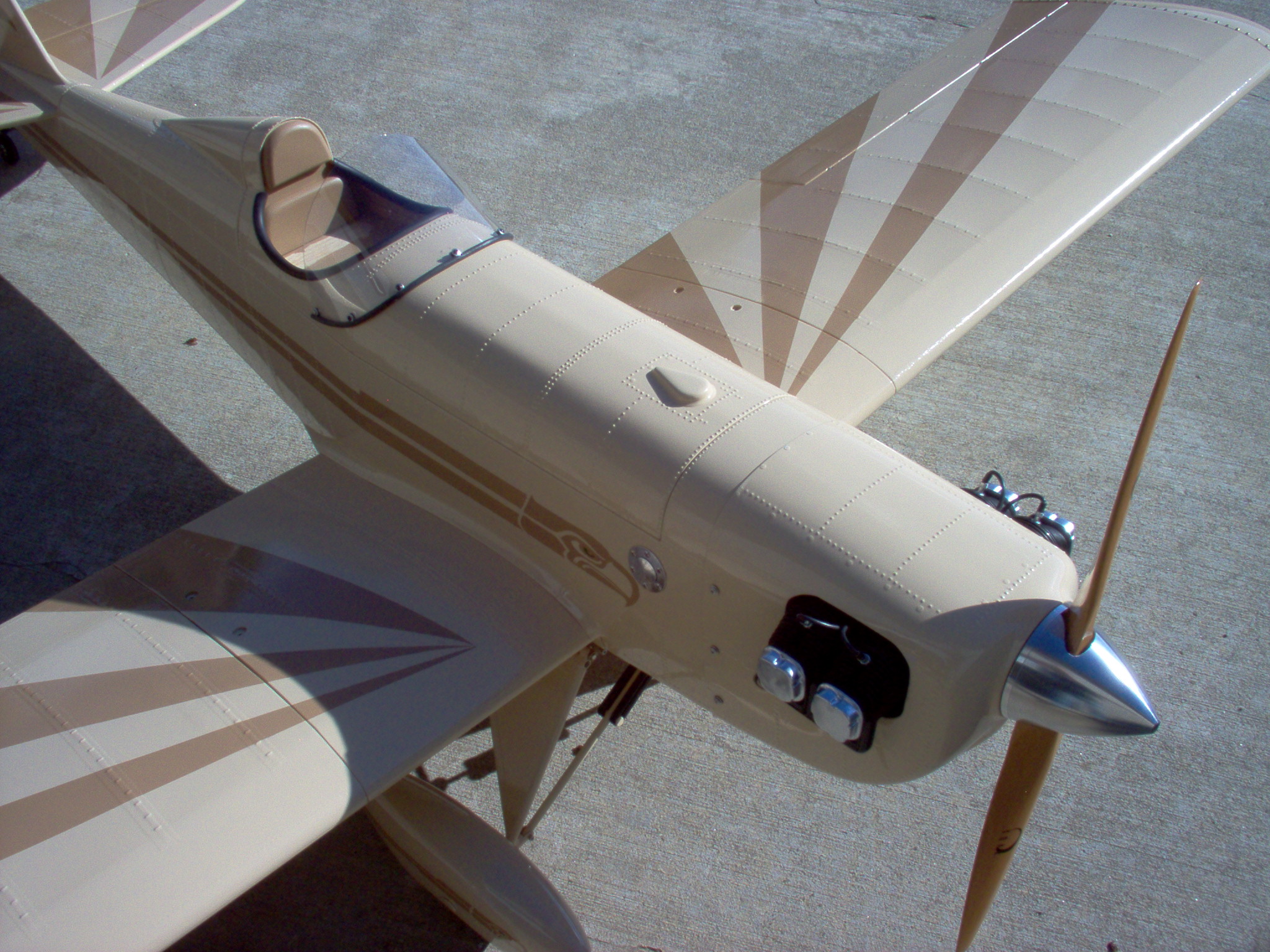

I have found that Latex paint from Lowes or Home Depot works very well and price is great. I buy the small tin of sample paint for about 3 or 4 dollars. They can match any color you want, just take a sample of want you want the match. I have used the painted and the unpainted Solartex, and matched the unpainted parts as well. I have built several Balsa USA kits and have used the painted and I have painted others. The latex paint can be sprayed on or brushed and sealed the clear Minwax Polyclic water based. I have planes that or over 6 years old that still looks great, also you can weather paint as well. Here are so examples of my planes covered with Solartex.
Colored Solartex unpainted parts; (cowl) painted with latex:
All of these are painted Latex
I hope this helps
Fair Winds & Happy Flyin'
Rich
