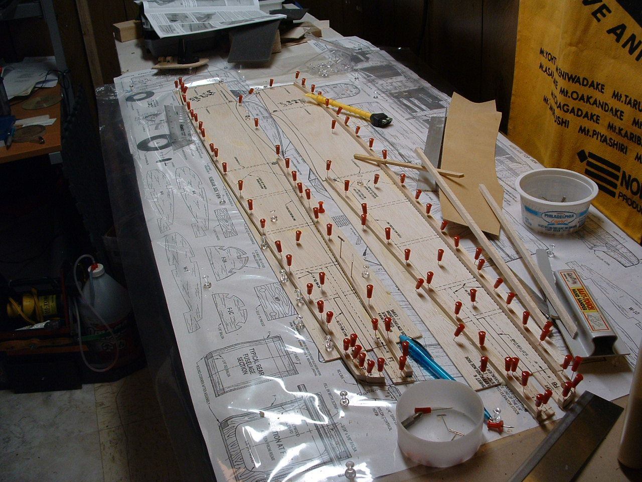

Good evening as you can tell i made little progress today as I got both the top and each side of the wing sheet and installed all of the cap strips and I also glued on the leading edge of both sides of the wing! Now I have to go pull all of those T-pins and the midewest push pins out and start shaping the leading edge!

I can't speak highly enough about the Kavalier...I've had 3 since the mid 80's. Build the airframe stock, especially the wing...make sure the ribs are firmly pinned to the building board and sheet half the wing while pinned. This insures a nice stiff structure that keeps the built in washout intact. To convert it to a taildragger I ran a brass tube from the top of the fuselage to the bottom through a piece of 3/16" (top and bottom) ply for a wire tail guide. Slide piano wire through the tube and make bends that allow for a steerable T/W. The main gear is moved forward so the main wheels split the leading edge in half when looking straight down on the gear. It has 0 bad habits and make flying off of grass a breeze. The airplane really has no bad habits, is fully aerobatic and handles great through all speed ranges. I have an OS 40 on my current Kav and it is plenty of power.

Where did you get those red push pins? I like those! The wing is coming along very nice. Sanding is one of the necessary drudge jobs I don't enjoy but a must for a good surface.

Hi Mike, I bought package of those pins from Eddie over here at action Hobbies and I liked them so much I ordered another box from Tower Hobbies. They are made by midwest products and they cost about $3.50 for a box of 50. check out this link to Tower Hobbies: https://www.towerhobbies.com/cgi-bin...&P=SM&I=LXRRG8 it seems they are not available yet.

Tower has stuff coming in at a trickle I'm sure they will be back soon.

I bought my Midwest pins from Hobby Lobby

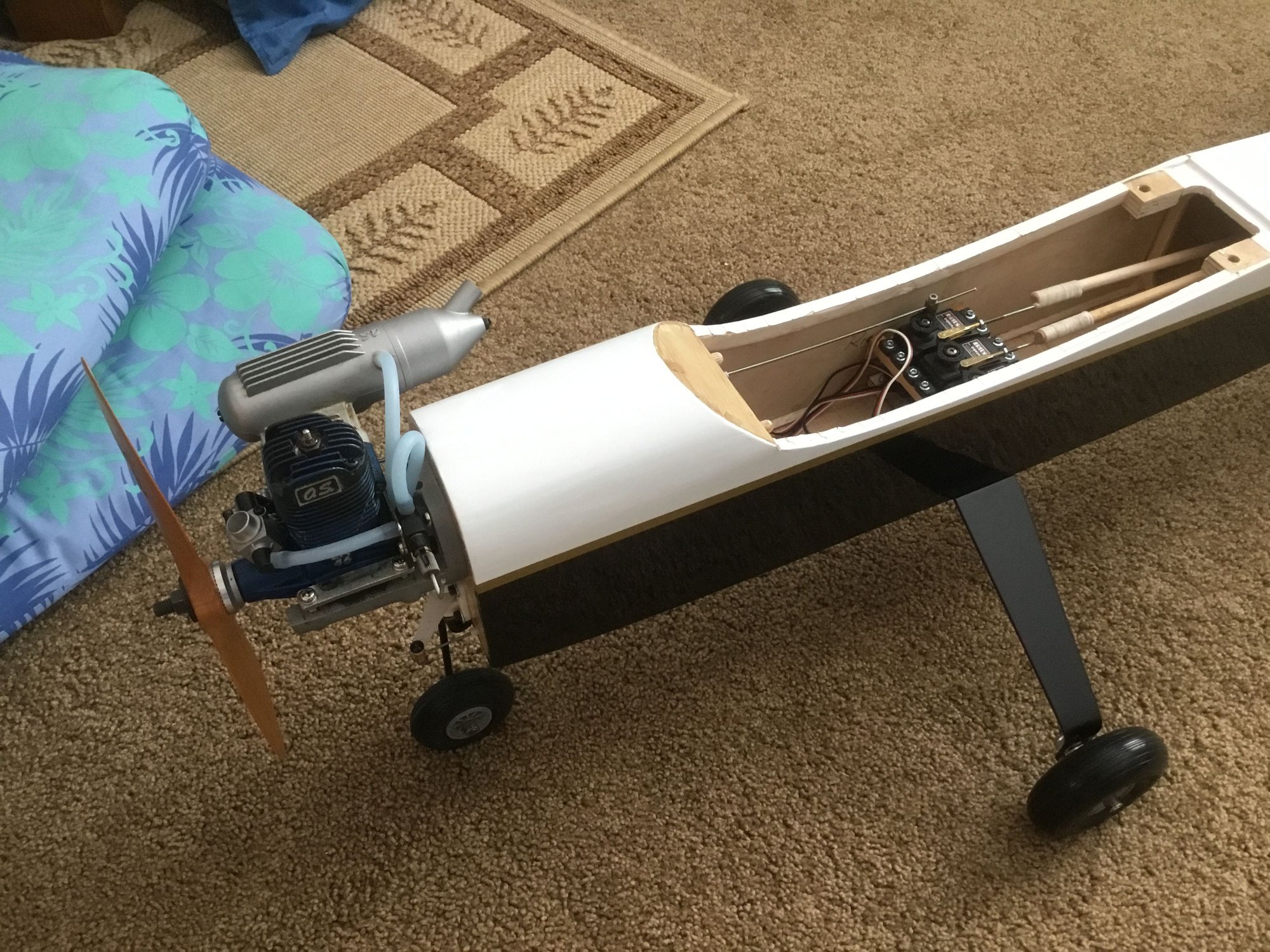

I am going to revive this old thread because I just picked up a Kavalier from a couple flying buddies. The plane was found by them in sad unfinished shape, so one repaired the wing and fuse, and built a new stab and fin, and covered it all fresh. As I installed the engine , I did not realize it’s supposed to be mounted at a 45 degree angle. I chose to go ultra simple and just mount it upright. But I notice that the firewall has very little right thrust and little to no downthrust to the naked eye. My question to those who have built and flown the Kav, is did the kit built plane fly well when the firewall was set per the plans (which I assume mine was)? TIA.

From my own experience there are three perks to mounting an engine with it canted over. The first is aesthetic. Sometimes, especially on a scale model you just don't want the cylinder head sticking up above the nose. The second is mechanical convenience. Depending on the design canting the motor over may give better access to the fuel line or the needle valve. I've also done it to put the exhaust outlet where it will get the least amount of oil on the rest of the airplane. The third and likely most important in a sport plane, is bringing the carb closer to the center line of the fuel tank. Lowering the carb by rotating the engine will help with fuel draw, especially in a model where the thrust line is well above the fuel tank. In the case of the Kavalier it probably won't make that much difference. A semi-symmetrical wing such as the Kavalier is not as sensitive to down thrust as a flat bottom wing . The bottom line is that as long as the previous owner hasn't built in any misalignment you will probably be okay. If it turns out that the airplane does pull one direction or another with changes in throttle it isn't too hard to add a degree or two of thrust change by placing a thin shim between the engine mount and the firewall.

As long as your plane was built per the plans, it will fly fine. You can check the downthrust and right thrust with an incidence meter. If it were me, I would be much more concerned with the stab alignment to the wing and fuse.

Hey thanks for the response! All I can do is try it as built by the first owner. My friend has one of those thrust disks for placing between the firewall and engine mount should I find that more down/side thrust is needed. I want to clarify I already had the blind nuts installed for upright engine mounting when my buddy told me it should be tilted 45degrees...too late. Re fuel tank location, I actually installed the fuel tank high up in the fuse right behind the firewall. Couple pics attached.

It looks like both you and the initial builder did a nice, neat job. The alignment of the airplane will probably be fine. As for right thrust, the clamp style engine mount will allow you to easily tweak in a degree or two of right thrust if needed. It should be a winner.

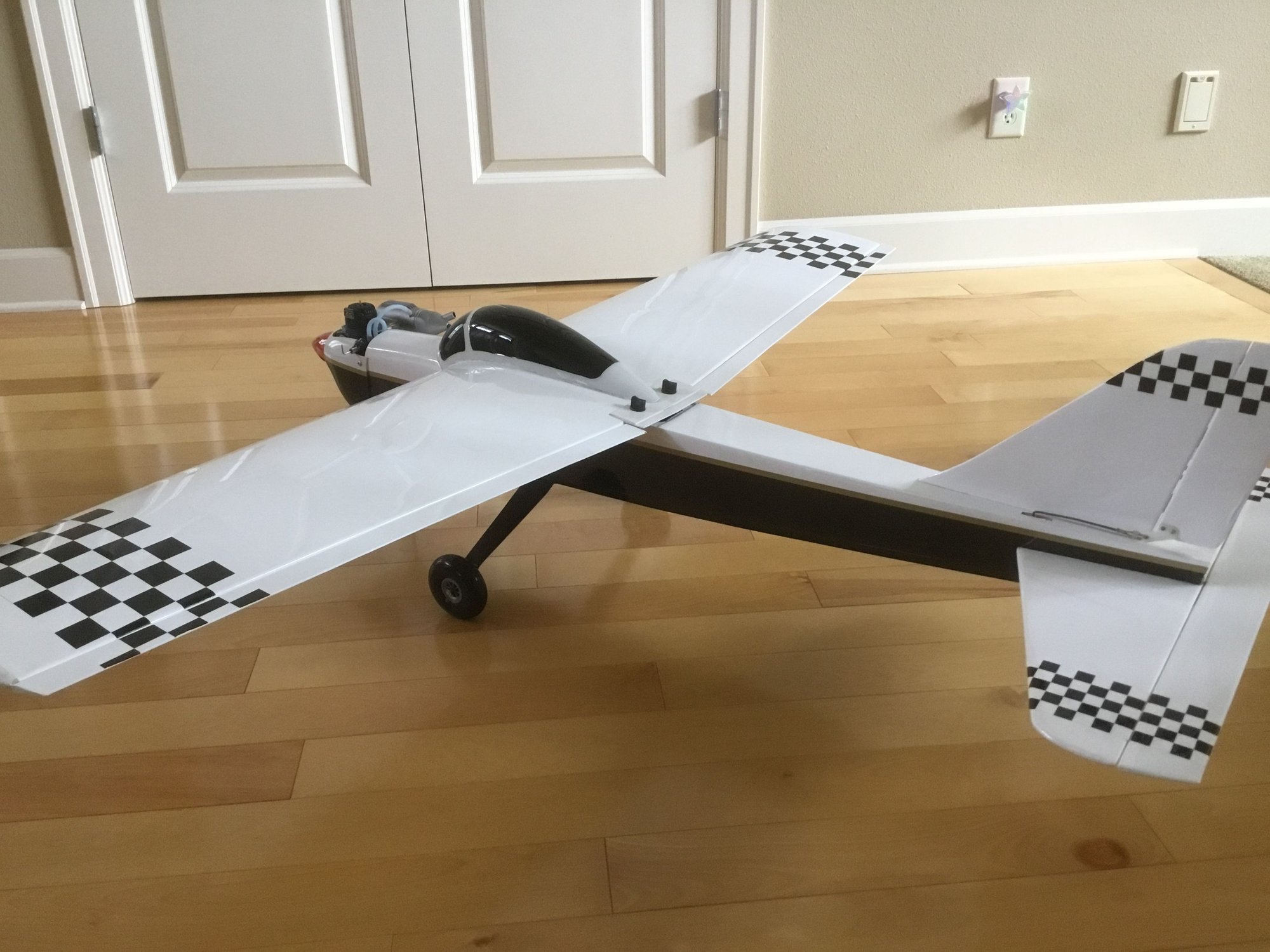

Basically my Kav is finished! I’m waiting on a black spinner in the mail, and I will likely add a few decals of some sort. She weighs 77oz, and CG is at 3 1/4” which is the forward point of recommended range. I will maiden her there and move the CG back later. She’s a cute lil dandy! Im glad I bought the unequipped plane from my buddies for $100!

It looks great! I kinda like the red spinner. It makes a nice contrast.

The new black spinner just arrived , and I couldn’t wait to get it on the Kav. I think she likes the new spinner! Now I just want to run the gum out of the engine and she will be ready to maiden one day soon.🤙🏼

Hey like the schme on you Kavalier I was gong to do the scheme on the box but I am no where near finishing as other things have got in the way!
