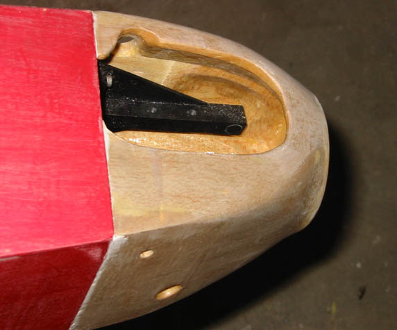

I like balsa cowls too. The link is good, and pretty much what I did on my Four Star 60, except that I made a plywood ring and lined up the engine to that before drilling the mounting holes. I didn't photograph a sequence, but maybe this will give an idea...
ID:	2248380   Click image for larger version
ID:	2248381   Click image for larger version

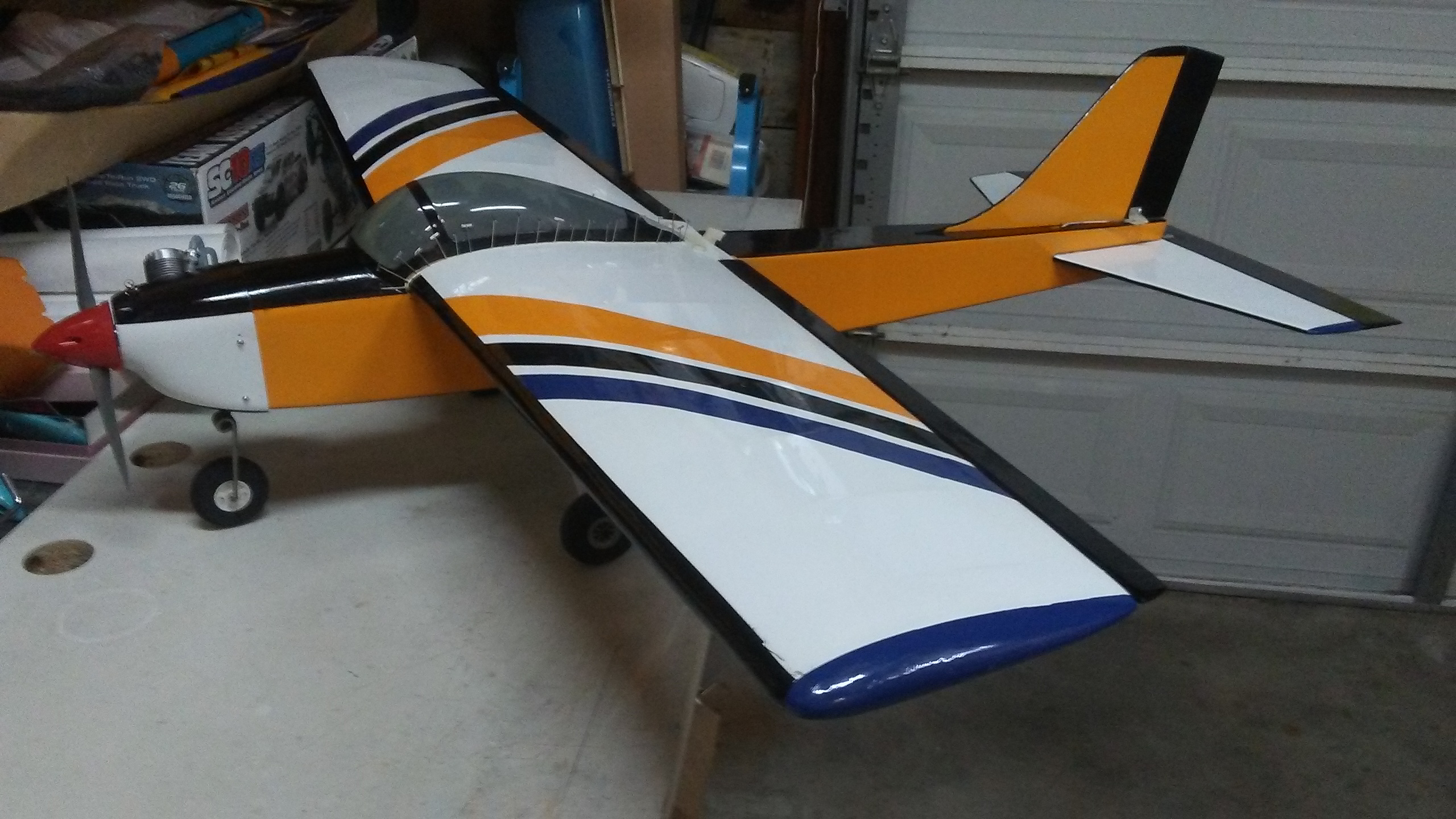

Here is a picture of my K, it has a new owner ( owner #4 ) and he likes it very much, it became his go to fly airplane.

Michael, the short story of the K goes like this, the Kavalier was given to me by a friend nearly 20 years ago, he build it and then he stopped and gave it to me some twenty years ago, later I give it to a friend a year later, that friend kept it for 19 years didn't do anything with it and give it back to me about a year ago so, it makes it a new 30 years old airplane that flys great, then I decided to build it during spring, I got to fly it a few times, it's a great flyer but it needed a new home, someone that will enjoy it more than me since I have other projects I need to finish and I'm also flying bigger airplanes, gas airplanes with 35cc engines and bigger.
The new owner ( owner #4, club member ) is having tons of fun flying the K, the K has a new 40 FP and it looks like it is the perfect engine for it.
That K needed to be build and flown after been framed up so many years ago and it did, proudly

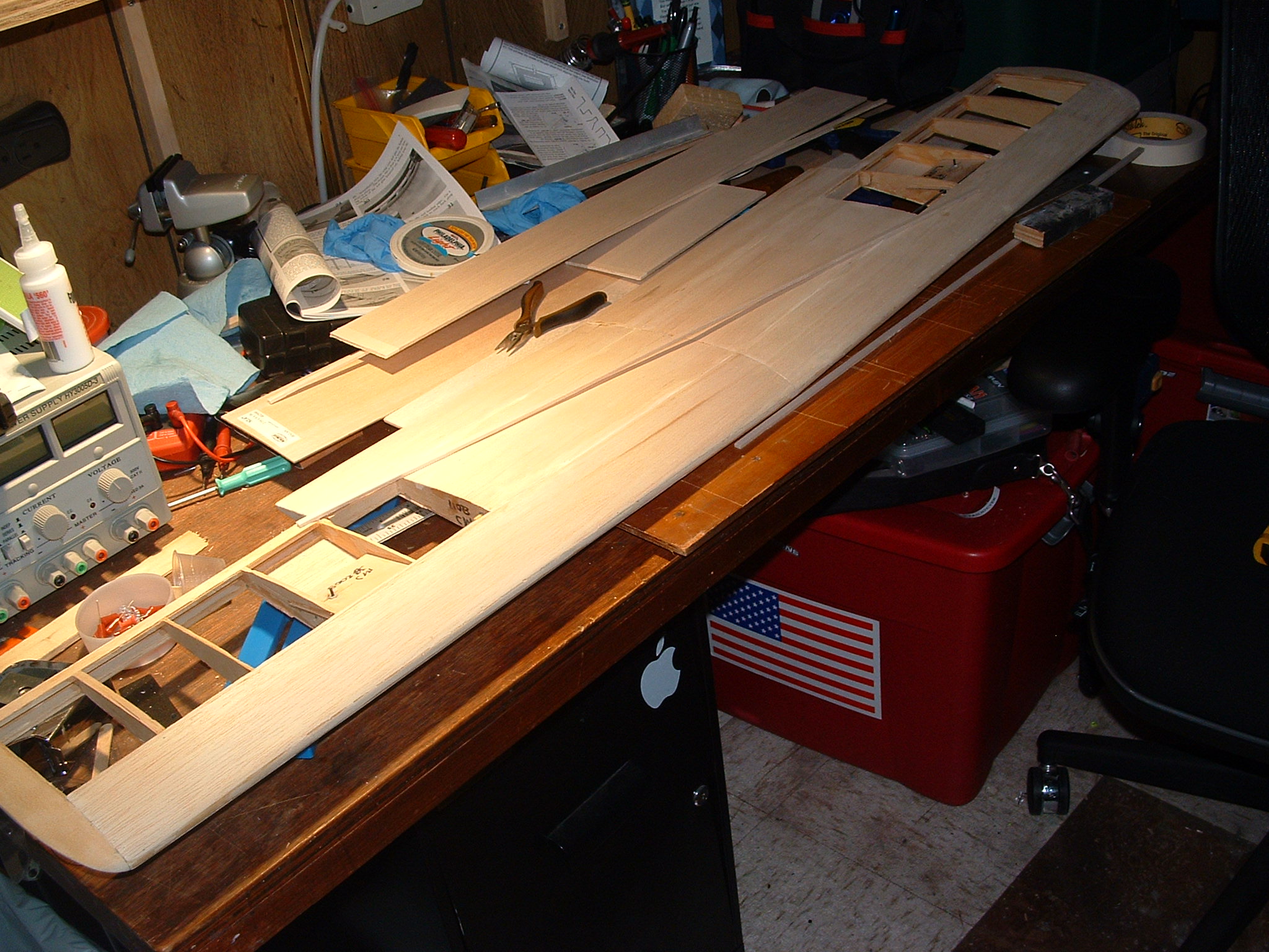

Hi Dave Sorry for the lack of updates as I have been trying to finish the wing on my A-ray which is almost done. I also have been working a lot of hours for the last three weeks. Life gets in the way you as probably know.
I had a little trouble figuring out how to cut the taper edge on the leading edges and consulted my local Hobby shop owner Eddie Taylor here in Wichita Falls TX (Action Hobbies/Lazerworks). Eddie has been real helpful with my build he also makes Lazer parts packs for sale online. He told me to take a piece of glass and lay it on top of my bench and then lay the leading edge on top and use a steel straight edge and lay it on top and start at the 3/16 inch end all the way down to 1/2 end. you also need to support the whole straight edge by placing another stick of the same thickness under the side you are not cutting. Now carefully clamp it to the bench and start cutting with a sharp Xacto Knife along the edge. he also told me to cut it in spurts and not to try to cut it in one continuous cut as you will you will find it is easy to destroy these Balsa Sticks After having to replace 1 of them I used this method and it works pretty good. I have two complete and very light wing panels!!! so thats it for this week I hope to have this glued together with 5 minute expoy and the end of the week. I will post some more pics later on in the week
Thank You

Wing looks great!

Nice job on the sheeting!

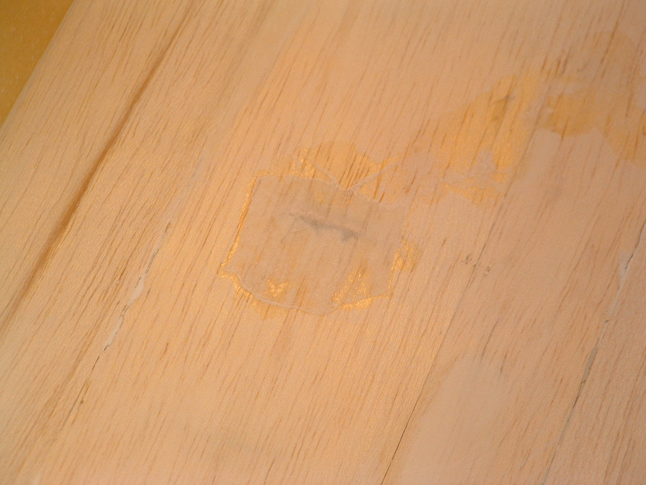

Good morning well I messed it up yesterday as I put to much on the seams to hide them and I was using a mouse sander to Knock it down. The sheeting got to thin and I and stuck my finger through so today I will be fixing that and getting it down today. I will also get sometime tonight to trim up the left panel and hopeful I can set it up to glue it together! It is so fun to be doing this again. Thanks Michael

I'd bet that nearly everyone here has done that same thing at least once. I know that I did - in 2 different places on the fuse - on my Stratus. Embarrassing to do it once - how do you explain TWICE?

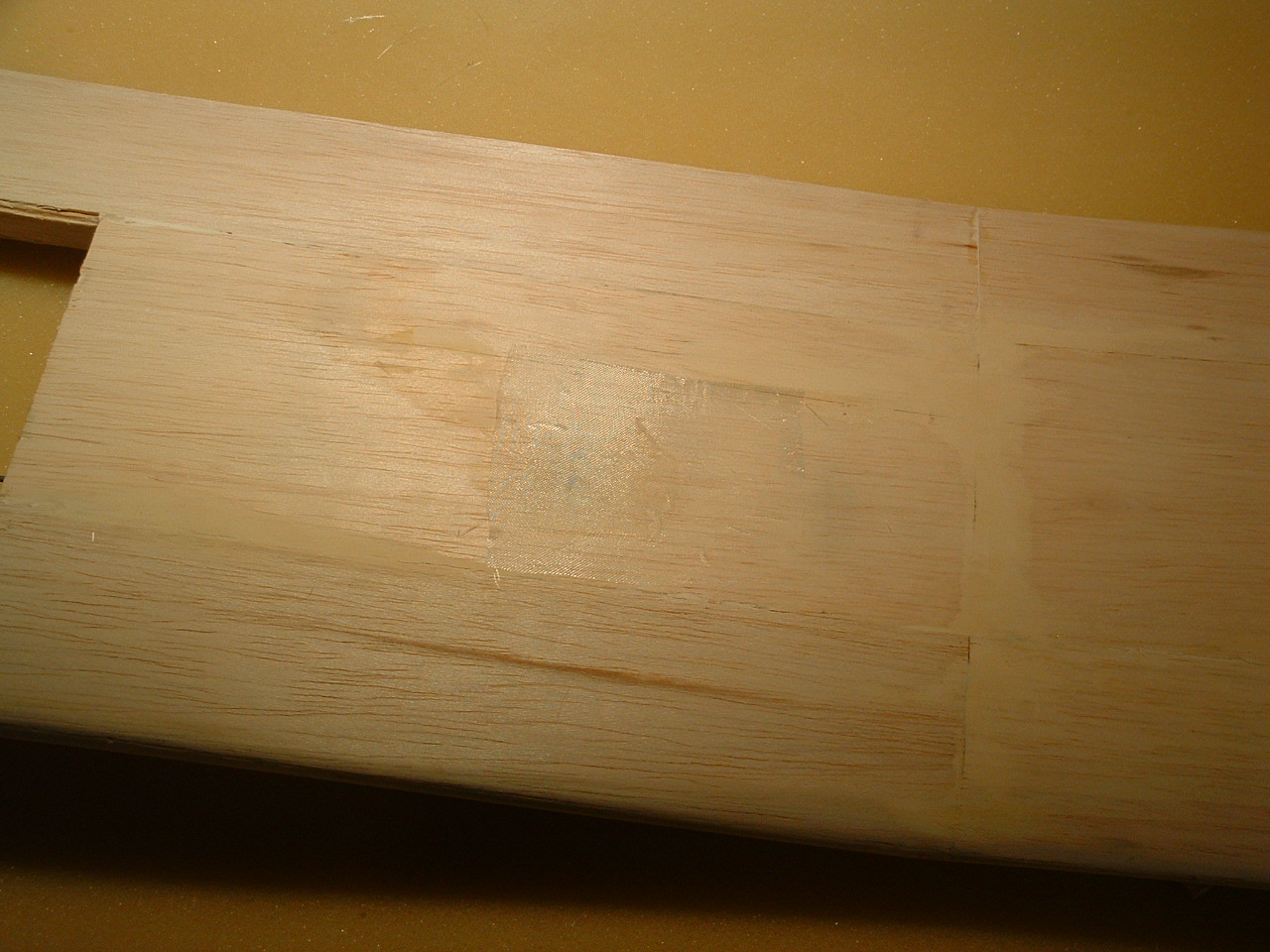

I would have just ripped the sheeting of but my friend Eddie gave me a new idea which is that you make a small patch out of 3/4 fiber glass and just lay it over the hole. You then saturate the heck out of with thin CA once it cures you sand the heck out of it then lay a bigger one on it and the same thing you sand it smooth put some filler on it and sand it smooth! Yikes. Yes this is very embarrassing to say the least but it will work out!
Great
I will post some pictures later today
Michael
Ps My build is not Abandoned its just on hold for a bit

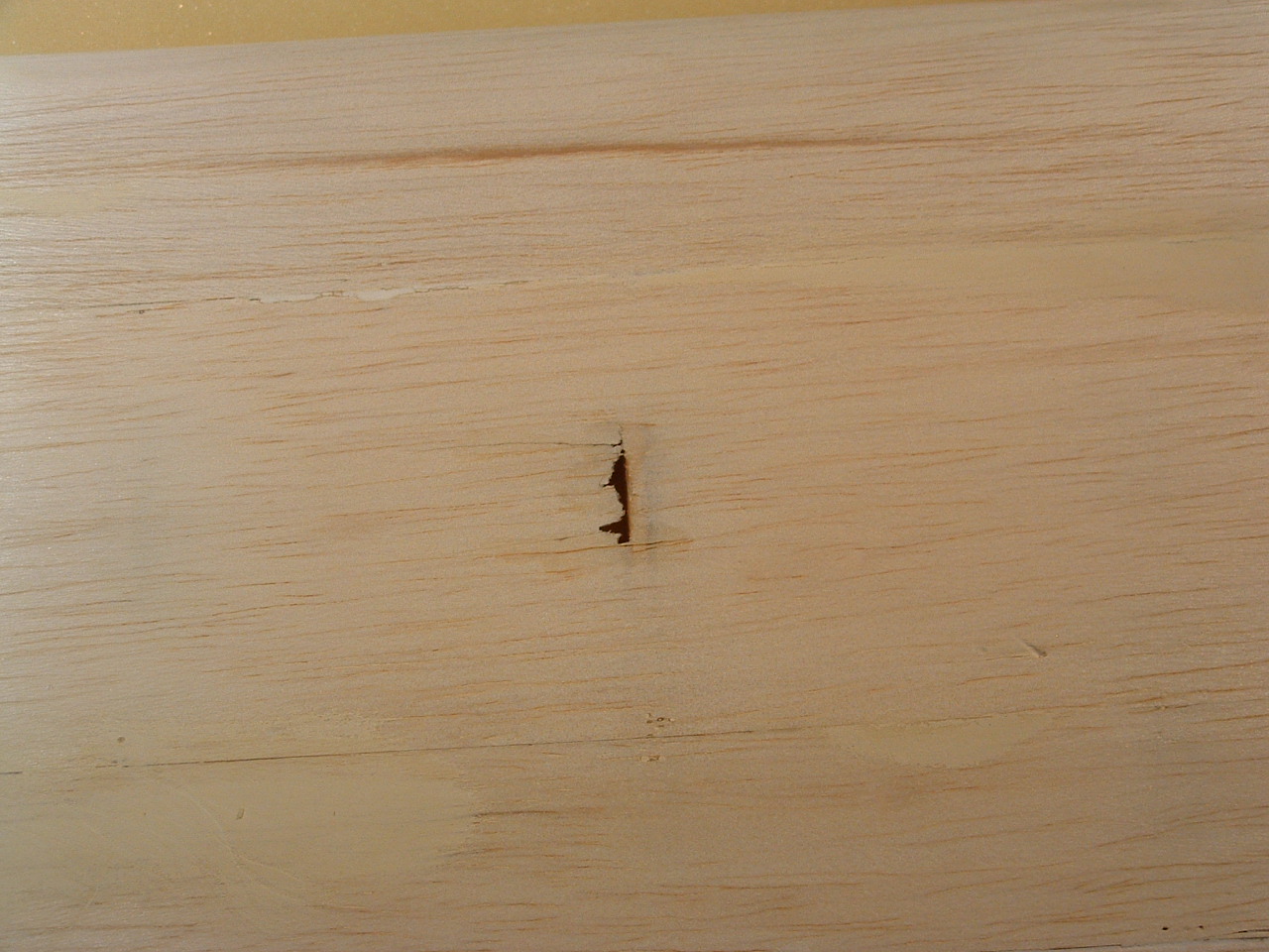

so here is my results of using this idea from my friend Eddie over at Action Hobbies here in Wichita Falls TX. I made two patches out of the 3/4 oz fiber glass cloth.I then sprayed 3M 77 spray adhesive on them and laid them out one at a time.I then saturated it with thin CA and let it dry then I lightly sanded the area then I put the other patch which is a little big bigger over the first one. I saturated it again with CA then I sanded it again now I can start applying the wood filler tomorrow. This was not very hard to do and it beats tearing the balsa sheeting off and starting over again!
Thank You

Y'learn something every day - that looks GOOD!!!

No one will ever know!

It came out pretty good so now I am filling it in a flare it to a smooth finish and maybe I can start covering this bad boy ha! She will be Metallic plum and bright yellow.

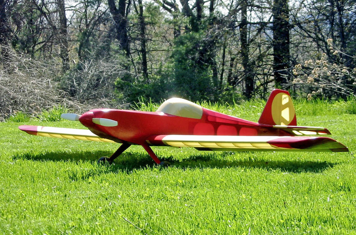

Michael
These two are all wood turbine jets.
