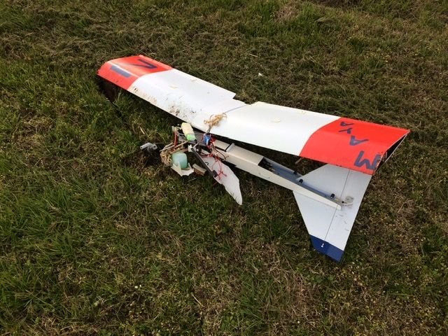

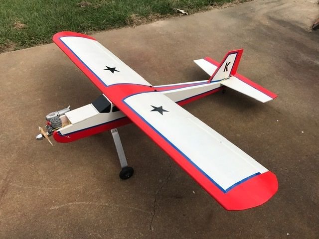

I was in the same dilemma when I got back into RC. No local kits to be found. So I went the scratch built route. I just print a plan then draw my own lines on freezer paper for the build. It isn’t as hard as it looks,IMO. It is different. Here are some builds. The coroplast plastic and gutter downspout airplanes are a favorite. But, Problems do happen. I just putt putt around the field.
‘Good luck with your build.
