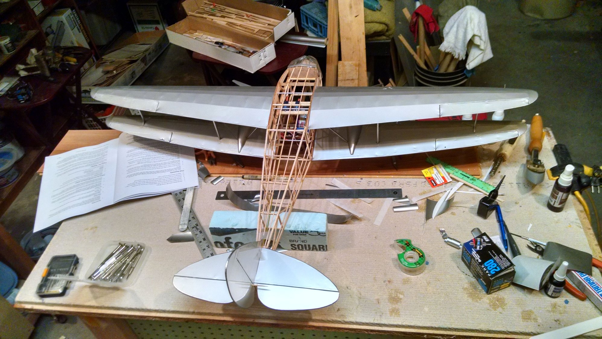

hangar 9 makes a light weight covering called parklite. it is a much lighter version of their ultracote. i believe monocote makes a liter version also
here is a picture of Pat Tritles Dumas dragonfly covered with parklite
the table is 2' by 4' plane has some 1/16 stringers and i swapped some spruce in a couple areas
finished plane
