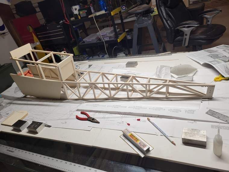

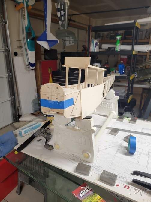

Hey folks! Starting a new build for this winter. Sig 1/4 scale Clipped Wing Cub. Have a couple of initial questions hoping some of you may be able to offer advise. First is the power plant. I have a Saito 1.25 sitting around but would like to consider evolving into the gas market. No experience with gas at all. So interested in pros and cons as well as what power plant you may recommend.
2nd is covering. Got reasonably proficient with Monokote but that is not longer offered. Built a plane with Ultracote last season and the verdict is still out. Have 0 experience with paint. So any suggestions would be helpful. I will be posting my progress here.
Thanks in advance for your assistance.

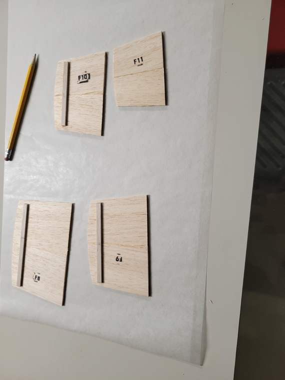

Starting with fuse formers

Thanks all for your comments. I may have to look into the neucover material. Still considering the power plant. Probably sticking with the saito 1.25 at this point.

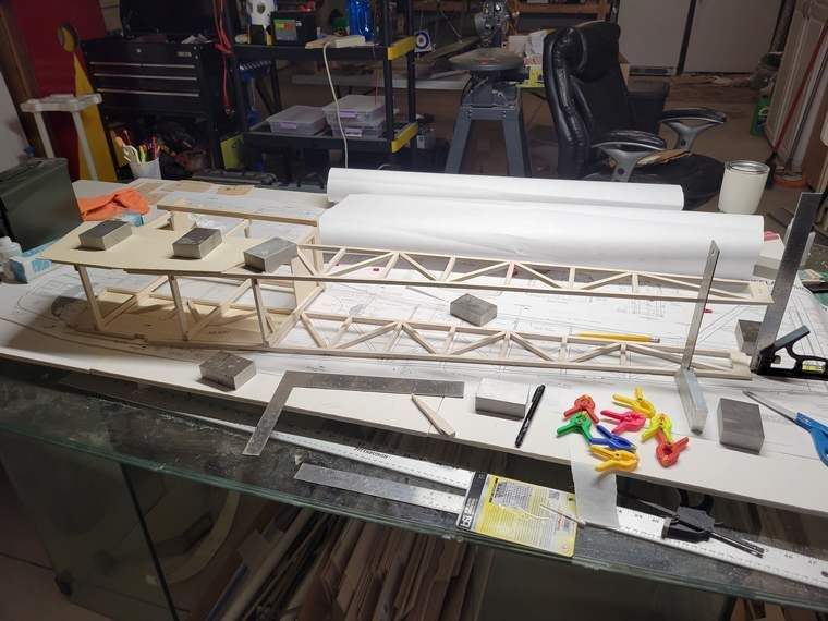

Starting the main frame
Building 2nd side over 1st to insure accuracy

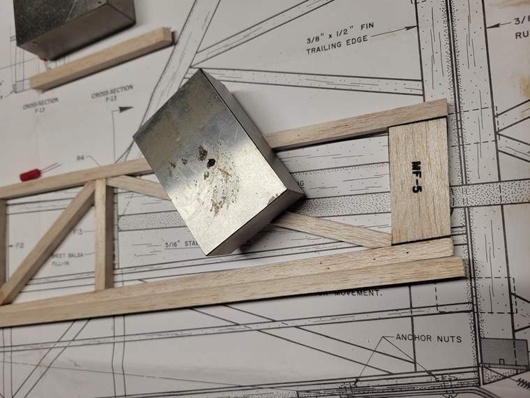

For anyone building this kit the part MF5 is not listed in the manual or on the plans. This pic may you sort it out

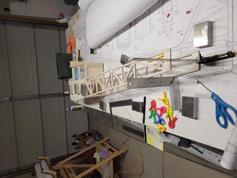

Further progress on the fuse. Got the sides attached.
Just a note on the build. This is a bit challenging for me. I have built a lot of kits primarily Top Flite etc where you get step by step clear instructions. This is a little more vague and needs a lot more forethought. Foreseeing that, I built the 1/6 scale version first to get an idea on the challenges. Didn't come out a well as I would like. So any suggestions, critiquing, etc. would be welcome.

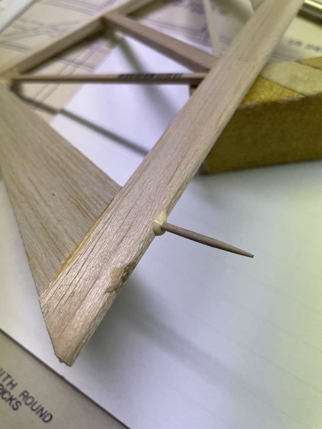

Looking at your progress, my guess is the next step will be the cross braces at the top and bottom of the two "girder" sides, and pulling the rear end of those girders together. The BUSA J3 is somewhat similar. and what I did was cut those pieces to length according to the plans and lay them out below where they go along the length of the tail section. Pin the cross braces at the second or third station back from the aft cabin former on one of the girder sections, then pull the tail together and clip it as you keep those pinned braces in position. That will give you the rough tapered shape of the tail. Now, place the cross braces at the first, then second station, pushing them in place against the natural spring of the girder. Then start at the fourth station and work your way to the rear, pinning each crass brace in position until everything is pinned in place, but not glued. Set the fuselage upright and check the alignment, making sure the taper is identical on each side and the cross braces are in their correct position by doing it over the plans. Once everything is in place and in perfect alignment and still pinned together, you can hit each joint with fast CA and as soon as it has set you can remove the pins and you'll have the cross braces all glued and the shape done. Then carefully cut and fit the diagonal braces, gluing them as you go, or pinning them and gluing them all at once. Then you'll have a solid and aligned fuselage lower portion to put the deck formers on as well as the base for the horizontal and vertical stabilizers.
Anytime you want additional strength in a joint but can't put gussets or bracing, you can pin the joint after gluing it by drilling through the joint and using a piece of round toothpick glued in the drilled hole. It's surprising how much strength it adds without adding significant weight. The picture below shows pinning part of the rudder, but it works anywhere. You only need enough to go about 3/16" to 1/4" into either side of the joint:

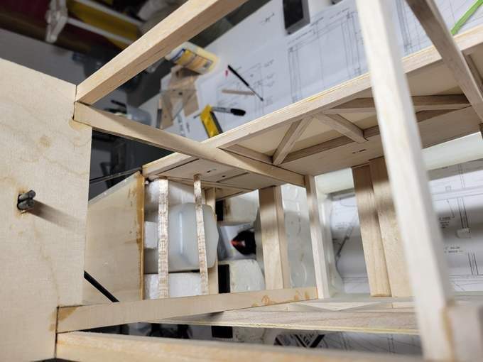

Further progress with firewall installed. Another overnight wait for epoxy before continuing. the structure in the nose sure seems light when considering the vibration and thrust involved for this plane. Anyone else have the same concerns or mods they have done to strengthen this area?

............. the structure in the nose sure seems light when considering the vibration and thrust involved for this plane. Anyone else have the same concerns or mods they have done to strengthen this area?
If you don't already have it, I would consider triangle stock in at least the sides and top behind the firewall. Especially if you are still planning on a gas engine.
Maybe even put a few TOOTHPICK PINS as Ken demonstrated a few post ago.

Oh duh! Thanks for the reminder. RC 101. Its been said that I don't have alls himers. I have some timers. Sometime I remember and sometimes I don't.

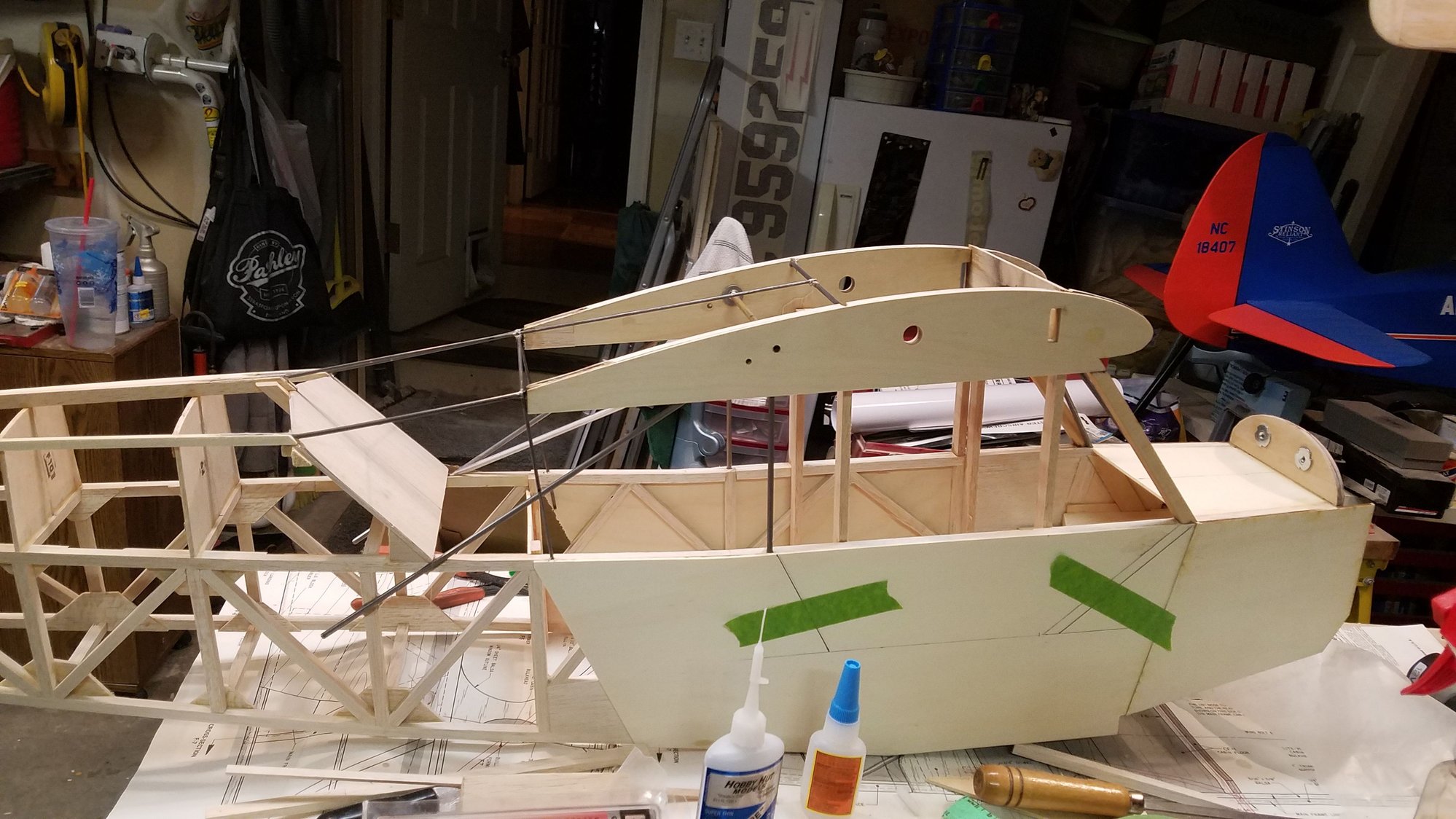

Added the cabin wires. Must say feel a bit silly after the tri stock affair. I remember why. I was focused on the joint between the nose frame and the main frame. They are simply attached by epoxy of 2 5/16 balsa sticks on either side and thus just lost track of the firewall. Now that I have the cabin wires installed it seems much more stout. May yet consider fibre-glassing the interior, especially at that joint. Stay with me

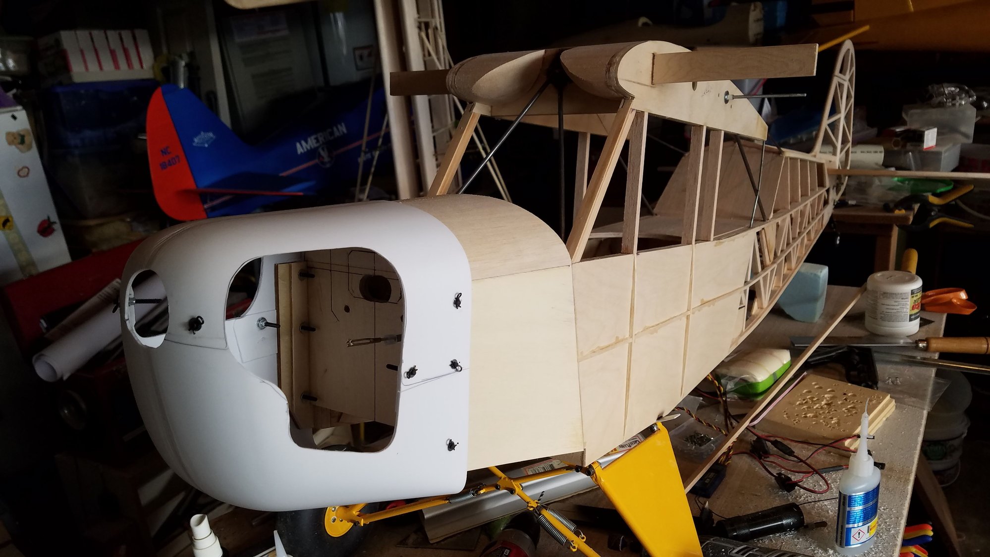

Good work! One problem with the Sig 1/4 CUB is that the top firewall engine mounting bolts have blind nuts that are forever sealed in place where they can't be serviced in any way. There is a flat tank compartment top piece that mounts horizontal behind the firewall that doesn't give access to that area. I cut most of the center out of that piece so I can get a hand in that area if needed in the future It really doesn't serve much of a purpose that can't be dealt with in other ways.
I love the SIG CUB and still have a fairly highly modified version still in my stable but the kit did get a bit dated over the years. It's a shame that a version 2 never came along as many of the building challenges you have come across could have been designed out with newer construction techniques. It's still a great airplane! Mine is powered with a DLE30 but any 20 - 30 gas engine is a good choice if you choose to go gas. Have had 4 stroke engines in CUBs before but didn't care for them as I'm just not a 4 stroke guy.
Beware of adding too much reinforcement at the expense of a lot of added weight. Locking the corners of the firewall to the fuselage with triangle wedges is sufficient, trust the strength of the balsa and plywood and the basic engineering of the design. If you do decide to use fiberglass and epoxy, limit it to strips in the corners of the fuselage box structure. There's no advantage to fiberglassing the entire fuselage, it just adds weight. My downfall when building is too much reinforcement, I build strong, but I also build heavy and it showed in the plane's performance. Higher landing speed, higher flying speed (greater wing loading), all related to the added weight. Sometimes it required added weight up front to get the CG where it needed to be, compounding the weight issue. Granted, these planes don't need a lot of power to fly and you'd like them to fly well and even better, survive a bit of rough handling, but the added strengthening doesn't always translate to crash damage resistance.

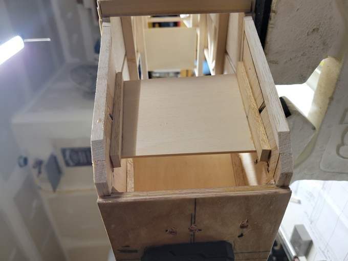

Ok. Got the fuel tank installed while everything is accessible. Now on to the formers and skin on the nose.

When you install the ply sheeting to the front add a few toothpicks into the sides of the firewall. on both of mine I needed to move the firewall back an inch for the OS gt ​​​​​22 engine so I remade the firewall to fit and put triangle stock on the front and rear
firewall moved back 1
firewall moved back 1" on j-3
trailing edge beveled stock in corners
ply extends onto edge of firewall on L-4
cowl mounting in ply before triangle stock installed
cowl mounting in ply before triangle stock installed, I added an extra layer of ply for blind nuts to attach cowl
