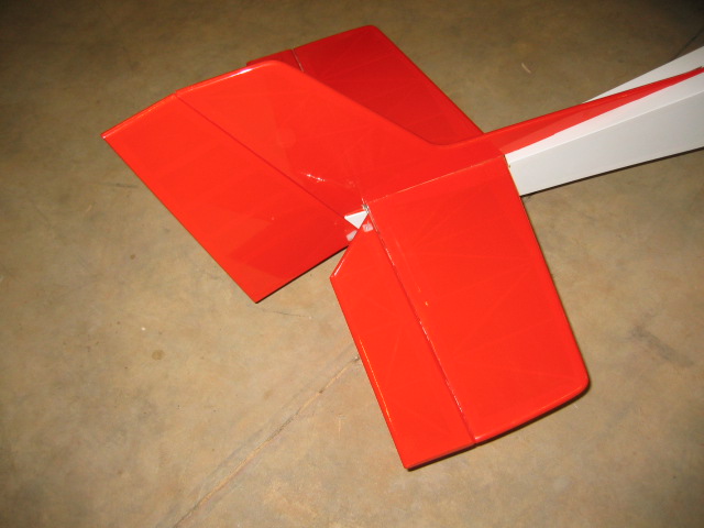

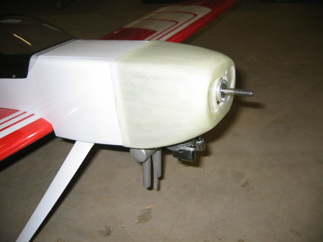

I finally have some modification pictures for your viewing pleasure! I still have not complete the project and flown it yet, but I'm VERY close and hope to be in the air within a couple weeks.
I have a web site with photo galleries of my planes and projects. Here is the link to the Tiger:
[link=http://www.georgescott.com/RCHobby/Tiger60/]Tiger 60 Modifications with photos[/link]
Here is one picture of my custom built cowl over the inverted Satio 100 with Pitts muffler:
AND
Here's one of the tail feather modifications, massive rudder and doubled built-up elevator:
