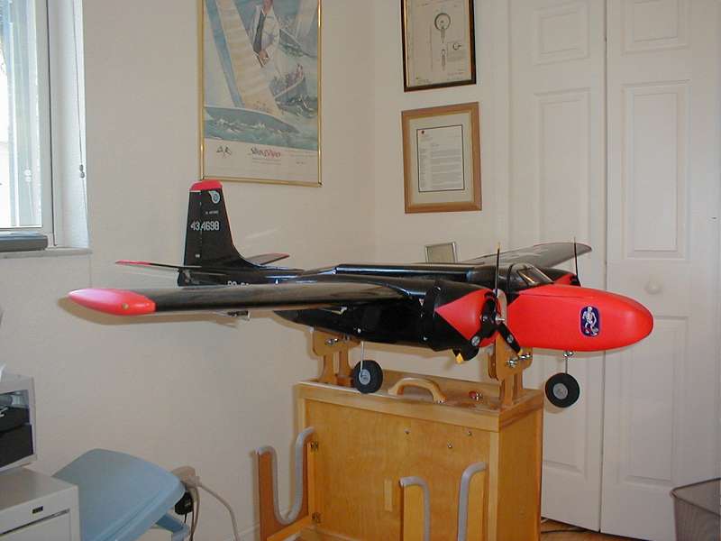

The 7th Chadwick is nearly done and I thought you might like to see a preview. I have not yet set the CG, she seems to be nose heavy. I may have to moves something aft, but that is better than the other way. The control surfaces for the ailerons and the flaps have not been set. Engine run-up found the port engine acting up. I think I know what the cause is. Rudder and Elevator adjusted easily and are set.
You will notice that I have taken some liberties with history. I am sure they did not use Gloss Black! The nose is painted with a "Day-Glow" red. The tail numbers etc. are white because the red decals faded into the black and were not visible. I have the machine guns and turrets but looking at the model I began to think that we have seen enough machine guns in my life. I may leave them off.

Nice going your plane looks pretty nice to me even with out the guns. And thats OKAY with me cause yours can be the converted forstfire one
. Still looks good hope to someday see it fly at an event near the midwest.[&:]

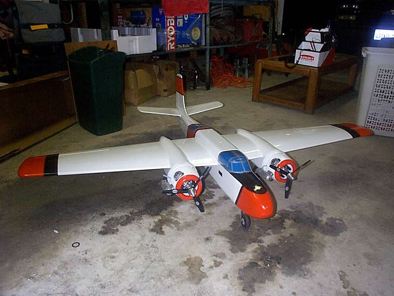

Thanks for the info, Turns out it's balanced right on the money. It actually flies pretty good. Needs alot of power though. I am running O.S. LA 40's with 3 Blade 8x7 master airscrew's. needs a little power on for landing. I have not had an engine out yet but it has a nice size rudder to help out in case. Sure is an eye catcher at the field, "Everybody wants to see the twin fly" or maybe crash? Hmmm.
I dont know the weight of mine but i will know soon. Yours sure looks nice. You did a great job on it. I only wish i had built mine, but, then again you said it took alot out of you to complete it. I hope your's fly's as good as she looks..........
Good luck with your maiden flight.

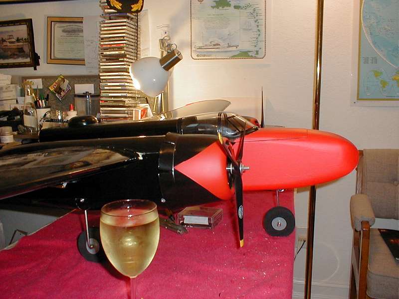

Construction of the Chadwick stopped as this pilot overdosed on Balsa. I recovered last week and finished. The Chadwick weighs 147.5 oz full up. The weight includes 1 oz for the co-pilot and 0.6 oz for the servo I just had to put under the top turret. The Ultimate BEC did not work out consequently I had to add the weight of a 4.8 volt receiver battery.
That is the good news.
The bad new. The Chadwick is extremely nose heavy. Some how I mis-calculated. One of the batteries will have to move aft. To move the battery should be easy. Changing the battery will be a nightmare as the battery will be under the wing. Taking the wing off this plane is a chore. The aileron wiring, the flaps, port motor control, starbd motor control, running lights (yes I added running lights), the turret servo and the heavy power leads (4) almost guarantee something will be plugged in wrong. To prevent such an error I am using a single 15 pin connector to handle all but the power leads.

At first I was not going to answer you but I decided maybe some body else will gain from my error.
I estimated the plane would be very tail heavy, consequently I installed both motor batteries, (one for the port, one for the starbrd motor) in the nose of the plane. I also put as much junk on or near the CG as possible. The second decision is what complicated the connections to the wing. I crammed all of the conventional stuff plus an FMA Co-Pilot into a few inches.
The motor batteries are 10 cell Sanyo HR-1950 FAUP with wire and connector they weigh 14.9 oz each. For the electrical folks the motors are EndoPlasma with a 4.6:1 gear ratio turning 11x7 3 blade props. The plane has not flown yet however MotoCal thinks it will but recommends an "experienced" pilot. I do not qualify so I added the Co-Pilot. As you can see in the photograph I had to move one battery aft. I also had to relocate the Rx battery forward to balance the plane.
There is a balsa separator above the servos (removed for the photo) to keep the wires from jamming up the system.
