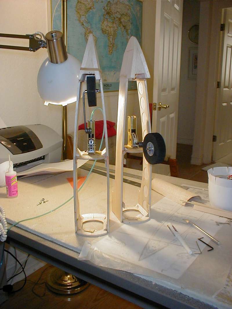

If you remember I ordered the wrong retracts (I ordered the retracts for the VQ model of the A-26). I waited until Spring Air sent me the ones for the Wing Mfg A-26 to make the layout on the firewalls and install blind nuts to be used later if. They arrived early this week Thank You Spring Air.
I have changed the plan, I am going to install the retracts while the nacelles and the fuse has easy access. I have already drilled the holes and dry fitted the fixed gear, so installation later if necessary will be easier than trying to add the retracts.
The access for the retractable LG will need to be much larger than I realized so building a hatch is not realistic. I will make the decision of how to finish the nacelles after I install the LG and see how it fits. Currently I am re-building the tail pieces that I had installed upside down. Caution: Building of the nacelles is done upside down before you add firewalls and the end pieces be sure you know which way is up!

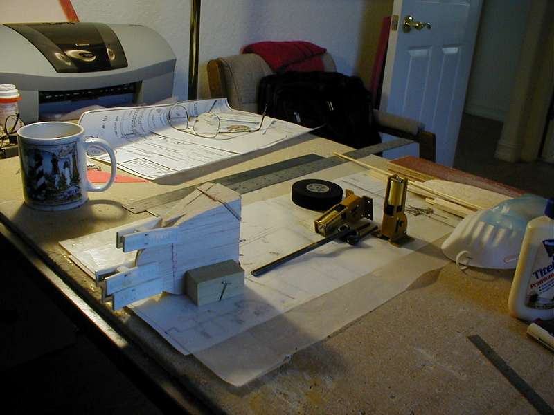

Now that I have decided to put the retracts in I did a dry fit check. The retract instructions advise "cut away to clear tire" and "cut bottom out for gear clearance. Cutting away to clear the tire was easy. Now I need to build a bottom (from the firewall to the tail) I have not figured out how I am going to to that.
Ideas, hints and suggestions appreciated.

Islewis on your air lines be sure to get a set of airline restrictors from Robart. These will help your plane survive the slamming up and down of your gear. Will also help in the scale raising and lowering of the gear. Trust me these will work better than any wheel callor you can get plus more control of the gear. As far as the bottoms of the nussel start planking from one side to the other. Before you start though round out the back of the nussel round out and then start planking. After planking thick CA accross the planks on the inside then cut out for the gear doors then hinge. Use a small cable or dental floss accross the opening between the doors ( thread is attached to the doors not the nussel)when the gear goes up the doors will close. Make a small spring that will force te doors open. Works real good

Thank you nchrome, missed your advise. I have added a set of Robart restrictors to my Tower order. I will start the planking today. I had not planned on doors but you make it sound so easy.

Progress has been made. I planked the nacelles and cut out for the LG. Installed the retracts and found I had to cut even more. Installed the speed controllers, switches and an arming plug. Sanded, mated the cowling's and found I had to bend the exhaust flaps out and away. Used the heat gun. Caution a second too much heat and you have melted plastic instead of exhaust flaps. Pulled the cowling's off and sanded them in prep of painting. No picture today, nothing to show as the nacelles are dissambled.

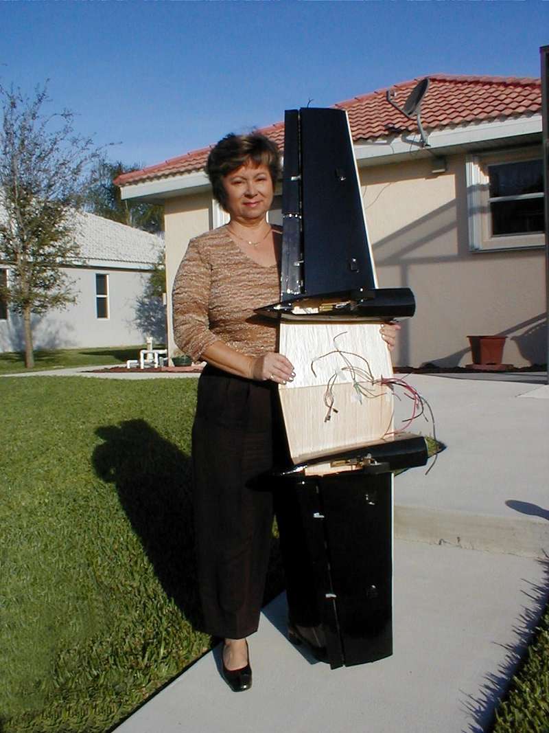

With epoxy everywhere I glued the wing halfs together then added the nacelles. I covered the bottom side of the outboard wing panels so I can hook up and test the servos. Sure enough one is back-wards, darn. Most of Monday was spent hooking up all the wiring. Two (2) Aileron Servos, 2 Flap Servos, two throttles. The ESC throttles will tie together with a Y cable in Phase A, if that does not work or the motors are too far out of sync Phase B calls for independently adjustable motor speeds. That is a whole new ball game.
In the first picture my wife Maria is squinting because the sun is in her eyes. Oops, I hope that is the reason. The second shot is of the wiring mess.

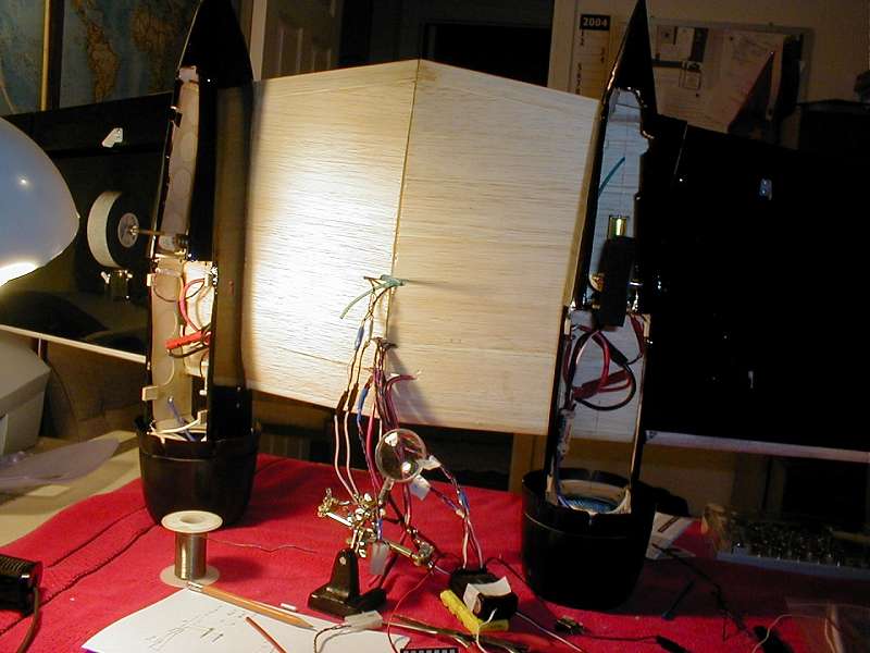

The electrical wiring is complete and the wing joint has been fiberglassed. I installed the nose wheel retract but not without complication I had already installed small shelfs for batteries leaving what I thought would be enough room for the retract/wheel etc. But I neglected to consider the nose wheel steering control horn.
I totaled up all the weights and at 9.13 lbs (total with everything) I am 8 oz below budget! The calculations say The 7th Chadwick will do well.

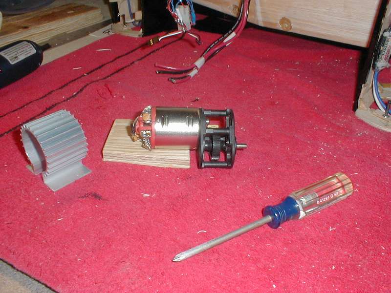

I too am worried about being able to fly this plane with the power I have installed. I worked the data with Motocalc and it thinks it will work. As far as watts per pound at 9 lbs X 50lbs = 450 watts. 9lbs X 60 = 540 watts. I am expecting to have over 600 watts. The plane is too heavy to do really well as electric, but it is a challenge. Best yet it will be a challenge to get it flying with the low cost system I plan to use. The Endoplasmas are turning so fast, 34,000 rpm I worry about them over heating and throwing all of the solder out.
I have some aluminum fins that fit the Endoplasma designed to act as a motor mount and to provide additional cooling. I hope that will help.

I am expecting the Geared Endoplasma to run at 33 amps at 12 volts that is 396 watts per motor 792 watts total. The running voltage is more likely to be about 10 volts for 330 watts per side 660 total. Both are theoretically enough to fly the plane. The Endoplasma motor costs $20 and the Great Planes GD-600 gear box $13. The gear box is modified to 5:1 with a $4 gear from Gary Wright Model Products http://www.gwmp.net/
Several experts have recommended the Geared Astro 05 or 25 but at $130+ each I will try the Endoplasma. If worse comes to worse I have two small glow planes the Endos will fly for sure.
The photo shows the Endo mated with the gear box. The cooling fins are my idea and have yet to be proven. The fin must be drilled to match the cooling air vents on the motor.

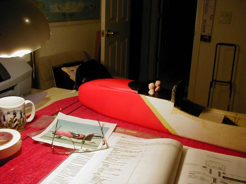

I masked and painted the main canopy. I cleaned and masked the observation canopy that I painted with the water based spray paint. Alcohol did the trick. I will paint the main canopy tomorrow with rustolium.
I could not wait, I painted the nose 13th Bomb Squadron Red!
