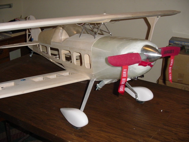

I am currently working on a Midwest Super Stinker. SO far it is going very well, despite the long building time. The only things I changed were mounting the engine (Saito 180) inverted to improve side profile looks, removable tailwheel in case of damage, and an extra layer of 1/8" balsa on the outside of the wing struts to improve the looks of them. Here is a picture of it so far...

Daywalker --I like your suggestion about the struts....I recently finished a Midwest 300XS and was very impressed with the way it built....I just have most of the fuse done on the Super Stinker...I took tailskids advice and put spruce stringers on the bottom of the fuse...Where that 1/32 plywood forms the turtledeck I like to run a 1/4 sq balsa on top of each of the fuse sides and cut the ply a little short...then fill any gap with filler...that way you get nice flush sides without the overhang...Were you pleased with your wing alignment as built/designed or did you have to do alot of dinking to get it right??? The only other biplane I've done was a Pica 1/5th Waco and the wing alignment just about had me crying!!!!!!!!!! Thanks Bob

Though a biplane can be a real pain to get aligned, if you have 3 or more really good alignment tools, either Robart or the laser type, life becomes a lot simpler and faster. Setting a good reference line on the wings and fuse will also assist in the measuring/alignment.
For some really good tips on setting up a bipe, including the Super Stinker in numerous illustrations, pick up a copy of Harry Higleys book called "Bipes". I bought a copy a long, long time ago and still refer to it from time to time. The methods are tried and true. It was, and still is, worth the cost.
