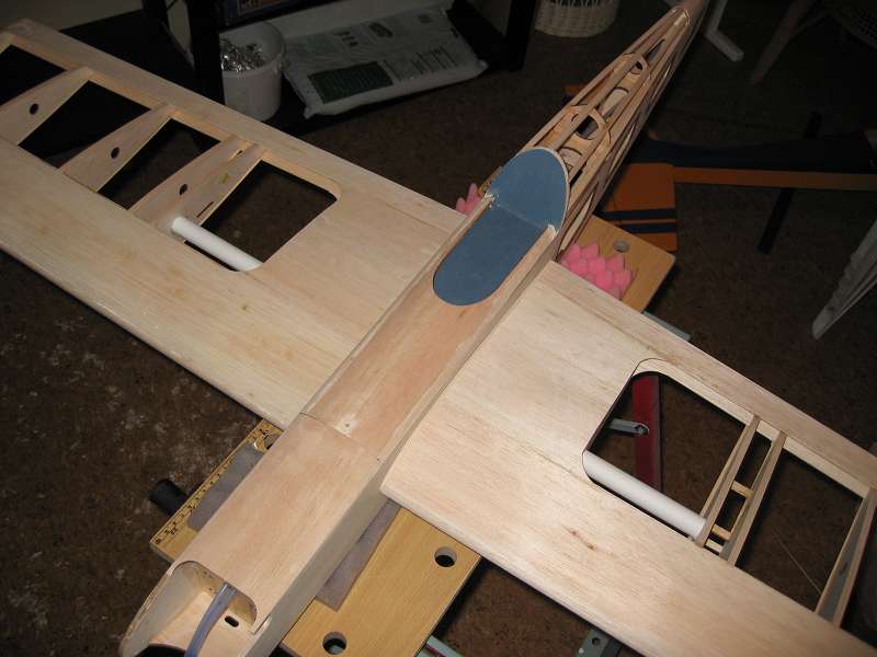

Hi
I am currently building a Sig Something Extra Kit and have a problem I think. The wing should be mounted to the fuselage with an aluminium tube through the fuselage but I have a small gap (about 1 mm) between the left wing and the fuselage. Upon closer inspection it seems as if the left wing's inner plywood piece is a bit warped. The leading and trailing end touches the fuselage and in the middle there is a 1 mm gap.
What is the best way to correct this? (should I ad a sheet of balsa and try to sand the inner edge absolutely true (I dont have any large sanding tools though and I am a bit concerned that the wing will end up with incorrect angle to the fuselage)
Will the plane hold if I leave the gap?
/Johan

get a piece of hardboard about 3/4" x 6" x 18" and spray glue sandpaper on both sides of it - fine on one side and coarse on the other. Clamp it to your workbench and use it to flatten things like this.
Personally, I would sand as much of the wing as I could to get it flat. If I couldn't get it completely flat without losing too much material, then yes, I would laminate something to it that would allow me to sand it completely flat. I wouldn't use balsa though. Maybe some lite-ply.

SwedeAce , I had this same problem with my Something Extra. I laminated 1/16" balsa to the wing rib at the low areas only. I then blended in the new balsa until it was flat and true with the rib and the fuselage. I hope I wrote that in a way that makes sense. I have been flying this plane for about 3 years and haven't had any problems. It is a great flying airplane. Good luck.

Thanks for your answers.
I will try to glue a large sandpaper to a board and then laminate the wing. By doing that I probably won't take away too much material and hopefully the wing will remain straight.

This is what i did:
I glued some sandpaper on a hardboard and sanded the wing straight. It took some time because the ply in the inner spar was so hard but I think I got it straight.[&:]
Thanks for all advices: I'll post a picture when the plane is done.

As you know, the trick with a sandpaper glued to a board worked for me. As you can see there is almost no gap any more (there is no gap if you would ask me..)
Thanks for all advices!

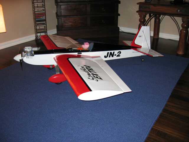

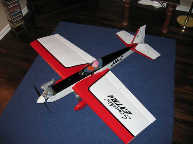

Finally the model is finished. If the weather is good I will be flying it tomorrow! This kit is an easy build but for me it took a lot of time. It was fun all the way thoug and I hope It flies as good as everyone says in the forums here at RCUNiverse...[&:]
