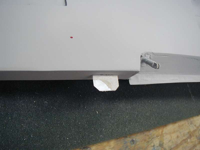

If I can get the photo attached, you will see that some of the outside material has been pulled away by the masking tape I had on it for painting.
Jim
Jim

Sorry guys but I too have just experienced two sets of hinge failures.
I have a Hanger 9 Cap 232 120 size Matt Chapman Edition that I had just completed a few 3 weeks ago. On the 3rd flight I lost all the hinges on one of the ailerons. I was able to land her with no damage so I took her home and replaced all the hinges on that aileron. Two flights later and I lost all the hinges on one of the elevators. Again I was able to bring her down with out any problems. The hinges I was was using are the pre-cut Great Planes CA hinges. New bottle of thin CA and the fit of the hinges were just a tad bit from flush.
The problem was not that the plastic separated from the fiber ( maybe on two hinges) but what had happed was the hinge itself split into two halves. Since that last incident, I have not flown and had just received my order of nylon pinned hinges. I don't think I want to chance another failure.

The top pic is almot exacly like the Ca Hinge example i was going to post.....Crazy as it seems but the only diff is the fiber came all the way off....
ON my pinned hinges which are exactly like Johns I Put milled fiberglass in some 15 min epoxy and then soaked som left over Zap from my Ca hinges on em. I also drilled a hole through the top part and put a toothpic em to (just in case) keep them from sliding out...
Good luck and hope nobody will have the experience of landing a plane with one elevator and one aileron again!!!
