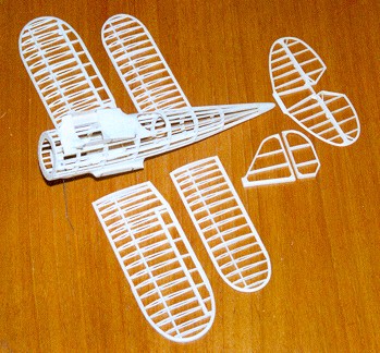

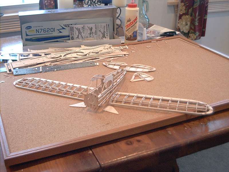

Well after spending about 12 hours on this kit i am ready to cover this thing with the tissue paper now. It wasn't too hard, but the cutting job they did on some of the smaller more intricate pieces wasnt good. I had to cut those out with the knife.
Here are a few pictures of where im at right now, and a picture of the custom hinge I had to make for the elevator and rudder. This thing wasnt made to have movable tail surfaces, but this solved the problem.
I'll put up more pictures when I get farther along in building it. Thanks for the help.
Couple of things for you-here's a great link to a complete how-to on covering with tissue:
http://www.aalmps.com/covering.htm
Just noticed your question about prop size-yes, you'll end up running a prop that is larger than scale. Just goes with the territory. An effect of shrinking the size of the plane without shrinking the size of the air molecules it flies through.
The build is looking pretty good. Just wondering how you're gonna get the horizontal stab un-glued from the plans.
And here's a photo of a lighter way to make tail surfaces. It is thin strips of balsa soaked in warm water and wrapped around a cardboard or foamboard pattern and glued with a bit of
Titebond. Way stronger and vastly lighter than the Guillow's way with the huge flat pieces.
Kelvin
Kelvin

Yeah, my parts got stuck on the paper, and stupidly, I noticed that it said use wax paper over the plans to keep from sticking after I glued it. Oh well, I took pictures of the plan areas that were going to get ripped up before I took them up, so it was ok. I've got my first layer of paper on the wings and tail surfaces and it is going good so far. Now that the wood is covered up, can I just apply a thin coat of the stuff im using on the tissue paper itself?
By the way, in the instructions, they said that 70% elmers glue 30% water mixture works as a sealer and adhesive, and thats what i've been using. Thanks.
