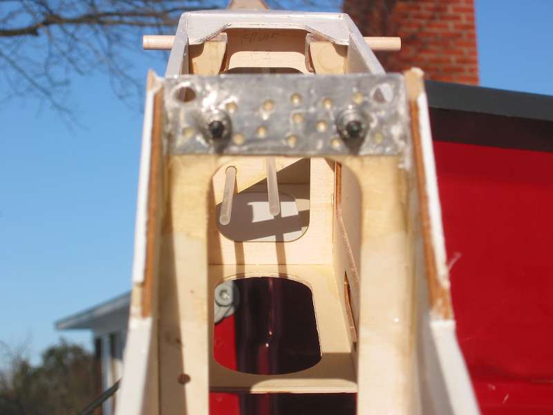

I did think about retracts until I remembered I'm dealing with a high wing[X(]> I cut the holes in the accessible ribs with a ball cutter on a dremel and the innaccessible ribs under inboard wing sheeting with a sharpened piece of tube. What I can't figure out how to do is insert the paper tube itself. I didn't even think about it's purpose also being for leads slapping the covering in the higher performance birds.
I did remove all but about a half inch of dihedral and what is left is based on some comments here about a flat wing looking droopy while on the ground. The decision to remove the dihedral was made late in the wing construction so i just sawed it completely in half. I made some short 3/16" thick 4-ply dihedral braces and epoxied them on both sides of the main spar about 2" up each wing and then glassed the whole joint with two layers of glass 2.5 inches wide and finishing epoxy. The rear spar remained cut and I am hoping the glass joint carries his load. there is a wider glass joint where the wing bolt holes penetrate the TE. You make a good point about the constand chord wing not giving me a warbird stall response. In this case I just get the construction experience and hopefully riduculously slow flight capabilities. Time to (re)learn something, what is the aerodynamical purpose of the tapered wing?
I have made preparations to move the landing gear forward enough to clear the bomb bay doors. The gear is the bent aluminum type with tapered legs that either taper forwards or rearwards depending upon which way you orient them when mounted. One way puts the axles exactly in line with the LE and the other puts them 1" forward of the LE. The looks are affected slightly if the "lean" goes backwards but I only care about the best performance. Any thoughts? The holes are symetrical and for (4) 10-24 nylon screws so it can be reversed in the field. I have thought about bigger tires as in a bush plane. One of the pictures shows the wooden blocks for the gear mounting.
I also epoxied, screwed and glassed (probably that overkill thing going on here) an aluminum plate to receive the wing dowels. Hitting the middle of the wings LE with a 1/4 " dowel left little plywood for the receiving holes in the fuse so I added metal. I am nervouse about 1/4" wood dowels so I might go with aluminum dowels. They are 1/4" because I am nervous about big holes in my LE. I will probably add additional glass to this area of the wing as well once the dowels are in place. The drill in the picture is to show intent, the wing is not anchored well enough yet for drilling.

Here is the glassed wing joint with the extra glassing for the rear wing bolts. Here is also a shot of the epoxied in blocks in the fuse for the wing bolts. Keep in mind the plane was already built up through the wood phase by it's original deceased owner so I did a certain amount of backing up and "after thoughts" for all these mods. The woodworking was excellent however and everything is straight. I'm sure he'll jump in the cockpit when this thing takes to the air!

A pair of 1/4" beech or ramin dowels anchored in the plywood bulkhead will take everything that plane can give in the air (provided you don't add too much weight
), and when the balsa meets the pavement it's often better to have wing hold-downs that 'crumple' to reduce damage. Your hold-down blocks look like you could do chin-ups on them. If you dig a wing tip in a hard landing, either the wing bolts will need to shear quickly or the wing will snap along it's length (or pull a section of fuselage out).

Glad to see your having fun. You really don't need the aluminum two layers of 1/8" cut to fit and epoxied will work quite well. same with the wing dowels. Also including a site which explains the pull - pull Http://www.member.cox.net/bdfelice/
I've done this on the rudder and tail wheel on an lt-40 myself and it works well. I kind of did my tailwheel as an afterthought and ran it off the rudder but both can be run off of the same servo, I also suggest that when you hook your cable to the tail wheel that you put a spring on both sides at the tailwheel to absorb shocks from rough ground.
As far as the ailerons go you had plenty to start with I barn doored mine at half length I still had more than needed. The flaps are gonna be fun I don't think you'll ever get it to land.
On your wing at the trailing edge where your going to put your hole for your wing bolts you will want a layer of 1/8 Ply to add a little strength over any portion of the hollow rib area and to protect the soft balsa trailing edge. also on the inside and outside where your are going to fasten your landing gear I recommend a 1/8 " piece of ply big enough to over lap your gear by at least 1/4" fore and aft. and full width of the fuse on the inside and outside of the fuse for extra support the fuse in this area is only 1/8" to start with and dosen't take a lot to rip it out on a rough landing.

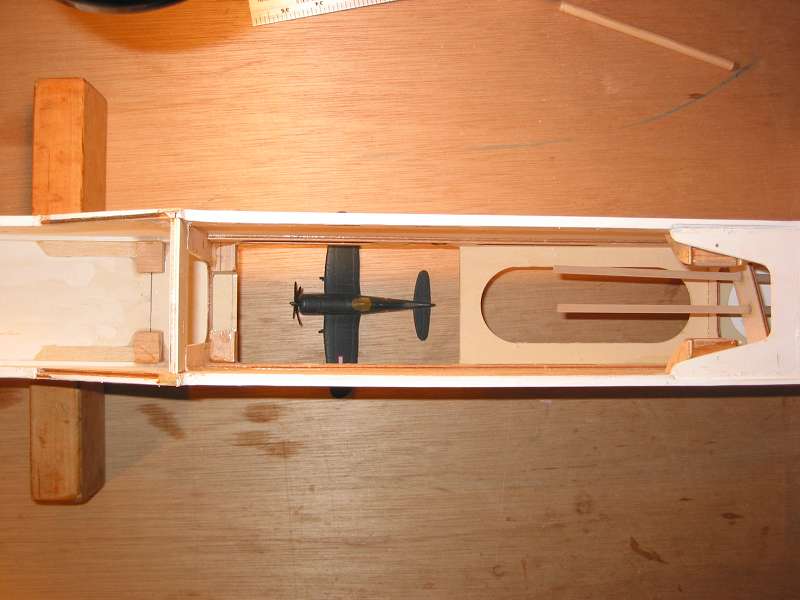

Here is a possible location for the bay doors servo. Might put an HS-81 small servo somewhere in there beside it to operate a release mechanism or something. Still like the idea about enlarging the bay from former to former. Might be able to drop the servo down closer to the bay and extend it's shaft with a 13 inch long 1/4 dia. wood shaft or so from former to former and put a plywood arm on each end of with four wires to operate the doors. I would like for the doors to be able to support some weight however. If the servo actuation was 180 degrees then I believe I could orient the linkages such that the servo wouldn't be straining from the cargo weight except initially during the drop when arms come off of top dead center to open the doors.
The gentleman had already covered the fuselage so I cut away the covering to access the control rods. I am going to use a sullivan pushrod for the elevator because of comments on the supplied rods giving subtle trim variations with temperature. The rudder will be my pull-pull initiation. Also the pushrod and cables needs to make their entrance into the cabin area much higher due to the servo tray being lifted up in the cockpit due to the cargo bay.

Farmbuyer:
Still working on the bombay thing and yes depending on the load resting on the doors you may want or need to use two servos for the doors. Useing a six channel radio you could use either the flap or landing gear to operate your bombbay doors. I use Futaba & Hitec radio so I have no knowledge of JR equipment but the difference's should not be severe. I know that one or two of the futaba servo's can be modified to operate 180 degrees. If I remember correctly Servo city has futaba s-148 servos that operate 180 degrees. Do a google search on lt-40s there are several sites that have a large number of these planes with various modification's and I know that one of them did a test to see how much the cargo wt. wise the plane could fly with for their own amusment. Your servos Do Not have to remain in the area under the wing, The throttle servo can be moved up near the firewall where the engine mounts, and the rudder, and elevator can be move to the open space in the rear it may just require a little more effort to balance.

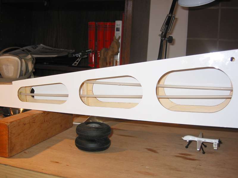

Well I finally got some free time last friday, and I needed to get my mind of some crap that was floating through, and getting me a little hot under the collar. So I spent about an hour building up a small box type arrangment, and put bombbay doors on it. It's not anywhere near perfect, but it can give an Idea on where to start. If I can get some decent pics with my digital I'll post them here for you to look at. I think you've already got a good Idea on where your going so this might just be for the fun of it. Just wanted to let you know I hadn't forgotten about it. How are you coming with the rest of your project.

Hi egor,
The first picture shows the bomb bay module built up ready to slide into place. In front on the table is the cover to put in place when the module is not installed. My plan right now is to delay any more effort on the bomb bay module until I am further along on the rest of the plane. I have installed the servos and bought an engine, a Saito .56 four stroke. this will overpower it enough that I might have to use the ailerons as brakes to get the plane down, something about CROW flight...?...I'll see, it's my excuse to learn four strokes.
On the bomb bay doors, I really want to have a single servo operate the doors from each end as in your diagram. This will require a crank that runs end to end. The servo turns the crank which operates the doors. I'll get on AutoCad and lay out the arm ratios to make this work.
The wing hold down blocks are getting in my way. The servo in the center rear is for the pull-pull rudder. One of the side servos will operate the elevator and this pushrod would benefit by not haveing these blocks in the way. I am considering cutting these out and doing it a more conventional way now that I know how.
The servo tray is moved aft a fair amount and I am wondering about my CG. The heavier engine will help compensate for this I hope.

Looks good, I think you've got this thing pretty well worked out. It looks alot better than my little demo box. I'll keep my eyes on this and watch your progress if there's anything I can help with let me know, and I'll give it a shot.
