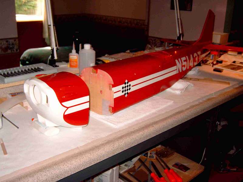

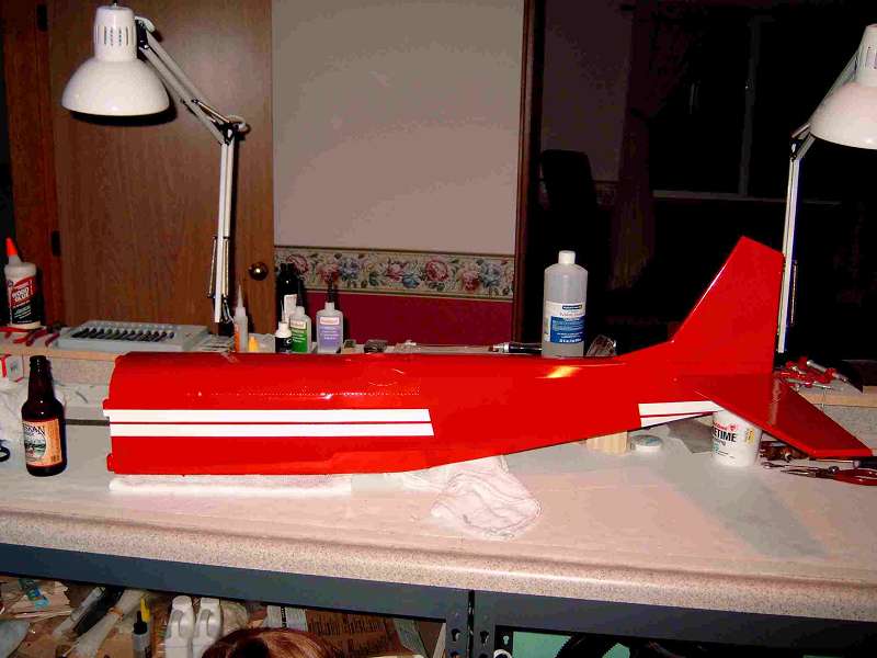

Painted the fuse over the weekend, ready for the decals. I decided to get some decal paper to make an emblem for the tail. Not sure if I want it to be the same as the original or something a little differant, but I have all options available before I clear coat the whole thing.

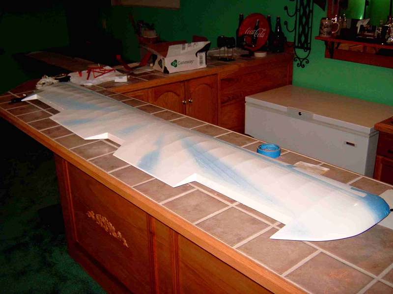

Well, the wife finally got done with her garage sale last weekend and spent a couple days afterward to restore all of the stuff she didn't sell. So, the garage is mine. ALL MINE!!!! HAHAHAHAHA.
Anyway, I managed to tape off and paint the cowl. It turned out really nice, ready for a shot of clear.
The wing is now taped and has a coat of base white over it to seal the tape before I paint on the red. Will wait a couple days for the white to get nice and dry before I paint the red. Once I am all done with these items, then I can finish my decals, and give the whole thing some clear coat.
I have to say I am a bit disappointed in the stickers that came with the kit. The numbers and checkerboards are not quite as opaque as I had thought. You can see a bit of red through the white, so it doesn't match my white stripes as closely as I would have liked. Also, they were kind of hard to apply, and getting all of the little air bubbles out from the bigger decals was kind of hard. Some of them are still there, even after *****ing and pressing them. I really wish they were water slide decals, not self adhesive.
Well anyway, here is a couple more pics.

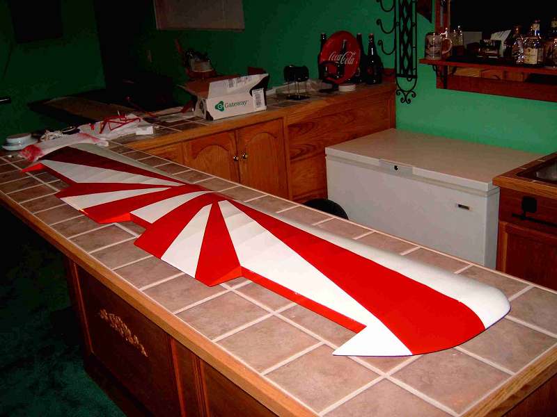

Now I am really TICKED OFF. I go back into the garage to check on my red sunburst paint job, and what do I find? A giant mosquito stuck to the red paint right in the middle of the wing. AAAUUUGGGHHH!!!!!!!!!
Now, I have to wait until fully dry, sand it out, and add another coat to that spot. grrrrrrrr..........

I get home from work, gently sand out the bug from the paint, then spray over the area again. After 6 hours I realize, I can still see the legs of the bug in the paint, and there are also a few scratches from the sandpaper. To make matters worse, this is Rustoleum, and I forgot to wait a good couple of days before painting over it, so now it has some kind of a weird blemish in the paint from not waiting long enough.[:@]
So, now I will wait a couple days. On Saturday, I will sand out the whole area, steel wool it with fine steel wool to make sure there are no scratches, then paint it AGAIN. Can any more screw-ups happen? Maybe a tree will fall on my garage and destroy the wing, forcing me to start over again.[&o]

Well, it looks like the mosquito is going to do the ol' Jimmy Hoffa thing. He is permanently embedded into the paint.
After steel wooling the area, I managed to smooth it all out, and it looks good, but you can still see a couple of tiny little legs in the paint, but hardly noticable, unless you really search for it.
I am going to wait til' this weekend, finish painting the ailerons, then steel wool the whole wing to scuff it and prep for clear coat next week. I will also be making a make-shift painting tent for the clear coating, will post pics of that too.
