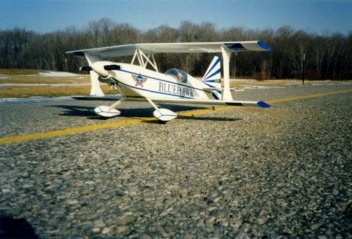

I use a single servo with dual Sullivan Gold-N-Rods. The joiner consists of a small steel landing gear strap with a third hole drilled in the center. The center hole is fastened to a ball joint and to the servo while the two rods are fastened to the outer holes. It makes a very clean slop-free system. Iv'e used it on three different airplanes with great success.
I also use a 120 with the battery in the tail. C.G. is just aft of the aft cabane.

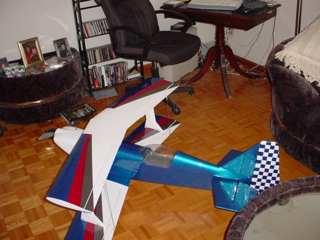

I spent a little extra money and ordered the MKD lg bellcrank from Central Hobbies and operate both elevator panels from one HiTec Digital. This setup works perfect and has absoluteley no slop. For the pushrods, I built mine from 1/8" carbon fiber rods with 4-40 titanium rod ends. Overkill? Maybe but it sure works great. This a wonderful model to fly. I power mine with an OS 1.08 with a slimline muffler. All up wt is 8.5 pounds.
