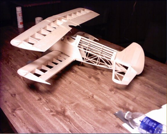

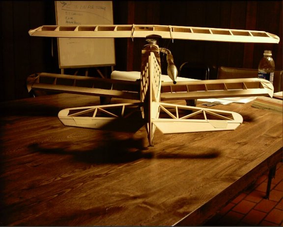

Hello all,
I am 70% complete with my Dreamer kit (wings sheeted, hinged, sanded, ready for covering). I have started to build the fuselage and am running into a problem. I am getting all the bulkheads put in correctly and have assembled the cabane struts (no mean feat!) and I'm ready to join the tail section together,....but...before I do that, how do I put in the servos!?!?!?! I have built a shelf in the A-A section for the fuel tank, which I think I can do for the Throttle/Elevator/Rudder servos, but I'm not sure if they should go in upside down or rightside up.
Also, I'm using the bellcrank system in the lower wing per assembly instructions, but I would like to verify that I can use a single servo for both cranks. I'm thinking that I can link both sides to the single servo on a cut down 6 sided control arm (the two closest arms). I would just like someones wisdom who has done this plane before. This is my first kit ( I know, I know...bad idea!). Any help would be greatly appreciated.
BTW, I have done a forum search for this information and have come up with bupkis.....................[&o]
donhef,
I am currently building this kit as well but I'm not quite as far along as you are. I can't say that I have any suggestions but I would love to hear what other's say in response to this. I agree there aren't many threads here on the Dreamer. It's an old kit that not too many people know about or have ever built. I've come across about three people on here that have built it. I too have a question for the aileron servo. I think I want to use two servos but like you I don't know whether to mount them upright or upside down. The servo will have to be very low profile to fit in the wing and have the arm line up with the holes in the wing ribs. As for the other three servos, I think you have it right. The fuel tank will go between the engine bulkhead and the next bulkhead and the servos should mount in the space above the lower wing opening. I think they will mount with the servo shaft facing down. That way you can access them once the plane is completed.
This is my second plane, I built the 4*40 as my first one and I can't imagine building the Dreamer as a first one. You are pretty gutsy. It is very difficult without having building experience. Sounds like you are doing pretty good though.
Did you use the interplane struts in the wings? My instructions said that they are not functional on this plane so I left them out but I have hard time believing that they aren't functional.
I am very interested to see what people say about this stuff.

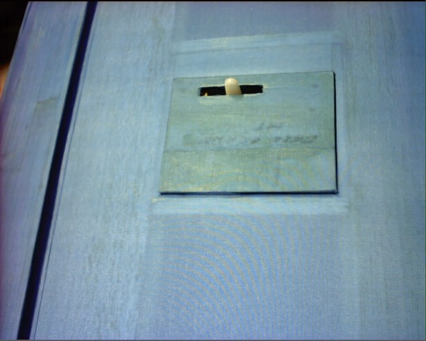

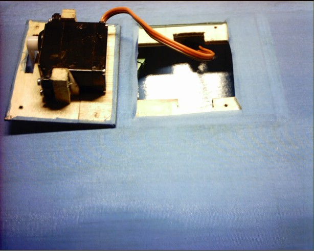

I'll post some construction pics from mine soon. I used two servos in the wings under hatches that I scratch built. Where you mount the servos depends on how you plane will ballance. What engine are you using?

I will be using the interplane struts for this one. I know that the instructions (Yeah, Right!) stated that they are of no real use on this plane, but I'm sorry, a Biplane just isn't a Biplane without the outer struts. It just gives it that look, you know what I mean? I epoxied the struts to the lower wing and built boxes around them to be able to put covering on around them.
I was sitting at the table last night looking at the fuselage and trying to picture how to mount the servos.......started to get a headache, so I backed off for a while. Then I started to look at the lower wing and that servo problem. I guess that I will just have to bite the bullet and take one of the Avistars apart to get things right on this plane.
Thanks for the help!

I know what you mean about the struts. I agree that a bipe just isn't a bipe without them. So how to they connect to the upper wing? Can you elaborate on what you said about building boxes around them so you could cover them? Don't you have to cut the struts out of plywood? They didn't come with my kit.
I thought about doing the servos like Mike said but I'm not sure how to do that. I would love to see pictures of those. That does sound easier than the bellcrank setup.

Okay, the struts are made from 2 pieces of I believe them to be either 1/8 or 1/16th plywood. You should have gotten them in one of the bags of precut parts. They are abt 8-10 inches long (sorry, I'm at work and I'm trying to remember the dimensions) and 1 inch wide. Sheet #2 will show how they are to be shaped, along with what rib to "notch" and where, although I didn't do that. I went ahead and attached them to the inside (towards the fuselage that is) side of the ribs. I used 5 min epoxy to attach them with no cutting into the ribs to make sure there was no question of the structural integrity. I then took a piece of 1/8 X 1/8 basswood stick and cut it the length of the rib from front webbing to rear webbing, slid it next to the strut and CA'd it in. From there I put on the capstrips. I wish that I could draw it out and attach it here, but I'm very limited to what I can do at work.
I was also thinking of doing the separate servos, since that what was suggested to me by some of the folks in my flying club, but just looking at the cost per servo, just can't do it......My Wife's pretty good about my hobby, but if she finds out that I'm spending more on 1 kit than on both of my other 2 planes combined, she'll flip! Anyhow, I think I can make the bellcrank system work, just have to verify that I can use a single servo and that it'll work the cranks as needed.
Hopefully, I'll have this thing done before June...I promised my Daughter that I'd fly it over her Graduation/Birthday party with a banner behind it saying Happy Birthday and Graduation to her. She thinks that would be "so cool!" Now I have to figure out how to do that...just another brain excercise.........................[&o]

The reason that the struts are nonfunctioning is that they don't fasten to anything. You build a pocket in each wing and the interplaner strut is captured in the pockets when the wing is rubberbanded on. It will keep the wings from getting closer together but if they spread apart the strut just falls out. It does look better with them on but mine are nonfunctional also.
The 555 works very well but you might also consider the electron. Same dual conversion, one more channel, less weight. I have the platnum 7s, supreme 7 & 8, superslim 8, 535, 555 and electron all work great.

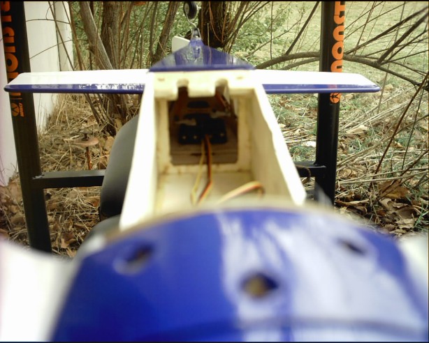

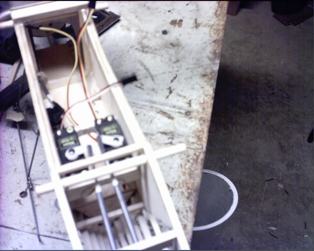

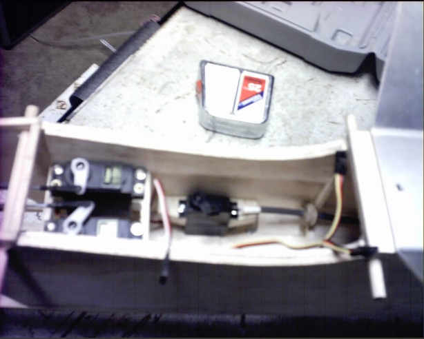

This picture shows a Sukhoi that used a heavier engine than recommended. I moved the servos to the tail to balance the plane without adding overall weight. The last two pictures are my dreamer before christmas and covering.
Awesome! Thanks for the pictures Mike, that helps a lot. I assume that everything balanced out just right with those servo locations? Did you have to add any weight anywhere? I'm pretty servo illiterate so bare with me. What is the advantage of the sub micro servo? Is it just smaller and light? I guess you don't need a lot of torque for the throttle so that isn't an issue, right? And you went with micro servos in the wing because they are lower profile? How much torque do you need for each aileron servo when you use one for each side?

That's great! Thanks Mike for the pics! That really puts the problem back into perspective.
I have gotten nyrods for the elevator and the rudder (I took the advice of the Tower site and ordered the accessories they suggested) and I'm going to go ahead and use your layout for them. For the throttle I got the flexcable to attach the servo w/the engine. That seems like the way to go w/this setup. BTW, I can get away w/using a standard servo for the throttle, right?
For the ailerons........well, since everything is already sheeted and glued, I'll have to stick to the bellcranks I guess. You said you used the 555 servos for your bipe. Those are HiTech's right? If I use 2 of them in the center of the lower wing, will each one have enough Oomph! to work each aileron by themselves? I'm still learning this also.
Yeah, I had a feeling when I looked at the plans and read the instructions that the Interplane struts wouldn't work too well unless they were attached to the wings in some sort of semi-permanent way. I figure that if I go ahead and epoxy the bottom and screw the tops that it will give more structual support for the top wing, especially when doing loops and banked turns. I don't trust rubber bands to something like this at all!

Correct! Throttle requires little torque and the small servo size leaves more room inside while the plane is still lighter. The mini servos in the wings are higher torque units than necessary at 48 oz/in. One standard servo will do (about 42 oz/in). The belcrank linkages and one std servo weighed more than the extensions and two mini servos. I have quite a number of servos and select the servos by what I have available at that time. I mainly use Dymond, Cirrus and Hitec servos. I like dymond servos because of their high torque, price and reliability.
My servo placement was derived by the weight of the engine/tuned pipe, full cowl, and the type of covering job I planned. The .46fx weighs more than the Webra .50 I installed and more of that weight is in the front because of the std muffler. Your engine will have quite a bit of power but not quite the level of this one.
The covering shown on the wing is blue supercoverite. This unpainted material flows better around curves than any film I've tried. When painted it holds up to years of use and still looks good.
You may have commited yourself to something too difficult to do. That banner will be very difficult to handle. Fullsize planes take off and then "hook" their banner for towing, then release it before landing. The larger the plane the easier this task will be. The Dreamer is not a large or docile performer. Without pretty fair piloting skills the plane itself is a handful but with the added complications of the banner it may only be crashworthy.
My ailerons were enlarged slightly rather than installing another set on the upper wing to allow snappier performance. Don't be afraid of those rubberbands, the wings are small. Trying to make these interplaner struts functional will make it harder to transport and much more hassle at the field to set up.
This plane is still not ready to hit the air but should be early in the season. I have too many planes at least this far along and not finished to focus only on this one. I must have at least six or seven air worthy that haven't seen their maiden flight yet. I can only take three or four to the field at a time.
