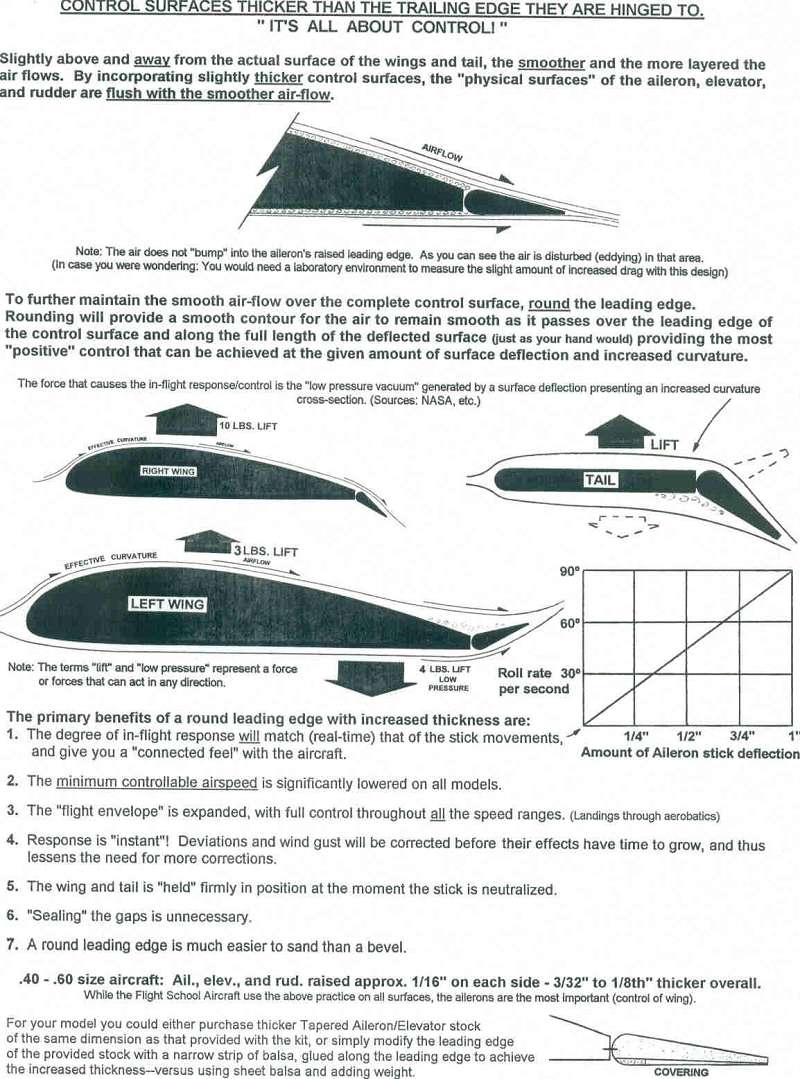

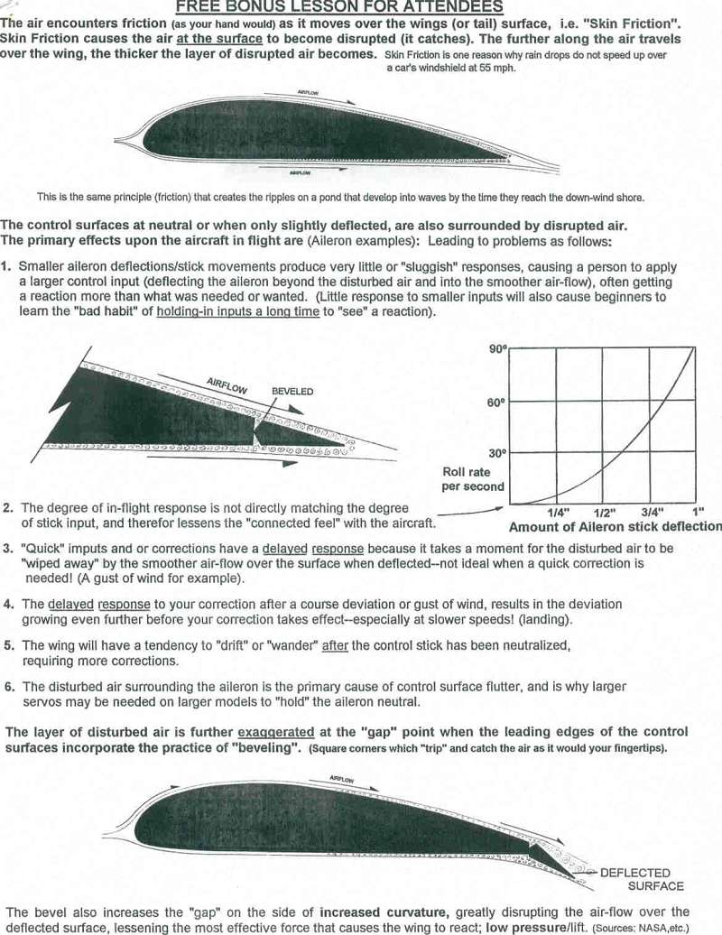

Bob Yeager's Avatar
Posts: 521
From: Lake Havasu City, AZ
Default RE: shaping ailerons
......and now for the other side of the coin:
(I got these out of sequence; sorry!)
ID:	120376   Click image for larger version

ORIGINAL: Bob Yeager
Apparently, rounded leading edge with a thicker side profile has advantages over bevelled leading edge of the aeilerons. For the rounded ones, it seems that the eddy currents build up under the gap takes longer to expose its negative effects. So, if I were to go for rounded ones, I will properly make one that looked like an oval shape than round, to lessen the effect of hinge interference during hinge rotation while achieving the advantage of round LE.
Old 04-09-2004 | 01:54 PM
Posts: 1,309
From: Ontario, ON, CANADA
What's the source of the aero info? Interesting.
