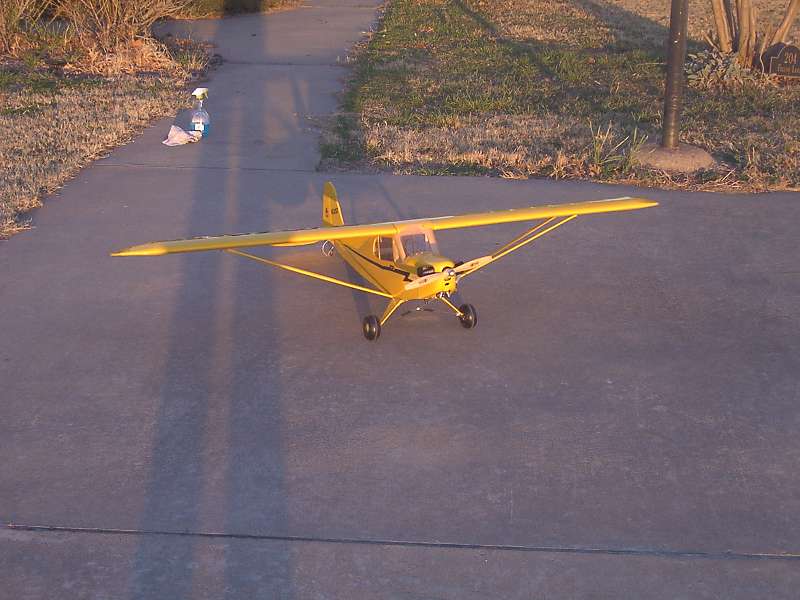

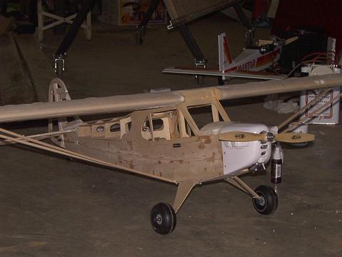

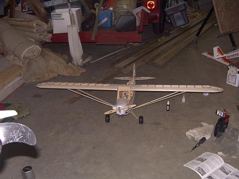

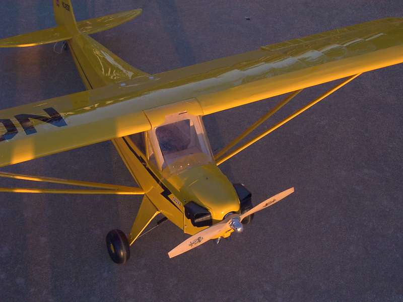

I'm thinking about building a Sig Somethin' Extra. Is it a hard plane to build or a slow one? I haven't built a kit in a few years and i've built a few ARF's since then. I've built a Goldberg Eagle 2, Protege, and Great Planes 40 size Cub. I have pictures of the Cub available:
Any pictures or comments are welcome.
