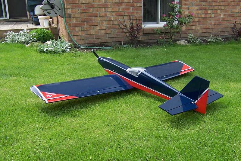

Thought you might want to see a finished product that I just completed. It has most of the modifications that you guys are discussing plus a few more. Its on a four start 60 which is exactly the same build except larger. I took the original canopy and cut it in half and turned it 180. I think the stock one is to big. I also cut off the cheeks up front and did a major revamp including encloing the engine. The plane is covered with Koverall and painted. Its hard to tell its a Four Star. What do you think?

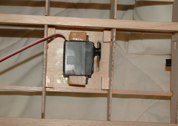

Have not yet stared covering. I picked up some 1/8" ply and made my wing servo hatch panels tonite. I also made the brackets in the wings to secure the access panels to. Also did some more epoxy glueing around places I figured needed reinforcement.

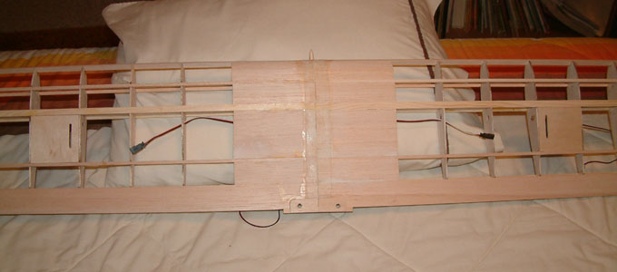

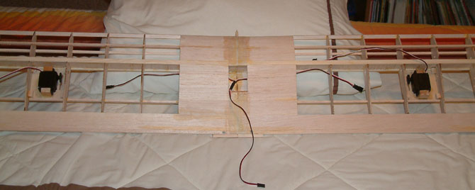

The wings servo bays and hatches are almost done. I did a trial fit and it looks great!

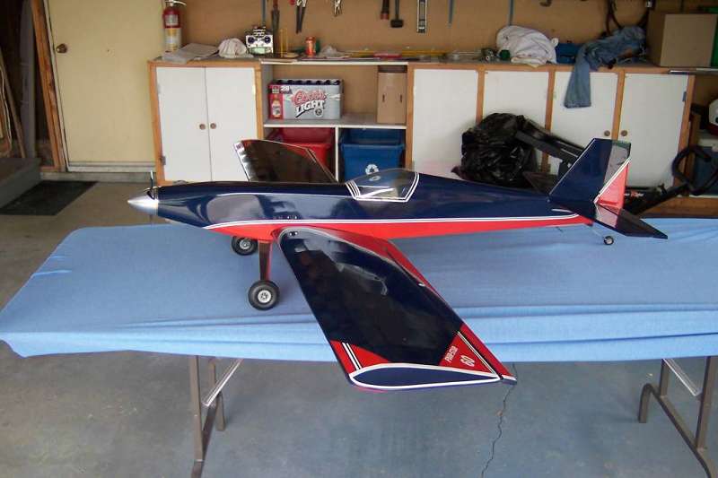

BTW Mobi. That is a beautiful 4 Star! Nicely done!!

I have some photos for you.
First is the bottom of the wing with servo in wings
Second is top of wing. You can see the servos
Third is Close photo of servo in position.
Hope it helps you!!
