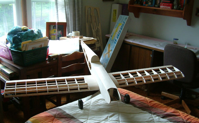

Well, after rebuilding my brother's PT20, I started on my 4 Star 40. Wing went together nicely, but I need to pay more attention to instructions. Twice I grabbed the wrong piece of balsa. No problems though.
The rebuilt PT20 and the wing sections of a 4 Star 40.

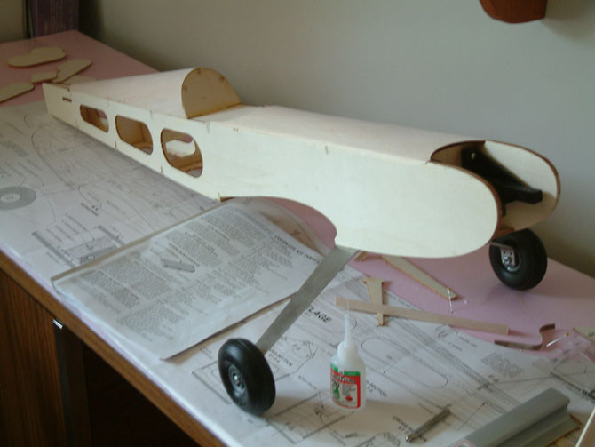

here are some pictures of mine during construction.
http://www.galip.net/Sig4Star

Well both the right and left wing are done. NO more mistakes!
Any hints or warnings for the fuselage?
Thanks!!

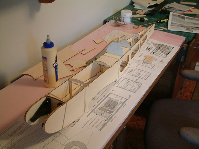

You might want to reinforce the fuse area behind the TE of the wings with some triangular stocks (for those bad landing days !)
Also, you may want to consider enlarging the rudder by an inch for better knife edge performance

CA the tri-stocks in all four corners, in the first (and second if you wish) bays behind the wing.
Another suggestion is to build the turtle deck after you install the wing, to make your life easier !

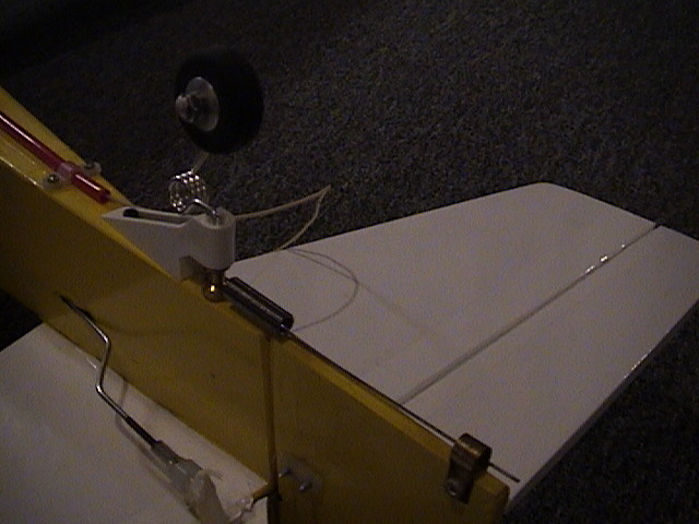

Well, joined the wings today. If that isn't a hair-raising experience. It match up and turned out pretty good. Found out I had to sand alittle bit more of the LE to match the fuselage. Pictures soon.
OH! And finding where to put the engine mount either was no picnic. I had no idea about the thrust line, but I looked it up here in RCU and found out many others have asked the same question.
Clear Skies!

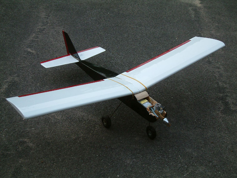

I joined the fuselage to the wings. Yea, drillin the ole nylon bolt holes! Lots of fun. Found out my measuremests were off 1/8 a degree from wing to wing from the back of the fuselage. I put a turtledeck on her. She seems pretty solid. Next are the tail feathers!

Looking good Ed !
Old 06-07-2004 | 11:38 PM
DrFun's Avatar
Joined: Jul 2003
Posts: 635
From: The Woodlands, TX
Default RE: 4 Star 40 building has commenced!
Looks great, you will love the 4*

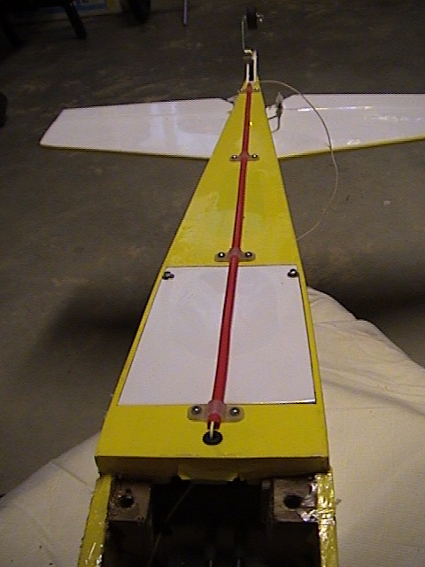

Swager,
While you're still in the early stages, here's some mods I made that may help you out:
-- Access panel in the rear bottom fuse for battery (balance)
-- Wire supports from cowl cheek to landing gear
-- Pushrod tube along bottom of fuse for Rx antenna
-- Sullivan tail wheel (nice!)
-- Run Rx antenna thru servo bay with rubber servo grommets (or a length of fuel tubing); keeps the rx off the servos/wires.
-- I also run two batteries with separate charger jacks/switches. Plug one into the regular battery plug and the second in an empty channel. They don't have to be matching mah, just voltage. THis not only gives you extra flying time without switching out batteries, but you can also mix them up for balancing options. Better to to balance with something useful instead of useless lead!
You can also fit a 10-11 oz tank in the front if you move the bottom tank support; also a good time to thing about an access panel for the tank.
Have fun.
