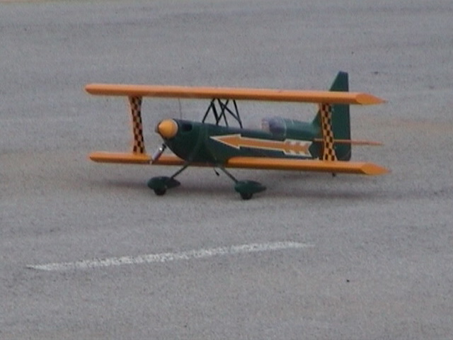

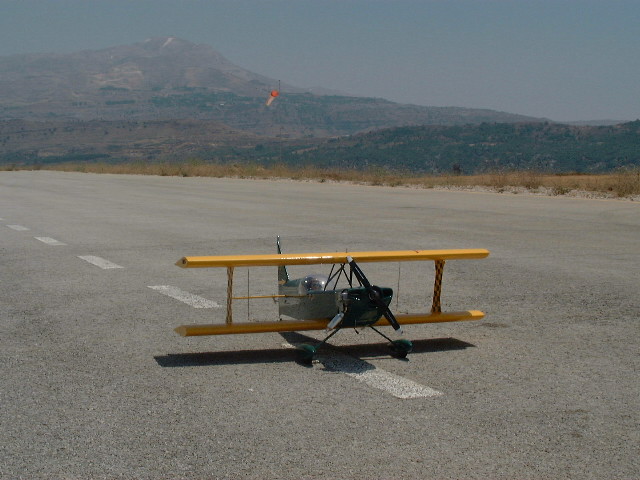

I have about 10 flights on mine....
Awesome plane, it really glides!
Used two servos for the ailerons ...and OS .72 FS engine
Casted a Fiberglass cowl and pants.
Check it out
Hisham
