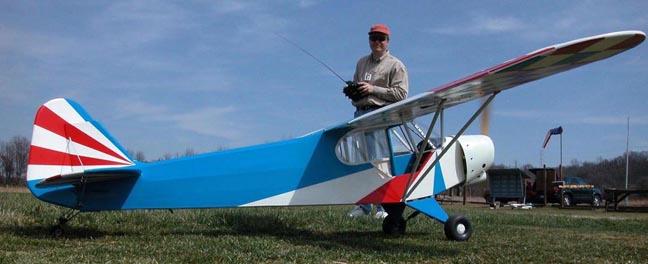

plans say...
rudder 1 3/4 inch
elev. 1 3/8
ail 2" total

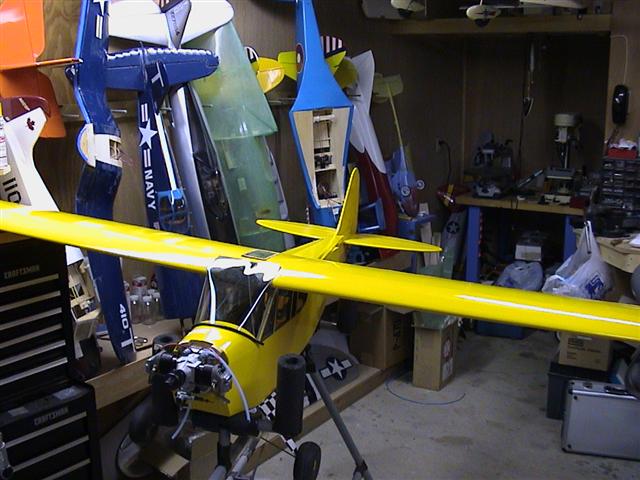

I have a Sig 1/4 scale clipped cub with a powerful gasser up front that I have been flying since the first of the year. It depends on what type of flying you want to do, but if you want a fairly acrobatic Cub.... this is what I have done.
Max out the ailerons and rudder for maximum movement and then use your expo to dampen the smaller stick movements. I think my expo is at about 50%. If you are careful... I even do this on the elevator. Mine snaps great and right now. Stall turns and flat spins are great with the full rudder. The rolls are pretty good with those barn door ailerons.
The safe way to go is with the above setting on your high rates and the conservative settings on your low rates. However once you get used to the high rates you will never switch her back. Attached is a photo of mine.
