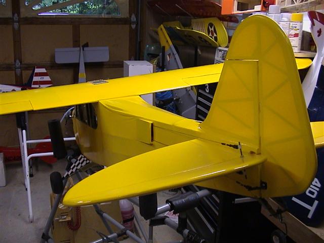

hi rc, i am finishing a 1/4 scale sig (i clipped the wing to 89 inches) the rec. throws in plans say
rudder= 1 3/4
elev= 1 3/8 up and 1 3/8 down
aileron= 2" total
pics of mine are below i did a few changes like p/p on tail controls.
-Tinman-

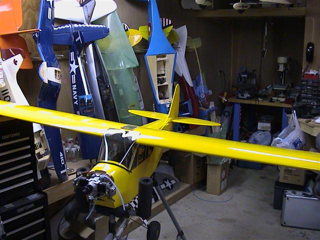

1 more
