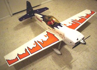

i found a couple rolls of monocoat in a metal storage
shed. it was from my wife's father that past away years ago.
the film was probably 20-30years old...who knows? about 6-12" of the stuff
was wriggled, but the rest was still good. i didn't have any problems
with the film. higher heat for MK of course. this is what i did with it.
the white stuff was the old MKstuff.
the dark is mettalic is MK
the orange is tower ..becuase i can laid it on film with low,low heat.
i used the solvent seal stuff for the edges of the scheme.
it took me forever to cut the dark trim around the orange.lol
i use a piece of glass from an old stereo console as a cutting board.
the knife don't dull easily... it glides
covering is the most fun part of building.

Haha, no kidding! Dulls blades really fast! I mentioned before that I was going to post pics on Saturday, but I ran into two problems. First, two of the USB ports on my computer stopped working so I couldn't use the flash card reader. This is an interesting problem as I've been in IT for >5 years and haven't yet figured out why these ports just suddenly stopped working!!! Second, I worked from 7pm to about 11pm on Saturday to just get the rudder and elevator covered! I had no idea it was going to take that long to do such work. I must say though, those videos from the p-38 review really helped me when I got to the wing tips. Although the tips of the PT-40 aren't as curvy as those in the video, they're rounded enough in two directions that I would've never gotten past them without that help.
So far I've managed to cover the top of the wing, top of the h.stabilizer, both sides of the v.stab and the bottom of the fuse. Boy, that v.stab was a pain in my ***** I tell you! But it came out pretty nice. I screwed up and coved the h.stab before I had put the v.stab reinforcement triangular blocks on, and subsequently left too much material around the reinforcer's edges and it made small wrinkles all over, which disappointed me due to the fact that I had taken such care to cover everything so neatly. Wife says it looks awesome, though. I think she's being nice
Good call on pulling off some work. I had decided on a color scheme that would overlap colors on the leading edge of the wing by about 4" before the edge. Before realizing I was making a huge mistake I started to put monokote over the top of other monokote with a 4" overlap. I got about 2" into it before seeing what a hideous, air-bubbled mess it can make. I pulled back on the top, cut out the 4" to the leading edge and started over, it's working out quite nicely.
I'm nervous about, and hoped someone would have suggestions for the fuse lines. I'm planning to make the bottom white with the top 25% of the sides and top blue. I also wanted to make a black pinstripe down the sides. I don't know that I'll bother trying to make windows, but it seems a shame not to have that definition. I figured since I've already done the bottom (as directed by the kit instructions) I would do the sides next, working with a strip of white to about .5" from the top, then a strip of blue covering just up to the top edge. Then I'd cover the top and top corners with the blue. This will let me work with a smaller amount of material to make the white/blue line down the sides. I plan to cover the line with black pinstripe and accent it again .25-.5" either up or down from there.
I still have the bottom of the wing, ailerons and bottom of the elevator to go before I get to the sides/top of the fuse so I have some time to plan.
Even after that, though, I want to make those stripes and sunburst pattern such like yours, Mark. I hope you have some suggestion to make the trims even on both sides, while also getting the same angle? I've thought to make a large rectangle of material, with each end being the final width of the sunburst. Then drawing a diagonal line through lengthwise corner to corner to make two, identical sunburst 'rays.'
I now know why people say that blood, sweat and tears go into this work. I've poured plenty of sweat into it, sometimes getting on my work, and last night I poured blood into it...I was going to cut a small slice of material for the v.stab triangular enforcements. I had them measured out, ruler down, and it was a small piece of covering. I didn't want it sliding around so I left my hand on the ruler and reached for the blade. You might think, and have probably done this a few times, that I ran the blade over a few knuckles or finger tips while cutting along the material. Nope, instead, when I grabbed the blade it was upside-down! I put the tip on the table, just before the material and pushed. Yup, gives me the heeby geebies too [:'(] cause I can still remember the feeling of the blade slipping into my finger tip like a hot knife in butter. Had to get the wife's help on that one, so now I'm limping along without an index finger tip to use (which is quite annoying, especially when you do even a fraction of the typing I do on a daily basis in my job). It definitely has slowed me down a bit..
So that's covered two of the three requisits and I suspect plenty of tears of joy will be expunged when I first fly 'er, and then again when I first crash

I wanted to update everyone. My finger is almost entirely healed, but there's still a small ravine I guess you could say, where the cut once was. I took the bandage off over the weekend while in Maine on vacation, it was driving me nuts, and it was a good time for it anyway
I'll let the pictures do the talking...as I mentioned before, my attention to detail isn't quite right. The ailerons are going to stay yellow, as well as the elevator.
I finally got the hang of those stripes. I did use the windex trick, but I didn't let the tail stripes dry the 24 hrs. Instead, since they're at absolute max 2" wide (and that's beyond the tail edges, so they're probably 1.75" or so), I squeegeed out the windex and made sure they were on nice and flat, no bubbles or anything in between the two films. I think the solvent might work really well in this case, no ironing, no windex. Not sure though. Anyway, after I got it all flatened I just ironed very carfully. I didn't do this on the wing stripes, they're much wider and pass over open bays so ironing wouldn't work and the heat gun would've just made a mess on something like that. So here are there pics. I haven't finished the top fuse yet, as you can see...
