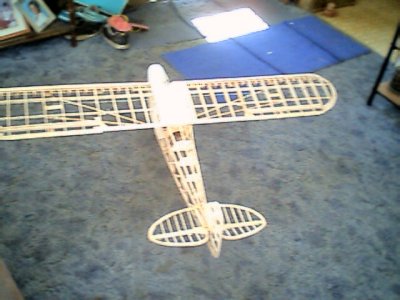

heres a couple pics i just snapped real quick, if you wanna see something in paticular, let me know, i have all the main building done, all thats done left is mount the engine and carve the cowl, glue in the windows, cover it, fine tune the servos, put on the wheels and collars, nothing really major, just all those fun finishing touches, i'll be sure to add some more pics as i progress if your interested

NIce Cub
By looking at the pictures, I see that you have no dihedra, that is an angle between the wings, seen from front, but an anhedra! I suppose the plane is not completely finished and the wings were not properlu fitted to the fuselage. However, with THIS model, you have to be very carefull as to how you set up the struts to have a little dihedra, otherwise it will be a bear to fly and would be rekitted in no time.

the wings arent attatched in the pics, just set on there for the pictures, the struts arent screwed in either, i have a brat .28 engine im gonna put in it, i know it sounds small, but i like to keep my planes light as possible., you seem to know a good amount about this dihedral (spelling?) what should i have it set at? i have never really messed with that before, just gimme some tips or what they should look like..
thanks.

ya know.. i was looking at some electric cub and im not sure if there is one... lol im sure there is and i cant see it but if there is its gotta be what 2-3 degrees? if that? i duno heres the pic i used as a referenc

Cubs have very little dihedral. I am sure when you joined them they are set at about the angle you need. All looks well. I just wonder about the Brat though. I have heard a lot of mixed bag about them. Good lord I havn't seen one of them in over 8 years. I hope it works well for you. Be sure it is reliable before you fly it. Good luck.

From what I know, Cubs have about 1 to 2 degree dihedra! Does not seem much, and is almost unnoticeable. BUT it increases stability. The best thing to do is to take reference from your plan.
