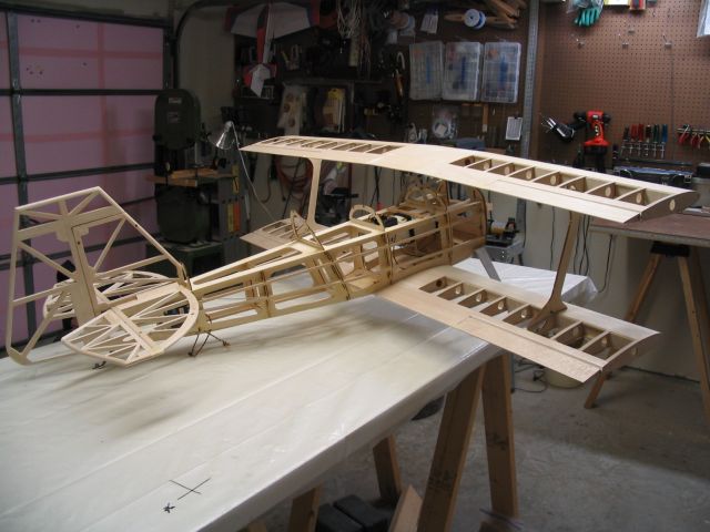

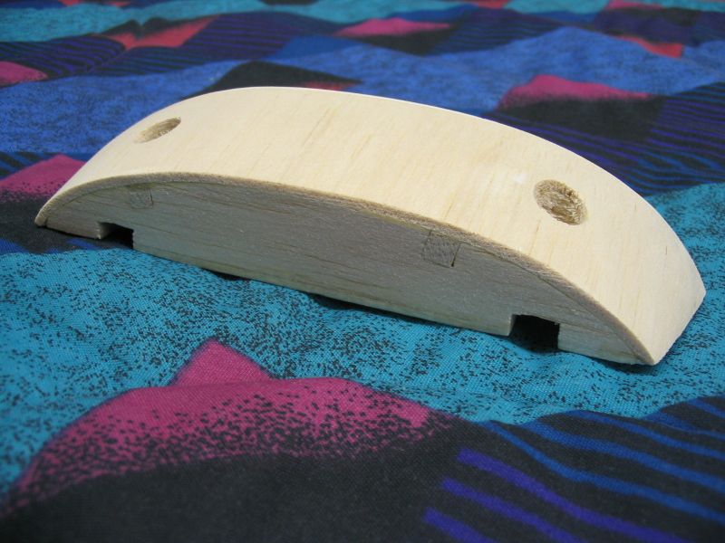

Got a couple more days of building in. Radio placement is roughed in.
All the surfaces are bevelled, hinges are fitted. Gear and tank are mounted.
Recommend the top formers and top/side stringers be left out until the very end.
If you follow the sequence in the instructions, this stuff just gets in the way for no good reason.
When I get back from the holidays, focus will be on mounting the engine and cowl.
I'll post more pictures when I get closer to getting a trial balance.
Hope it flies as good as they say. This one is a lot of work. [X(]

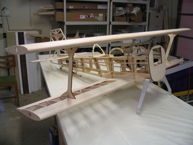

I've been working real serious at this since I got back from the holidays.
Everything is installed and adjusted. At this point, this is a fully functional aircraft.
Plane is now ready for final sanding, covering, and paint. (I hate surprises once the finish is on)
Weight will come out at about 13lb. CG is just about where it needs to be.
Redrata, I will post pictures of the engine installation when I take the cowl off.

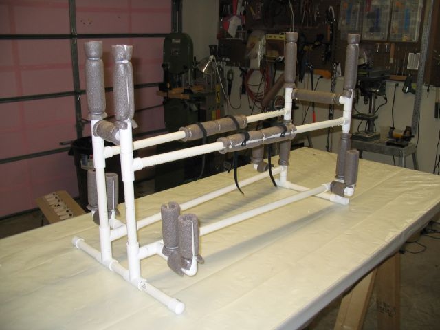

I now make it a habit to build PVC transport stands for all my planes.
That way, everything has a place to go, and the model doesn't get banged up in transport.
Having all the small parts well organized should help speed along assembly at the field too.

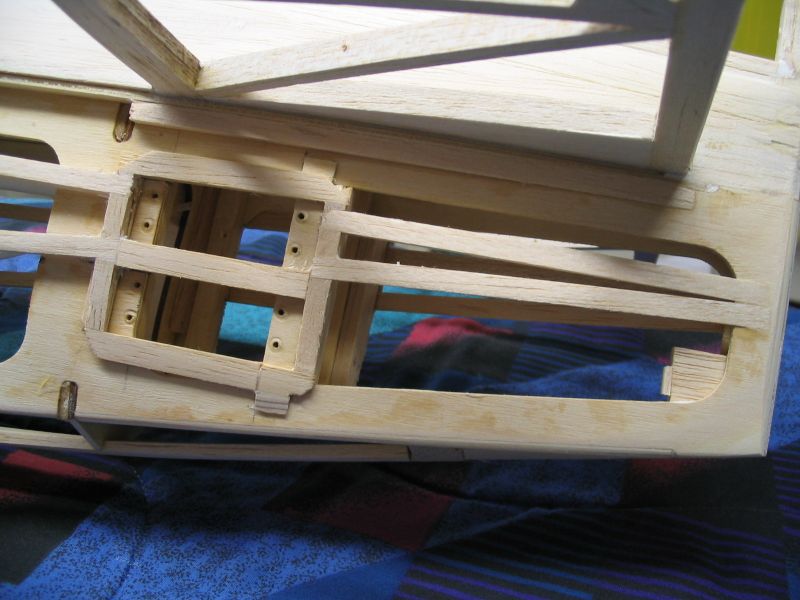

Hey Marty, can you get me a close up shot on your rear servo install and how did you fill in the landing gear mount area?

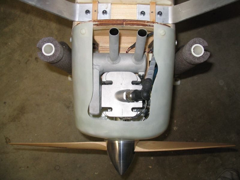

Redrata, some engine pics for you.
BTW, muffler is a J&A peacekeeper.
ORIGINAL: Redrata
If possible, please, post a pic of your Brisson when installed, I will enjoy to see how it looks. Thanks.

ORIGINAL: rc-sport
Rear servo mount is built using vertical rails in aft fuselage side cavity.
Mount the servos and double check clearances. Shim with scrap ply to space servos outward.
When installing side stringers, anchor the stringers at edges, cut excess to clear servo cavities.
Then build up around servos with 1/4sq balsa. Sand/taper everything to fuselage contour.
Idea is for covering to look smooth over this area, even though there are rectangular holes in there.
Both sides are identical. Lower cavity (rudder servo) will just be left covered up on one side.
Landing gear fairing is just a hollow balsa box I improvised in place. Weighs next to nothing.
Mounts using two #4 capscrews into spanwise rails over the main gear.
Look closely at my earlier cowl bottom picture to see how it fits together.
Hope this gives you some good ideas. Post pictures of your creation when done, OK?
