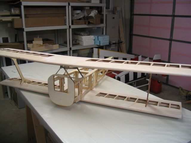

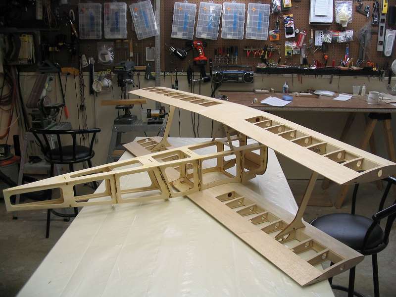

Mine is coming together smoothly. I have about 45 hours labor into it at this point.
Everything is framed up, aligned to +/- 1mm. It's downhill from here.
Anyone else putting together one of these?
