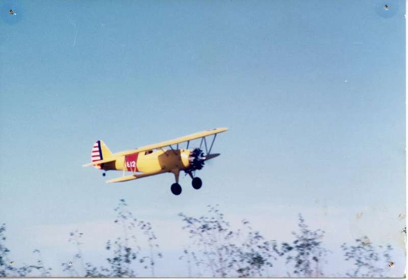

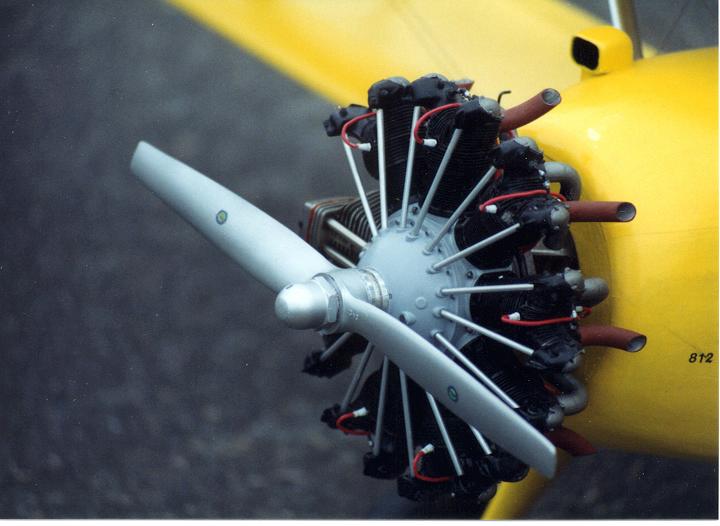

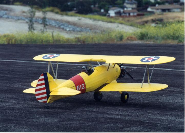

I recently took possession of a Sterling Stearman about 90% complete. I'm wondering how to finish off the nose - Dummy radial engine or aluminum cowl (or both?).
Could you owners of this model post a picture of the finished product to help in my decision making? I would very much appreciate this!

It just ain't a Stearman without the radial engine hanging out there. Here are some photos of mine. I used the plastic engine that comes in the kit. This plane is still flying after 15 years, and the dummy engine has held up well. I did reinforce it with expandable foam inside the cylinders, and dowels cemented between cylinders to prevent flexing.
OS 91 4 stroke for power gives very scale flight, but it is a heavy plane with lots of lead in nose for balance. Probably would be even better with a 1.20. If you balance as per plans it will fly well. Just don't be surprised at how much nose weight you need.
Mine is covered with combination of super coverite which is painted (yellow surfaces), and Permagloss (pre-painted fabric which is no longer available).
If your hinges are pined you can cut off the ends of the pins and separate the surfaces for covering repair.

Personally, I would not profane the poor beastie with a 2 stroke. Mine flew quite well with a pre-surpass, used and worn, OS 91. I worked a lot lightening up the tail surfaces and wing, and with Robart struts, it came in at 13#. The dummy engine is Williams Brothers.

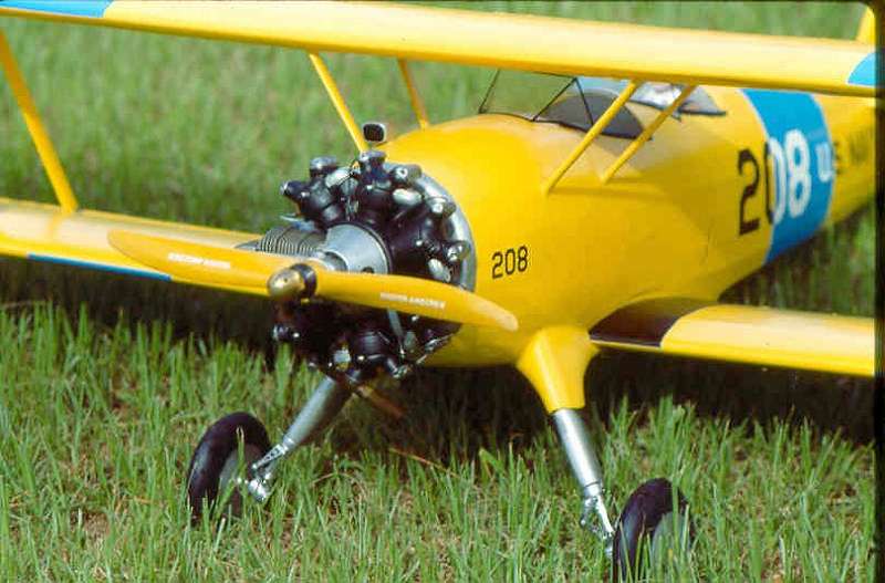

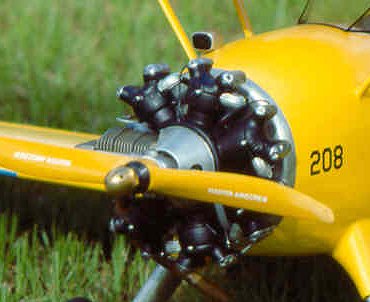

Thank you too for the pics, Les. I've done searches and haven't come up with much, hence my request for pictures. Did either you or Ernest cover the planked area on the fuselage, or just the ribbed area and then seal and paint the nose section?

I would definitely recommend covering the whole thing all the way to the firewall. Otherwise you would have to glass the front and paint. A finished fabric covering like Solartex (Worldtex, Colortex) would be easy, and really looks better than plastic on this bird.
I agree with Les that this plane begs for a 4 stroke as do most biplanes (this is a nice project for a 91 4 stroke, or the Saito 100, or even an old used 1.20 that you could find fairly cheap). A 4 stroke lets you swing a larger prop which helps the prop clear that wide nose. I suspect you could fly it on a 2 stroke, but it would be harder for me to pick one. I think a 60 would be too small (at least for the way I like to fly). Maybe a 90?
Les also brought up a good point about lightening the tail. If you can, I'd recommend lightening the tail as much as possible before covering. An ounce saved in the tail, probably equals 5 or 6 ounces saved in nose weight on this plane.
As for the hinges, I thought you meant they had a pin through the hinge line. If I'm reading you right someone built the plane then permanently hinged the control surfaces before covering. If this is the case, I'd recommend cutting the hinges, covering then re-hinging the surfaces. It will save you time in the long run. You could use Robart Hinge points, hinge next to the existing hinges, or remove the existing hinges and re-hinge in the same location.
I also recommend the Robart Struts for this plane. Really cool. My photos show the Robart plastic strut covers, but I later added the real stuts to my plane also.
