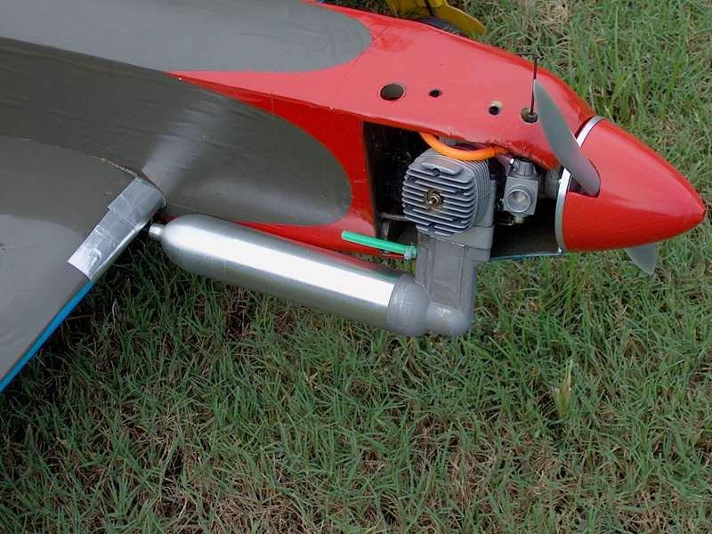

I mounted the engine in my 4*40 at about 45 degrees so the muffler would clear the side of the plane and then build the cowl around it. Here what it looks like.

This may not be a problem, but if you are using the standard muffler, make sure it will clear the gear. The 4* probably has a nose long enough so this won't be a problem, but it never hurts to check.
I side/angle mounted a .91 in a 4*60 modified and cowled. Worked great. Turned out fast.
The muffler shown is a Performance Specialties Ultra Thrust tuned muffler.
