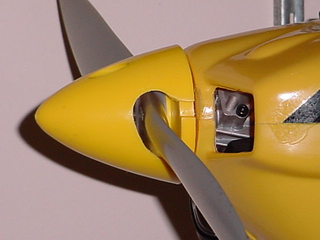

I could not fit my 2.5-inch Dubro plastic spinner on my 11x7 APC propeller and it was a real hassle to file the spinner ! Is there a plastic spinner in the market that can fit APC ? Thanks guys !

A Dremel tool with sanding drum makes short work of enlarging the cut-outs to fit a larger prop.
You used a FILE? Jeez; no wonder you're aggravated. That would take forever.
BTW, I would stay with DuBro. Now that Goldberg stuff is difficult to come by, the DuBro is the best plastic spinner available IMO. Stay away from the SIG on a powerful four-stroke. SIG spinner faces are held only by the two screws; these won't take the torque of a powerful four stroke. The Dubro, like the Goldberg, has four stout pins in addition to the 6-32 bolts/locknuts. Plus, you don't need a hammer to install it or a pry bar to get the face off, like you do with the Goldberg.

Steve, could you post a photo of what your cutout looks like after Dremel sanding ? I am not sure if the sanding drum can fit my 2.5 inch spinner cutout. Thx..............

Sure.
This a Dubro 2.5" spinner, cut to fit an APC 16x6. I had to remove a LOT of plastic. But if you're careful to enlarge the cut-outs equally on both sides, and only remove as much material as necessary, the structural integrrity of the spinner will not be affected.
I used a standard (15mm in diameter) Dremel sanding drum with coarse grit. You'll be there all day if you try to use the smaller one. They only come in two sizes, that I am aware of.

Here's a shot of the other side of the cut...

Steve, your mod looks great! Very nicely done ! Thanks a lot for the pics and instructions. They give me a clear idea what to do. I don't have a Dremel but I have a RTX with the same size sanding drum. I'll go ahead and use it but wish me luck as I have only one go at it (no spare spinner).................
