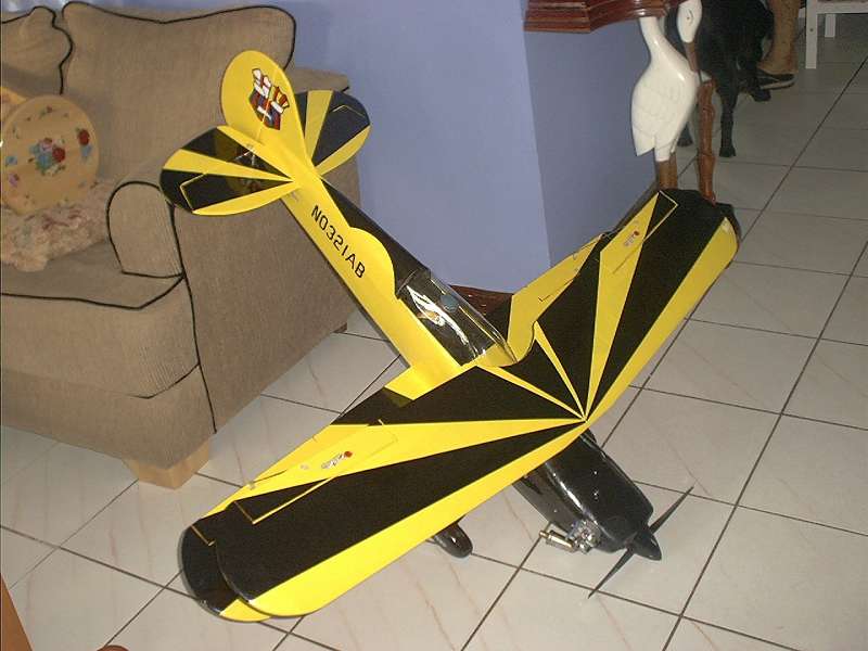

Old 01-21-2005 | 09:26 AM
Joined: Aug 2003
Posts: 30
From: Manchester, TN
Default RE: GP Sky Bolt is HERE!!!!
Has anyone had a problem with the two bottom wing halves not lining up when the top wing is mounted to the fuse and the fuse is turned upside down? When when the two halves are layed in place, the wings are swept forward 1 degree.
Old 01-21-2005 | 10:11 AM
MinnFlyer's Avatar
Posts: 28,519
Received 9 Likes on 9 Posts
From: Willmar, MN
I didn't have that problem, but I would just sand some of the Leading edge where it hits the fuse to correct it.

I've had my Super Skybolt for about 2 years. It is a beautiful airplane. I guess I don't quite understand your description. I remember that the outboard wing cabanes (I guess thats what you call them) were not fully seated when slid home but that seems to allow for some slop. After I got the bottom wing finished and bolted in place with the top wing. I had to shim a bit under one fuse wing root to make it fit tight.
I think you have to bite the bullet, glue tham together and start fitting.
My incidence came out perfect (dumb luck maybe). I have an OS 120 in it and still have the ABS cowl and pants. Unlike my Goldberg Extra 300, The ABS cowl has not cracked and still looks great. I did line it with glass cloth and resin.
The only thing I don't like is that I will probably have to cut the fuse apart if I have to remove the fuel tank.
You will love it when you get it flying.
Good Luck,
Bob
Old 01-21-2005 | 05:21 PM
Joined: Oct 2004
Posts: 31
From: Bedford, TX
This is the first time I used this. I tried to upload a photo for moral support. I'll try again.
Bob
[img][/img]

That is a BEAUTIFUL Skybolt Bob.

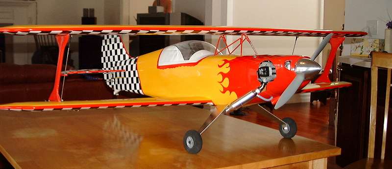

Old 05-11-2005 | 10:07 PM
Joined: Jul 2004
Posts: 28
From: Garden City, TX
Hey Guys! I just got my Skybolt finished and flew it for the first time today although the wind was blowing. I put a Saito 100 in it and although it pulls it well, it only weighs 21 ounces so I had to add 14 ozs weight to engine mount. With the extra weight, the plane weighed 9.25 lbs. I plan on adding smoke as soon as I can. Im not sure where I can put the smoke tank as the CG is so far foward. Well anyway heres a pic........
ID:	270236   Click image for larger version
Old 05-12-2005 | 05:15 PM
Joined: Apr 2005
Posts: 293
From: Boise, ID
JunkMan,
The only thing I would offer after all of the other great suggestions is watch the weight!!! The fus. builds heavy and I had to add about a pound in the nose with a OS 91FS up front (built it to plans). There are some great threads on how to lighten up the plane.
