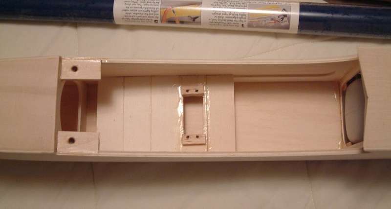

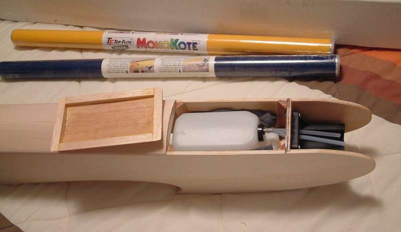

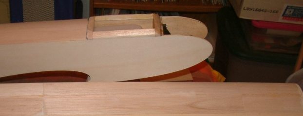

Well i finished the aft end of the fuselage and the fuel Tank Hatch. It turned out alright. Made the horn hole in the rudder and elevatora nd aligned then. Next is to fine sand and slot the control surfaces. Then..........
Cover!!!
Oh Boy!!
The servo platform in the fuselage only needs one placement for a servo due to I am mounting the rudder and elevator servos aft. The receiver and battery will be secured to this "platform" I wont permentantly secure it until I do a CG test..
Can you tell from the photos which colors I am going with? Also going to add some white!

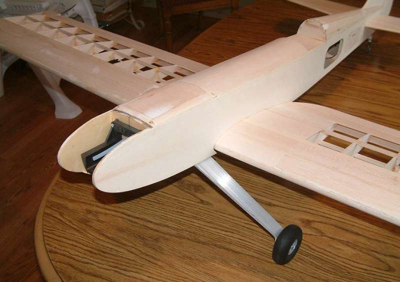

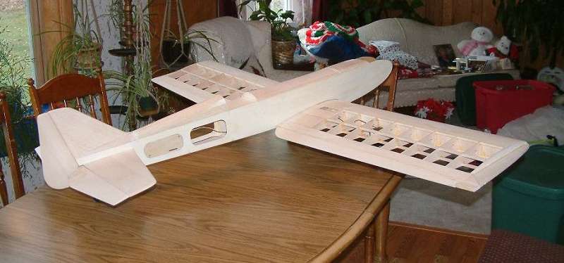

Well, I got it all together with no skin. Covering is next. I have to do allitle bit more sanding and then I can cover it.

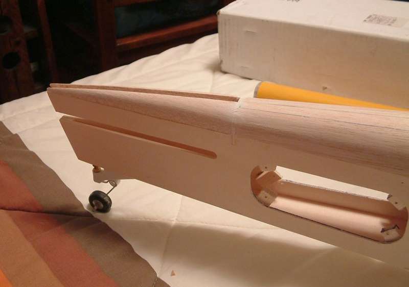

I use CA hinges. They are simple and work well for these types of planes. I used 4 pieces of 1/2" square balsa to "frame" the fuel tank hatch, then put in a piece of curved 3/16" balsa sheeting to top it. Sanded to fit.
I think I have some photos. Look at post #29 3rd photo.
The photo is of the tank frame. I intially carved it to close fit, then sanded it down.

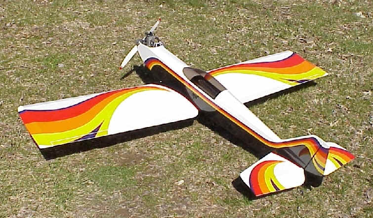

Default RE: BTE Venture 60 build has Commenced!

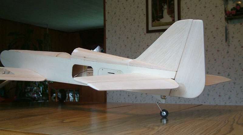

You're going to like this plane! I built mine a couple of years ago. Stuck the servos in the rear and a Saito .91 up front and had no balance problems. I also placed the aileron servos in the wings. Here's a pic of it.

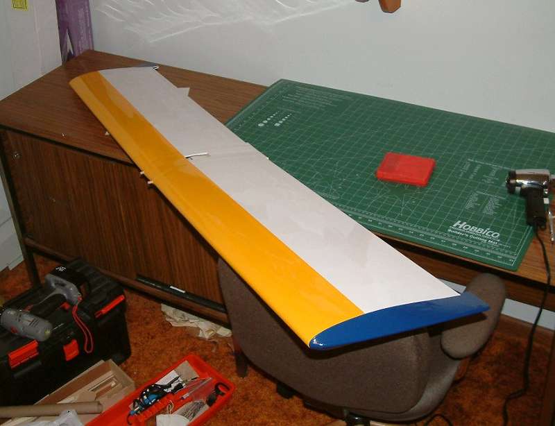

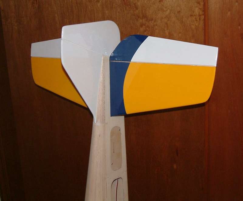

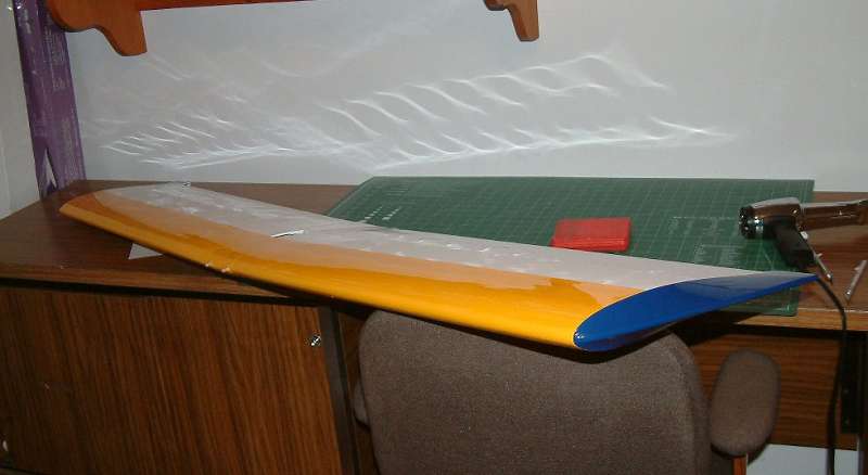

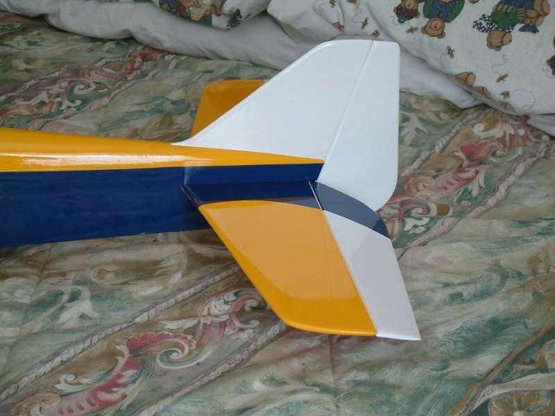

Well I finally got to some covering. It took awhile for me to come up with a scheme. I figured it would be a nice scheme but I am part way done with it and I really dont like it. I guess I'll have to wait until it is totally finished. I just wish I was more artistic!
I have some insigna blue to put on the wings, but I haven't decided on a pattern yet. Someting close to the pattern on the tail.

Im using Monokote. I am actually getting better at the covering stuff. I just did an airelon the insignia blue color. Then I have to make a pattern scheme for the wing and the bottom. I still have to paint the engine compartment. ITs moving along.

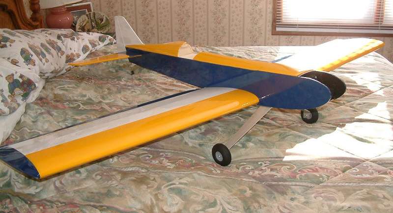

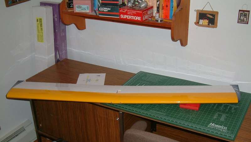

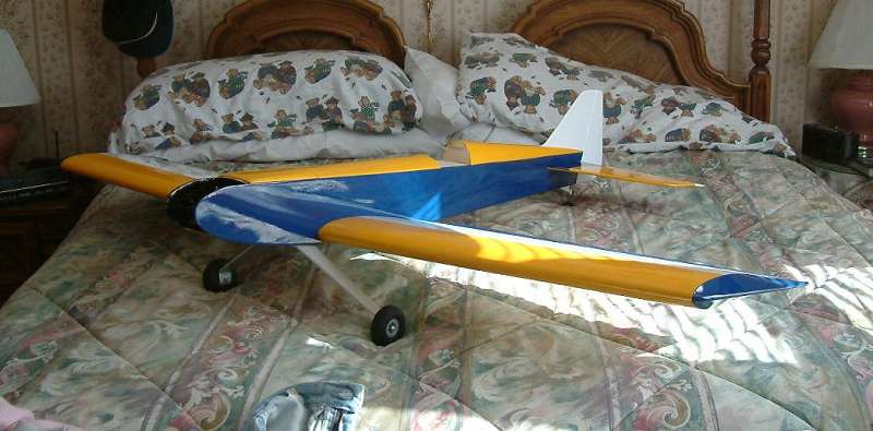

Well I covered up the fuselage and attached the aerilons. I forgot to put in my ON/OFF switch! Whoooops!!
I put in the fuselase servo hatches after these pictures were taken. It is turning out OK, but a couple mistakes on the covering.

Lookin' good, how does the wife feel about the venture takeing her place on the bed? lol j/k. i like the scheme you went with on the tail.. don't think i've ever seen it done..
Dwaine
