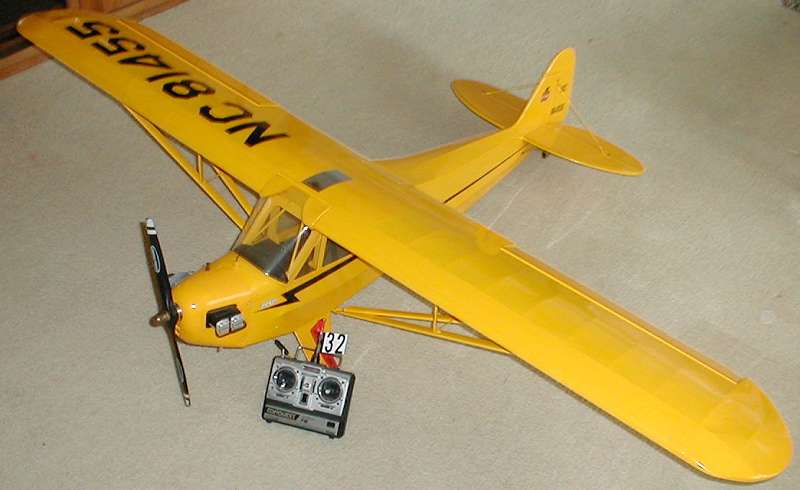

Here's one I was flying with an OS 91 Surpass - plenty of power - make sure you mix in more up aileron than down - adverse yaw -

Ron-
Yours looks a lot nicer than mine! I can see you went all out with the scale details.
