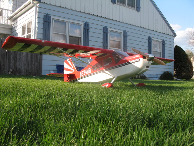

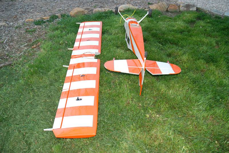

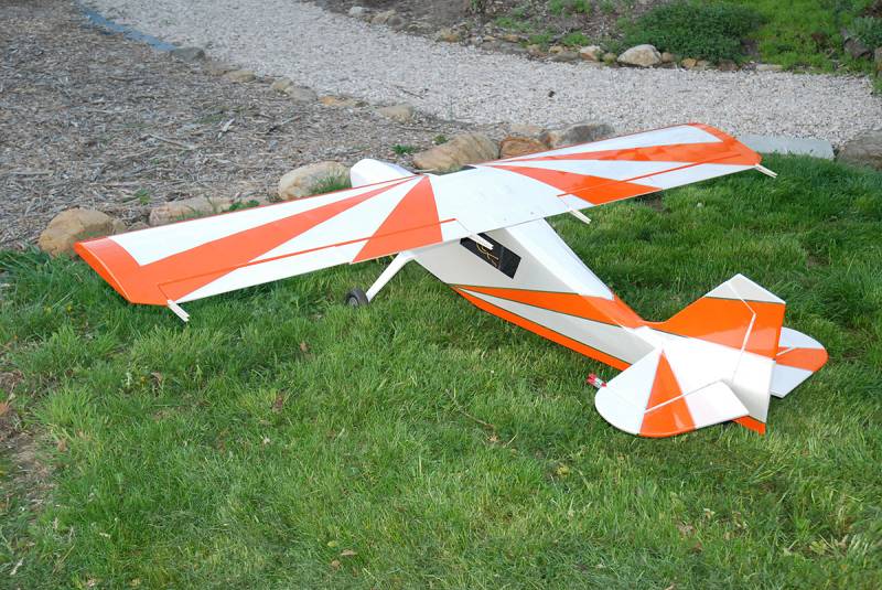

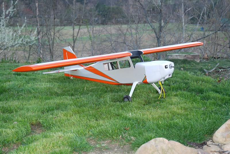

YeeeHaaa!! I now officially have a ARF! The covering is finished. I still need to paint the cowling which will be a continuation of the orange triangles.
It doesn't show in every photo very well in this light, but all of the white has chrome trim around it. Thanks Stevo for getting ahead of me as I was concerned about how this would look on the tops of the wings. After seeing your photos, and for me then thinking in terms of going around the white... I decided to do it. It was really the easiest part of the covering job and to me it does set it off nicely. Three colors is almost always better than two.

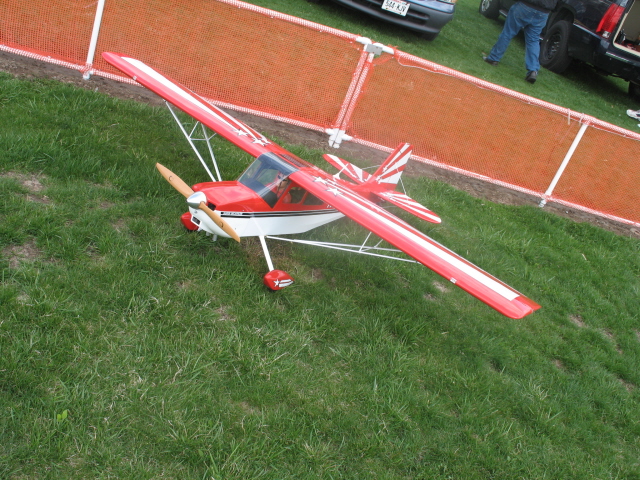

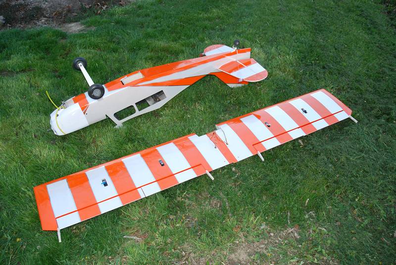

All! I got it in the air! And it came home in 5 pieces! 1 fuse, 2 wings and 2 struts!
Today, we started the engine for my first time... it was a used but checked about Brillelli 36cc. It took just a bit of carb adjustment to get it running, but not bad at all. No gas leaks, so that was good. I let it run a nice long time and worked the throttle from time to time just to be certain it was going to be reliable. Not a single blip out of it. Sweet!
I set up some expo as I haven't yet set dual rates, only high rates which are pretty close to max throws and a little over factory specs for the ailerons... but rudder and elevators are pretty close. The ground handling is not the best I've had but not the worst. I only did a bit of ground work and then got in two flights, so I still have some experimentation to do to see what works the best. I do know my tailwheel spring is a bit light for this model... perhaps a bit more might make it more docile. Our grass was mowed a week ago and it was already getting a bit tall. I'm sure that didn't help much either.
Anyway, it seems to have really good power. It handles pretty darned good. I can see that knife edge is going to be easy as an aileron turn pretty much puts it into a knife edge mode. It was a bit late in the afternoon before I got it airborne and it was very cloudy, therefore dim, so I didn't want to tempt losing orientation... I only did a couple of rolls and one very quick stall rudder turn, both of which were very impressive for such a large plane.
My first landing was pretty hot coming in as I didn't know the stall speed. My second landing was still a bit hot but a very nice landing. Still got a floating easy bounce though. I played with flaps up high. They hold promise! I need to mix in some down elevator. But it really putts along up there with full flaps. I never found stall speed as I really didn't want to be dealing with that yet and on such a dark day.
Actually, I'm just extremely relieved to have it home and ready for it's next outing. Perhaps tomorrow if the weatherman will co-operate?
What none of you likely know is that I had a bad transmitter module... it was just weak. I totaled three planes in the process of figuring this out. One Senior Telemaster, one quarter scale Katana and one EF Yak 54 74. So it was like every time I put up a big model... and as I have done almost exclusively electrics... this is my first successful flight of a fuel burner! It's been since last November thinking about this. The hours into the project and I have been getting more apprehensive as this day approached. Finally, appropriately on Kentucky Derby day I managed to get back on my horse and ride it!
I still have a few items to complete. Wheel pants, Ignition and SmartFly switches, Flying wires, and a couple more stickers. A bit more radio programming/tuning. Mostly I just need to get in flights to learn what this bird is capable of.
I have noticed it likes rudder. Aileron turns wind up almost automatically in a KE. I haven't set up any aileron diff. Rudder turns are very flat in comparison. Rolls are a bit of a spiral. Some rudder and perhaps elevator input during a roll might be in order. Otherwise, it wasn't really hard to fly. Mostly I was just entirely too nervous and overly cautious.
Yes! If you can't tell I'm pretty darned excited.

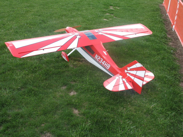

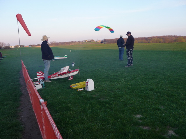

Here's some photos at the field today.

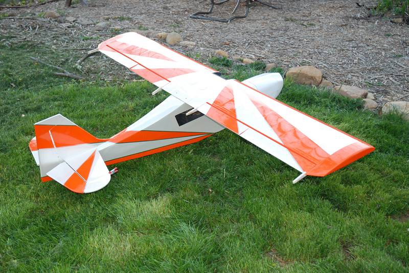

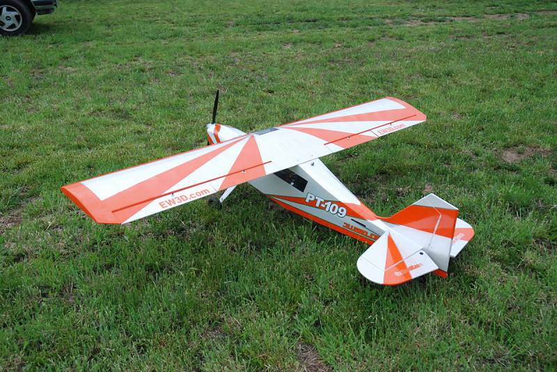

Since I stole the basic design from PT-02B, which is yellow and blue... I thought well, PT sounds good but I can't do 02B. 109 popped into my head as PT-109 is likely the most notable number starting with PT... so I guess it's named after a PT boat? Or is it named after another airplane? It just seemed right. Maybe I should have looked up the number from the PT boat from McCale's Navy? Anyway, I do have a few more stickers for it. They'll go under the wings in that large white area.

First, the light ply firewall compressed badly. I'm using stand offs that are like .75" in diameter and they still pressed down into the wood pretty easily. On the bench, while running/warming up... one of the motor bolts and mounts fell out. So, it's lock tite time! Hopefully it has compressed now and will hold better. Also, I had a moment of really bad luck that was at great timing! My ignition battery has deans plugs. I ran servo sized wire to the voltage regulator. Well, on the bench, we started getting a bad power signal as indicated by a LED. Messing with it I found that the wire had broken at the end of the solder to the plug and was making intermittent contact. WHEW!!!!! Glad this was on the bench! So, I replaced the wires with nice 14g silicon coated wires and have them strapped to the model before it gets to the more fragile wires. So, a rough unplug should have no effect on the lighter wiring. Live and learn and this lesson was awakening and wow did I use up a pile of luck.
So, after these fits and starts, I finally got it into the air again! The weather was pretty darned gloomy with only one moment of brightness... so my photos aren't the best. They do however represent well what the eye was seeing with regards to the model.
The first and second are just it flying by. The third shows the bomb doors just beginning to open, the fouth the 13 eggs dropping out and the fifth just a lone model on a dark and gloomy evening at sunset.
Do335a... I would suspect I'm often times out over 1/4 mile and very rarely over 1/2 mile. Pretty much as far as the eye can see is my limit. I have one glide on a Cularis that went just above 2200' AGL. Given the offset angle, that could have been 1/2 mile or so. It was a spec for sure! I just need to get in flights on a noise maker. Total of 5 so far and I just need to adjust to not listening. It will come.
And a couple of notes....

These pics are in an erratic order.... but here they are. The day of the maiden we had a little extra air traffic to contend with.
Our field is actually a registered air strip. On this day ( of all days) we had about a dozen para-sailers (I think thats what they are called) to share the airspace with. But all worked out well.
A friend of mine had a Giles 202 to maiden, powered by a 1.60 os, just like my decath. We got them both done on Sunday, with two flights on each. A very good day indeed.
My second flight I decided to full up the smoke tank and give that a whirl. Worked out great!!! I might have to back off on the flow rate a bit but all in all I was very happy with it. As also I am happy with the 2 flights I got on the decath.
Feels good to finally have her done and in the hangar. I am very pleased with the end product. A very nice flying plane.... with hopefully many many days of enjoyment to come.

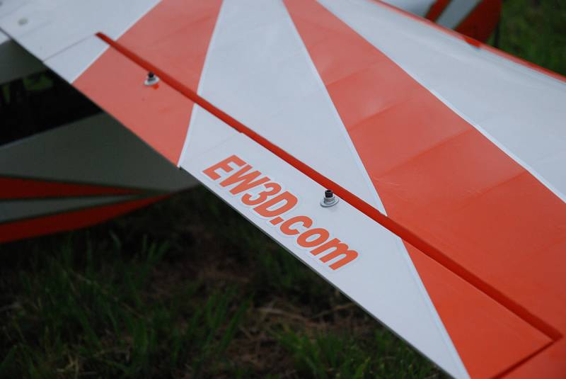

EL ****CANO
I could not read a single word in your forums but the
's are
's; in any language. Great looking model. What was that you places around your windows? That was a nice touch and a good look.
stevo revo
If that last picture you posted was bigger, I would use that as my New Desktop
EL ****CANO
's are
's; in any language. Great looking model. What was that you places around your windows? That was a nice touch and a good look.stevo revo
