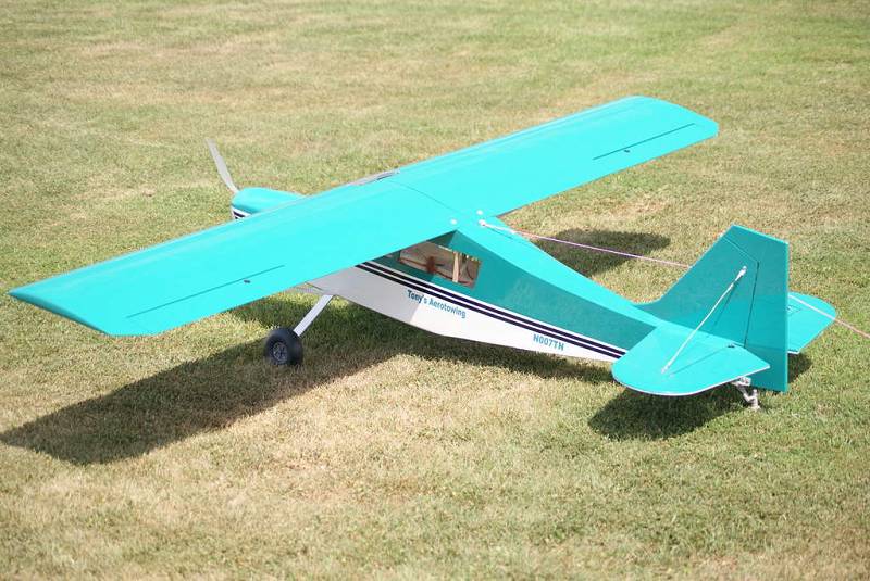

My Super Decathlon is almost finished again after a big overhaul.
Only thing needs to be done is making the new ordered cowling to fit.
Here my Super Decathlon page:
[link=http://www.***************/berto/decathlon/decathlon.htm]BosModelAir Super Decathlon[/link]

Thanxs for the compliments.
I also can convert this plane in 15 minutes to a floatplane:
[link=http://www.***************/berto/drijversdecathlon/drijversdecathlon.htm]Super Decathlon on floats[/link]
And some pictures:
More pictures of this floatmeeting here:
[link=http://www.modelbouwforum.nl/forums/watervliegen/57506-fotos-watervliegmeeting-zevenhuizenplas.html?highlight=zevenhuizerplas]Water fly-in in the Netherlands[/link]
And some pictures:

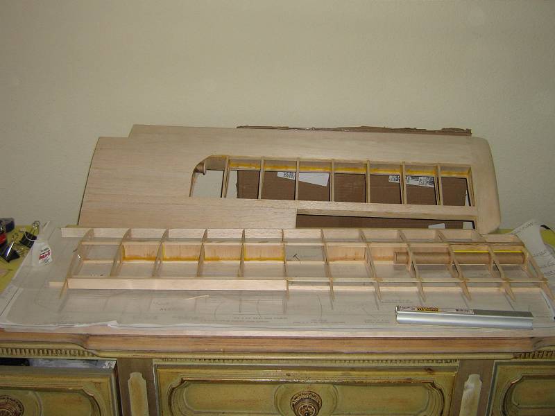

My SD arrived late Tuesday evening.....after making a couple of copies of the plans, (that way I keep the originals pristene), I got started Wednesday evening and so far have the vertical, rudder, horizontal and elevators framed up......I'll start on the first wing panel Saturday afternoon. So far, everything is going smoothly. I have a newer model GP engine mount that won't have the engine sitting so far out on the mount rails. I'm using a Saito 150 for power. I ordered the Fiberglass Specialties cowl and wheel pants. ( I really hate ABS). I am also using a CB Associates leaf spring tail wheel assembly...you can still get them from K&B.

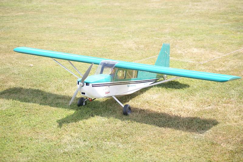

@ rsad,
it`s not a kit it`s a ARF from Modell Expert: http://shop.lindinger.at/product_inf...ducts_id=56562 (I see that Lindinger even uses my photo`s and video`s
I bought the plane second hand 2 years ago in 2006, completly overhauld and modify it beginning this year till what it is now.
The plane is also suitable for waterflying, the conversion will take about 15 minutes.
Here the pictures of my S. Decathlon: http://www.***************/berto/decathlon/decathlon.htm
And the floats: http://www.***************/berto/drij...sdecathlon.htm
).I bought the plane second hand 2 years ago in 2006, completly overhauld and modify it beginning this year till what it is now.
