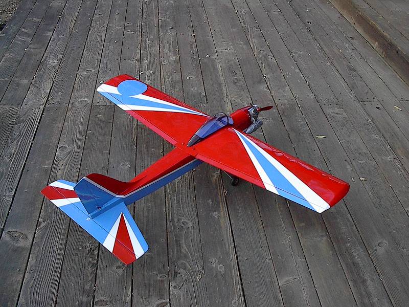

This is the Kav I built for A club member last Oct. but it took A while to post up. On maiden it took ZERO trim and flies like A rocket, should be A great racer for our club events. We have A Kaviler class so it won't fly against any other types of planes. Powered by A TT Pro 46 and it came in at 5.4 pounds and still has A lot of places to drop the weight. I'm very impressed with the kit and the wood was second to none. I did have to remove some weight from the wing to get it to CG correctly without adding any weight. The cowl did have to be repainted with A better matching paint too.

In this plane it tended to be nose heavy and they always seem to have A fuel draw problem do to tank placement. I just used everything that the owner gave me for gear and he was nervious about weight so he gave me everything that was light as he could get and still work. I installed an 8oz tank and made it fit as high as I could in the bay, almost got it level with the carb but not quite. It worked though and no draw problems.
I like to assemble the plane in the bones and set it on the GP CG Machine then place the gear on the plane to see where I will want to place it. I make my own servo mounts and just use rails. I took some hole saws and drilled A nice pattern of holes in the LE sheeting from the fuse to the tip both top and bottom between the bays. I used A carbon fiber shaft for the push/pull control rod on the elevator plus it's short, the servo is in the aft section of the fuse and hatched. The 600 mAh battery is also back there. I made up my own pull/pull rudder system with 30 pound wire fish leader. It's very light and works great, I even use the system in 28% stunt planes, it's very strong.
There is more room to get it light too. Foam wheels and drill out the landing gear. You can also drill out A lot of wood in the fuse because this little plane is really over built and tough.
There is no lead weight in this plane at all. I also used A servo for each aileron.
Keep in mind it was built to race but I think there is A problem making them too light so I didn't do A lot except watch how I was building and didn't lean on the glue bottle too much.
If you want A great little stunt plane this is A good choice but I really like the Extras and Sukhois better, that's just me though, what the heck, I'm A Bipe lover anyway so what do I know??

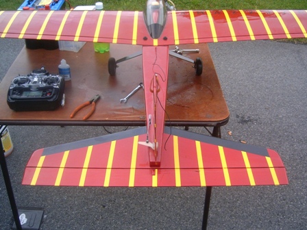

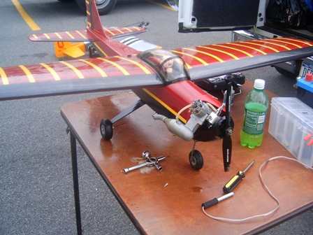

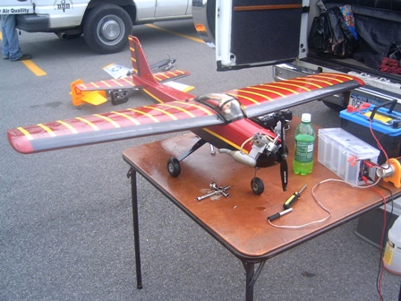

hey guys just found this thread! I have a kav too I got it for free from my buddy getting out of flying. has an enya .40 for power and Gargamel for a pilot! always wondered who produced this kit. He bought it from a widow some time ago.

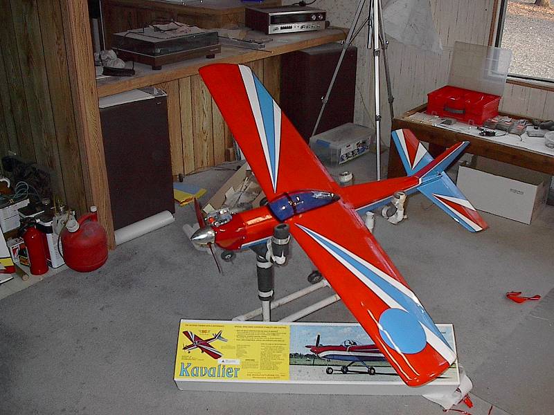

This really is an old post, I'm surprised there isn't somethng just a bit newer?? I built this one in 0-5 for A friend to fly in our club races. Outstanding build and A super plane to fly, bult like A balsa tank!!! Great first kit without any surprises. My friend wanted it to be covered so it matched the box, it was close. Sorry, I always give the blue prints/plans to the owner of the plane. You can get them from SIG if you can't find someone with A set.
