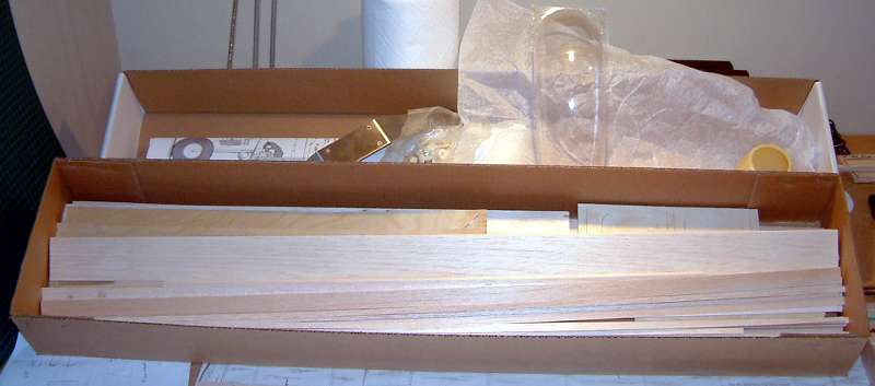

Well here goes for my second kit build, the Kavalier from SIG. I was looking for a more aerobatic model as my second plane following my Kadet LT-40 trainer and one I could utilise the engine (OS .46AX) from my trainer in. While there may be "better" planes out there i was tempted by the "craftsman" style of the Kavalier kit (it's gotta last me all winter!), the semi-symmetrical wing design and the fact it offers something different to all those 4*'s and Tiger II's
. On receiving the kit it is obvious that this really is a "builders" kit, lots of balsa stock in the box, with the exception of the wing ribs (die-cut) and a few other parts nothing else is pre-cut. Also included in the kit is the standard nose gear, aluminium main gear, motor mounts, CA hinges, all the screws, nuts and bolts needed, clear plastic canopy and ABS cowl. This does leave some hardware to buy i.e. wheels, fuel tank, control rods, spinner. For these I have opted for the sullivan skylite wheels, a sullivan RST 12oz tank, sullivan gold-n-rods for the elevator and rudder and tru-turn aluminium spinner.
Flipping through the build manual i'm again pleased with the quality of the instructions in these SIG kits, lots of good photographs to show each stage and clear descriptions for each step. Some of the pics give away the age of this kit design, for example the control rods are balsa sticks with wire bound to each end and there's a good section on covering with silk and dope. The build sequence is pretty standard, first is the wing followed by fuselage and finally the elevator and rudder.
So here are a few pics, i'll follow up soon with detail of the wing build.

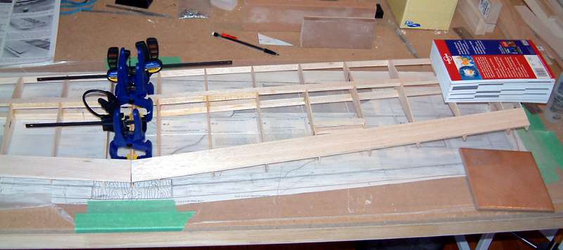

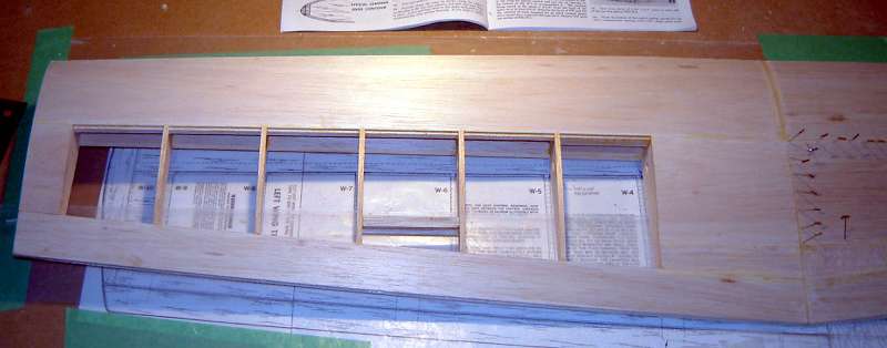

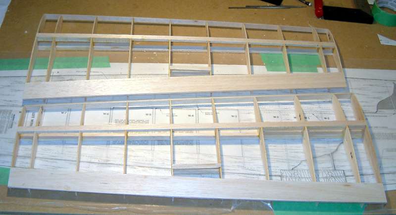

Well the build is well underway, just catching up here as i'm half way through the wing build. For the wings i intend to add wing mounted aileron servos, side mounted and hidden under custom hatches. I'm also clipping the ailerons from full length so that they end at the next to last wing rib about 1 1/2" from the tip, cosmetic more than anything as i like the look.
The wing build is fairly straight forward so far, pin down the bottom spar with doubler at the root, then glue down the wing ribs. I'm using Titebond II wood glue as i have seen it recommended a number of times here on RCU rather than CA, and 30min epoxy for when the instructions call for it. So far i'm really liking working with it, makes for a much more relaxing build!! and no nasty CA fumes
The pics below show the wing halves so far and just got to the point of joining them. I have added a small rear spar between ribs 5 and 6 on both wings to give a support for some hardwood anchor blocks i'll screw into when attaching the sevo hatches. Also cut small holes through ribs 2, 3, 4 and 5 to lead the servo wires through just rear of the main spars. So far i'm really liking how the wing is looking, nice profile and with the sheeting and rib caps on it'll cover really nice too.

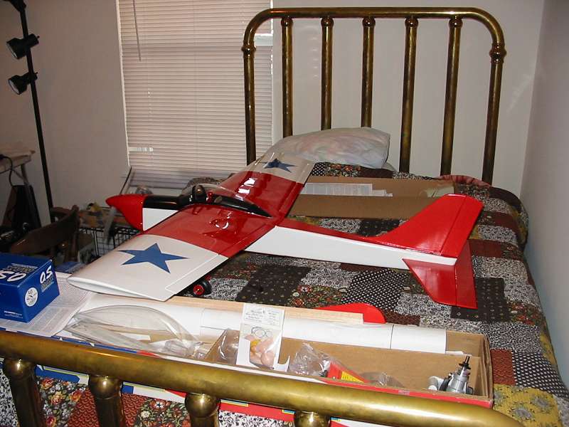

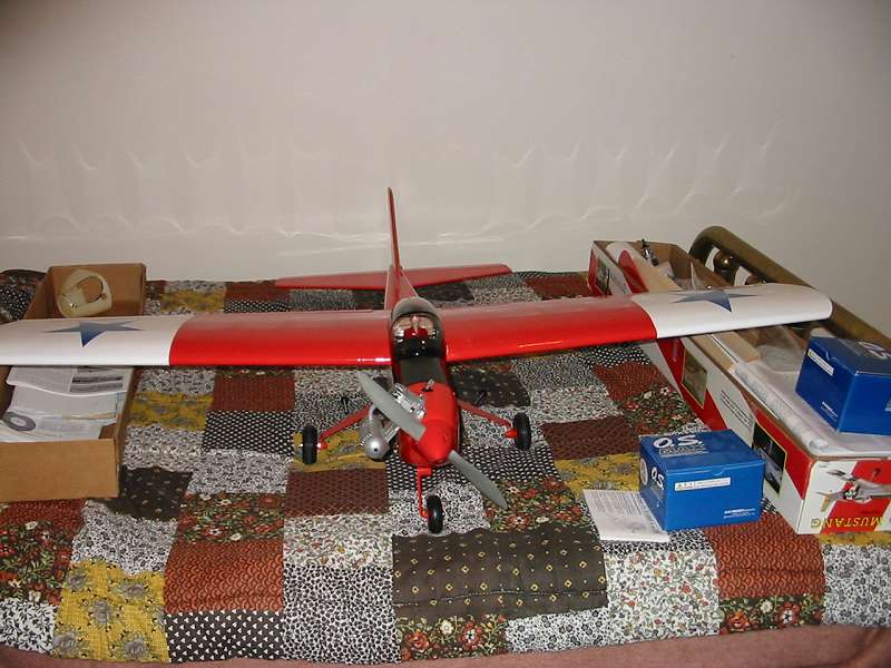

My ailerons also end short of the wingtip...even with the second to last rib. One note is to make sure you seal the hinge lines, because mine had some flutter when i first flew it (ailerons were sealed, but rudder and elevator were not)...i've since changed props and sealed the other surfaces and it is no longer a problem. I only have one servo on the ailerons, but it is beefer than a standard servo.
Thanks for you compliment on the covering...the wing is monokote, the fuse is actually glassed and painted (as an experiment)...liked how it came out and learned a lot in the process...
I have a few more build pictures, and can always take more of the finished plane if you have any questions...i love this plane :-)

Thanks for the tips ZeppelinIII. I was going to try using hinge points on this build, i have some thunder tiger ones which are steel pinned and look like they'll be a perfect fit (maybe half the size of the Robart 1/8" points). Like the look of your glassed fuselage too.

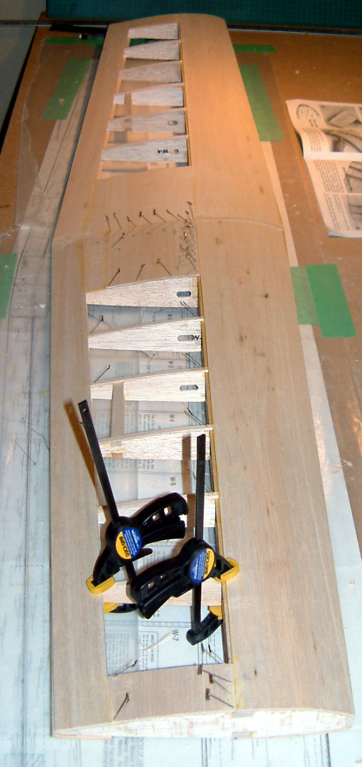

Well slow progress over the last few days, not had too much time to play! I joined the wing halves together using 30min epoxy and am now adding the leading edge sheeting, pic below. Will add more when i've done it!!

Good progress this weekend, the wings are really shaping up with most of the panelling added, just the underside to do. Looking forward to covering this baby, the wing looks real neat, my only other experience is a SIG LT-40 trainer which although a nice kit is a more "functional" design than this. Before adding the panelling to the bottom I will add the hatches for the wing mounted servo's. I have some scrap 1/8" ply I will use as a tray and add a 1/16" balsa veneer to, which i can then sand back to the contour of the underside of the wing. Will post some detailed pics as i'm doing this. Before adding the panelling the wing structure felt really flimsy but now the sheetings on i'm actually surprised at how rigid it feels. As i mentioned before i switched to regular wood glue on this build and its working out a treat, i really like the time it gives you to set up the pieces and align them perfectly together, i like to "feel" any joint i'm making for alignment which you just couldn't do with CA. Anyway a couple more pics below to show my progress..... hope this lasts me all winter!!!

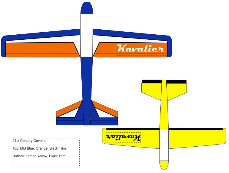

PilgramChimp,
Good looking color schematics for the Kaviler, tough choices. Was wondering how the build was going? Currently, I'm also building the Kaviler which is coming together nicely.

Thanks for the reply's guys, the build has been a little slow over the last few weeks as work got in the way but am now finished for the holidays so will be progressing it a little quicker. At the moment I am in the process of finishing the wing leading edges, not too difficult just takes time. I built this wing as the instructions said with all the dihedral but if i have time before the new season next year will scratch a modified wing which will have no dihedral and will probably leave off the wing tip blocks also. This was my first (half) year in R/C so while the first wing will be good for me while i learn to fly this one thought the second wing would keep it interesting for a longer while. Anyways will post again soon with some more updates.

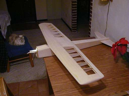

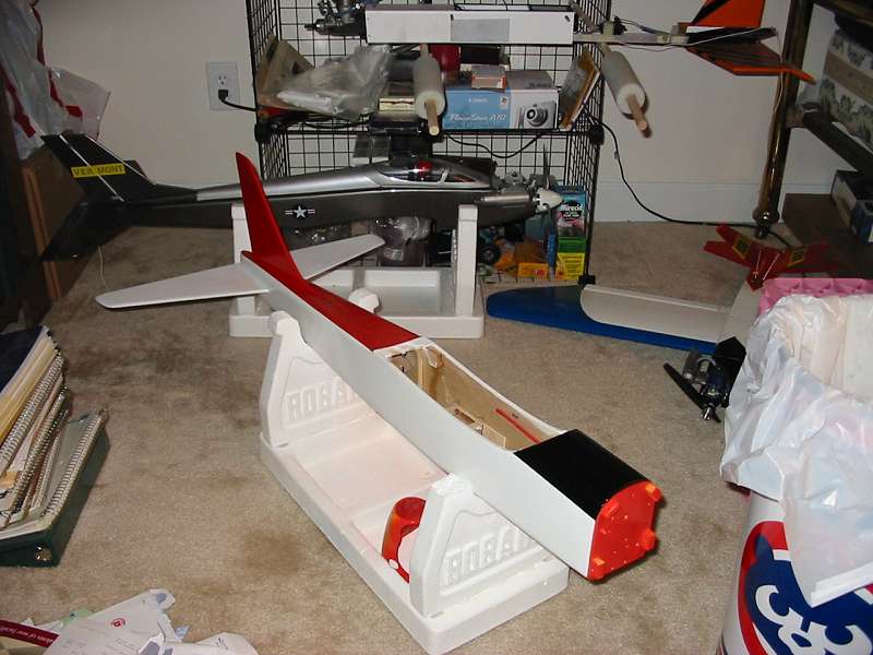

Hello All,
Still plugging away at the Kavalier, haven't had the time to spend on it lately do to the holidays however small progress is being made. In addition, it's my first real build so that has slowed things down a bit too! Thought I'd also give a try with posting a couple of pictures.
[img][/img]
[img][/img]

Thanks for the comment on the wing tip. Actually the wing tips weren't that difficult to do. However, I was intimidated before I started. A lot of time was spent just looking and trying to figure out the best method to carve the tips since previously I had absolutely no experience as a wood carver.
What I did was purchase a small wood planer and a medium sized block of balsa(to test on) from the LHS. Once I felt comfortable with the planer practice I temporarily glued on the balsa blocks to each side of the wing with Ambroid glue. After the glue was strong enough to hold the tip and with support from my free hand I started carving the tip down with the planer. Once I was close to the shape I wanted I switched to rough grain sand paper for the final touch ups. It wasn't as difficult as I thought and I felt the wing tips came out better than my expectations.
Hope this helps, I'll keep you updated on the progress, this weekend I'm going try and cut in the cockpit area and add the plywood support to the center trailing edge of the wing.
