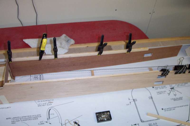

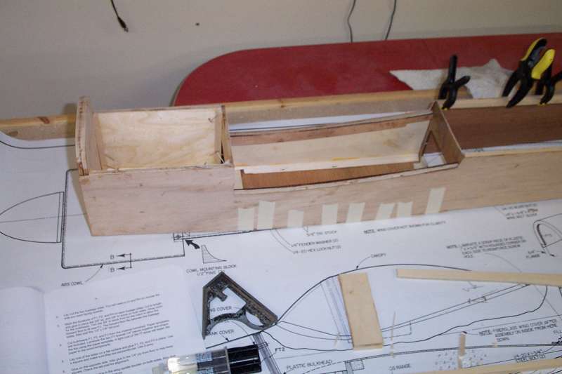

Here are a couple of pictures of the fuse. The front is double with quarter inch ply. I am almost ready to glue the rear end together.

Looking good, I completed my wing tonight. We are getting a snow and ice storm here in Va. so I will have time to work on it. I will start the tail section tomorrow. How much do you think yours will weigh when done. My flying buddy has talked me into useing carbon fiber tape on 3/8 spurce spars to reinforce the fuse. He thinks this will be lighter than light ply, I hope he is right and is strong enough. I dont have way to put pictures of my build on line. Will let you know how it goes. Wayne

I really do not know how strong the taped spruce spars will be. I always have a tendency to build stronger than necessary. After a long look at the sides that came in the Stinger kit I decided to double with quarter inch ply. It will be interesting to see what mine will weigh. My fuse ready to cover. Started sheeting wings today.
