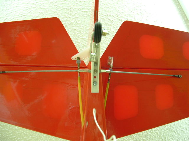

RE: More something extra building questions
hancop,
The 1/16th wire tail wheel strut WILL fail you; its just a question of when. And it is a severe PITA to replace when it breaks.
You got good advice on question #2; save those included pushrods for antenna tubes on your next kit, or something. But don't use them for their intended purpose.
The photo below will answer your other questions, I think. Note how the front of that DuBro tail wheel unit has been relieved to accept the tail braces, and use the existing hole/blind nut. Also check out the way the tiller (steering arm) is attached to the rudder. If I have ANY problems with that assembly, it is a five minute job to replace it; no muss, no fuss.
This mod is easy to do, and you will wish you had when the supplied (and weak) tail gear breaks...

I used the Sullivan tailwheel but you have to plan for it in the build. Mine is over the wire mount. I recessed the clevis into the plastic so it will be flush with the fuse. Will post a picture.

As promised here are a couple of photos of my Sullivan tailwheel. I planned the location, drilled the holes and placed the blind nuts. Everything lined up super. As you can see the screw for the wires goes through the tailwheel mount. We have twenty flights on this plane so far with no problems.

I used the sullivan tailwheel just like rocketman did. I took a square file and turned it on its side and filed a small channel in the tailwheel bracket to allow for the space. No problems with mine yet either. On the antenae, mine just dangles out of the back and I have had no problems with it catching in the wheel. I did use a cut up servo arm with it threaded through to hold it in place. I put one in the servo tray area and where the antenae exits the bottom of the fuselage.
