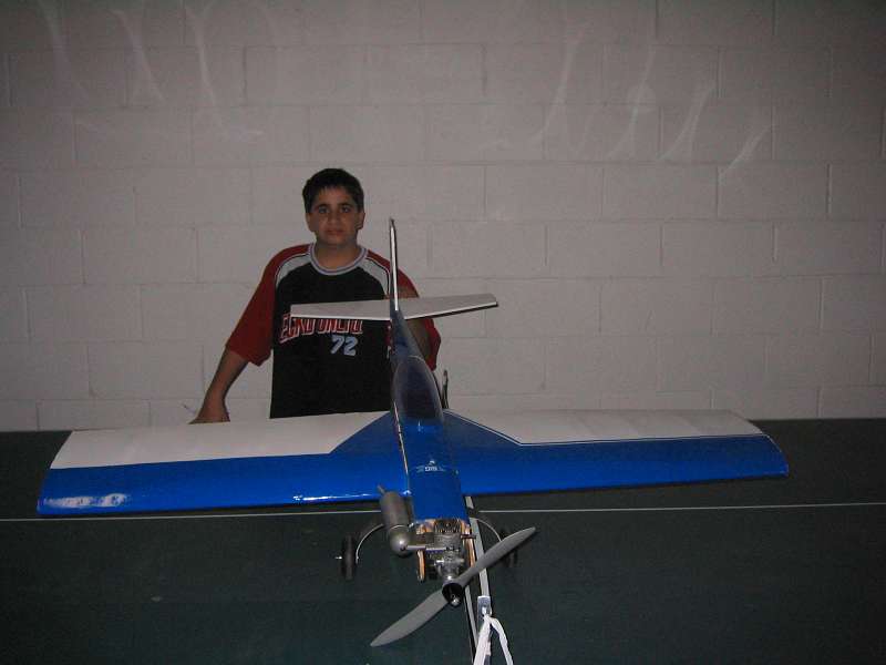

Here is my almost completed somthing extra. It was my third well first kit! enjoy the pics, and let me know what you think! Show yours if u want!!!!

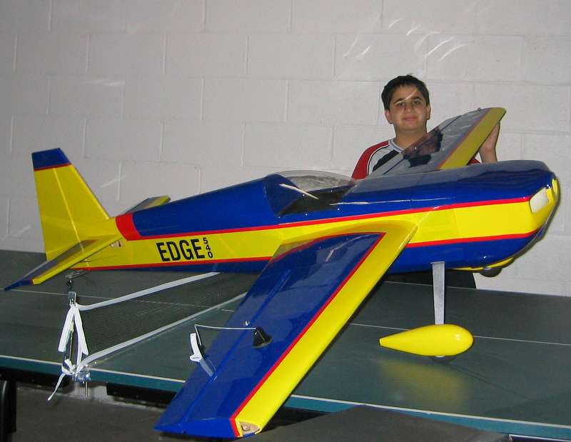

Golly. 2 planes. You have a new 23% EDGE too. sheesh.

Nice job! Especially for a first time covering job. I remember my first attempt. I really wouldn't want to show it. You should be proud of yours, though.
Here is how my SE turned out.
Jason

23%

great looking plane

ORIGINAL: sir-crash-alot
any other coments cus this is sad
Know how you feel. You usually have to have a rare or scale-type plane before you get much attention. Just go fly it hard and get peoples attention that way. I have learned to impress myself and let everyone else decide whatever they want. It is all about YOU enjoying your hobby, so go enjoy it!
You will enjoy the SE. It is a great flying plane. I added a large counter balance to my rudder, and it will only barely hold a KE. I am not sure why. The stock rudder looks rather large, but reviews said that it wasn't large enough.
If you have any questions, let me know.
Jason

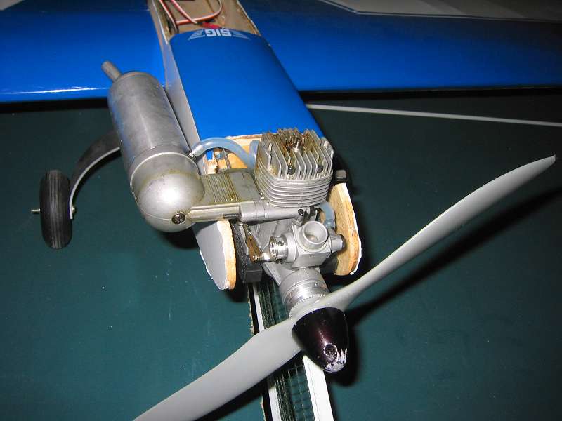

One word of advice, for what it is worth, you might want to either epoxy the bare wood around the engine or cover it with monokote. Fuel will break it down and weaken it. You may have alreay used epoxy but it is hard to tell from the picture.

Yea get some 20 or 30min finish cure epoxy and an epoxy brush and get all around the engine area. BTW You might want to seal the covering a little better in front of the cheeks, I made the mistake of not sealing the covering on my wings and i thought it would be fine but 5min into the flight it starts acting wierd so I land it. a huge piece of covering on my wing peeled back, Im surprised it didnt crash. That is a very nice covering job though, my first time didnt come out so bad either.

to late haha already did in october.
