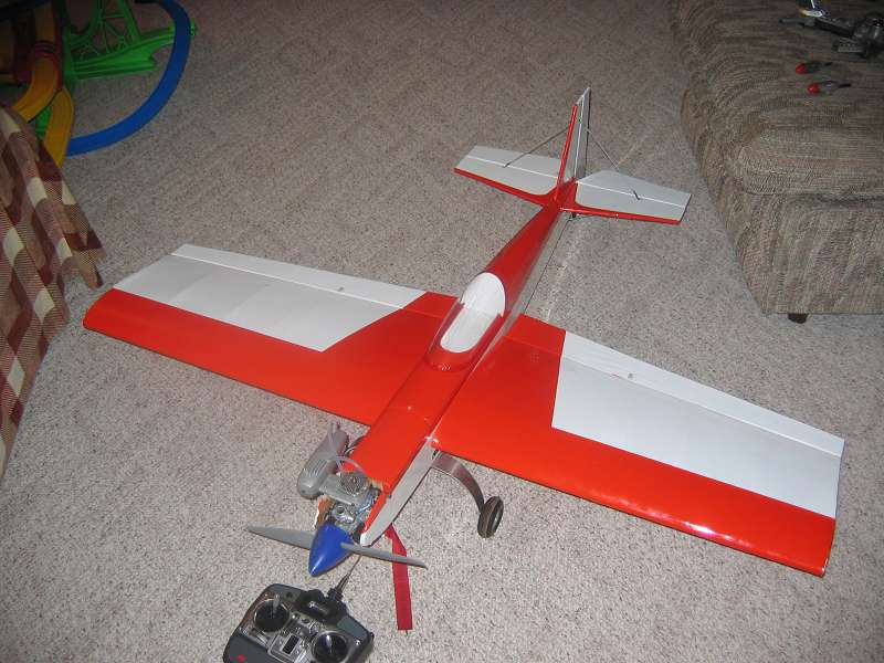

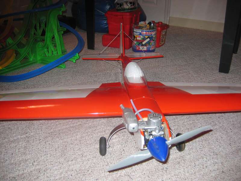

So in your opinion, would I be better off just building another 4 * or is there enough difference in the flying characteristics of the SE to rate it over the 4 *? Sorry to hear about the demise of your SE, it looked really nice. Here's what my 4 * looked like up until yesterday afternoon

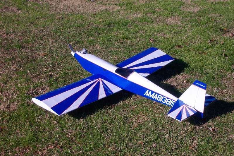

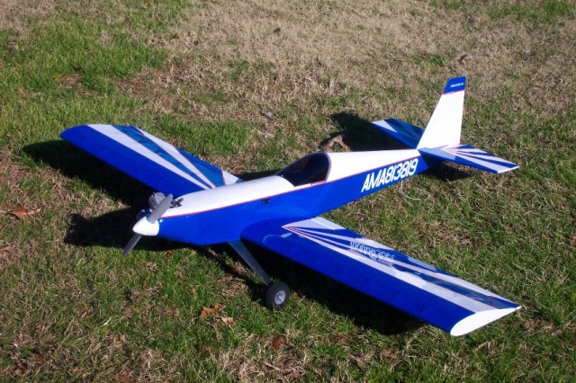

All i did to mine was put metal pushrods in, and a different tailwheel on. I didn't glue the cardboard wing tube in the fuse, so i could take the gas tank out. I want to get a taller landing gear, my 12*4 prop is now an 11 1/2*4. You will love this plane, keep the rates really low for the first flight.
Heres mine, I am getting an aluminum spinner, the blue one was just so i could fly.
