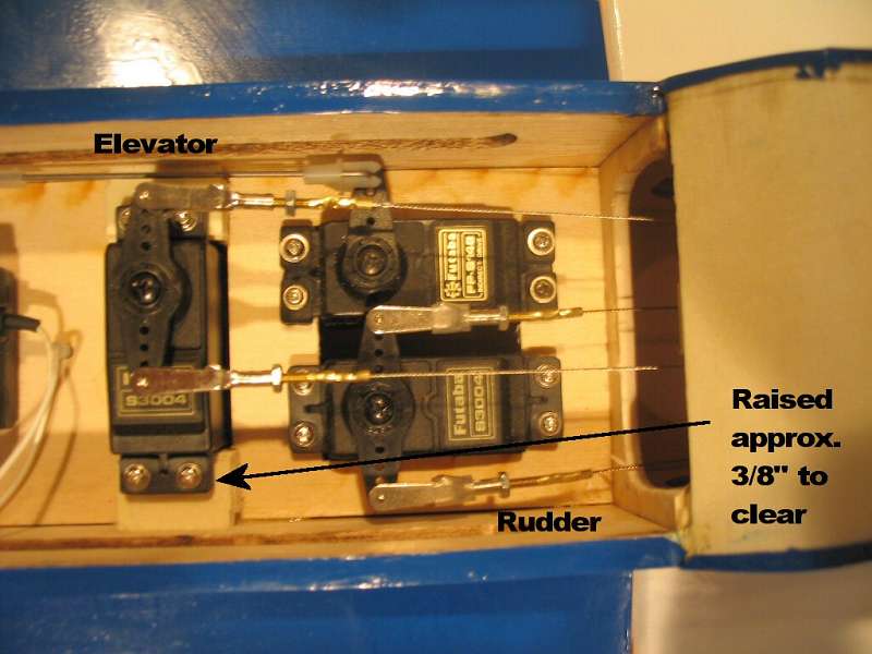

I finished the SE a couple of weeks ago and I have flown it about 10 times...
Specs:
Engine - Ervine .53
Prop - 11.5 x 4
Weight - 5 pounds 4 Ounces
Mods:
Pull Pull Rudder
Pull Pull Elevator
Replace flying rods with wire
Sullivan tail wheel
Setup:
Low rate per manual
High rate per manual
Flaperons with elevator mixed in
CG - per manual
Results:
AWESOME I love this plane.....
First flight was no problem for me with the low rates per the manual,
after a little trimming I flipped on high rates and this thing came to life!
I was able to go vertical as fast and as far as I wanted with authority!
Roll rate is really fast and it would do everything I know how to do
so far. I could flip tumble and throw this thing across the sky and always
feel in control.

Advent,
I'd really love to see how you did the pull-pull on the rudder and elevator.
Did you have to move the servos?

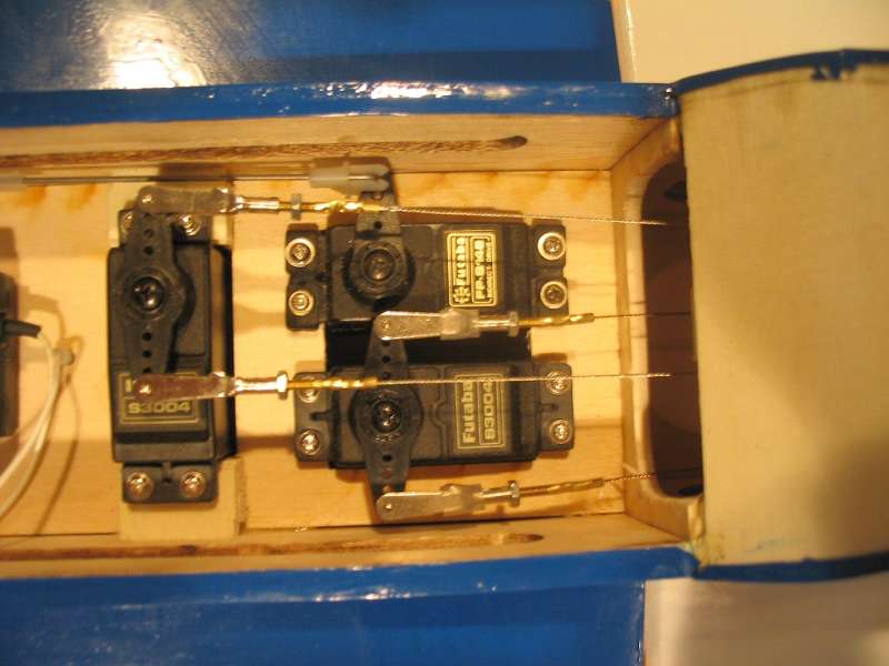

I just switched the throttle and elevator servos and raised the elevator servo
up about 3/8" to clear the other servo's. I glued short 3" or 4" exit tubes
into the fus during constuction and ran all the wires prior to covering. Once
everything was in place I labeled the wires and removed them.
The rudder and elevator are rock solid with no slop at all. This is the first time
using pull pull, and I really like it. I used 60 pound test .021 dia. steel leader
purchased at BassPro shop, 100 feet was under $10.00 and sullivan 2/56 through
hole threaded rods with Dubro clevis's/clevie [:@] ??

Advent,
Man, that's really a clean setup. I just might have to try that on mine.
What did you use for the exit tubes? I can't really tell from the picture, but are there any problems with the wires cutting into the edges of the exit holes on the elevator?
*Very* nice job on the flag too.

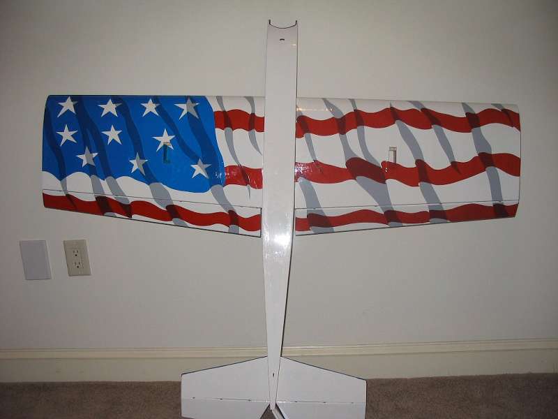

ORIGINAL: krossk
Advent,
Thank you,
I used small sections of the supplied pushrod tube... The wire going to
the top of the elevator looks like it has a sharp angle exiting the fus
in the picture, but it really is pretty straight. I dont think the wires
will cut anything, that nylon tubing is pretty strong, but time will tell.
Yea, the flag makes the rest of the covering look like #@$%.
It is the last time I do straight lines on a covering job, the flag was
a lot easier then it looks.
