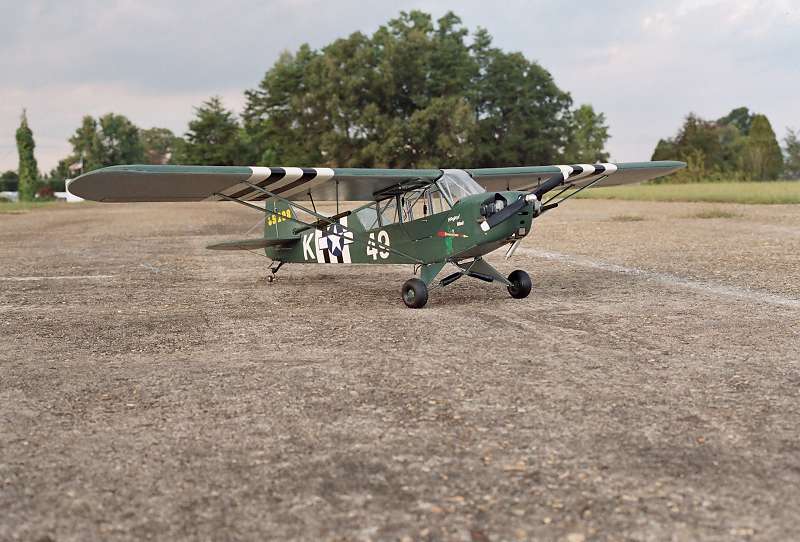

I think Powertoys been watching me fly. I built the 1/5 Sig last winter, everything PT says is true, but because it's a Cub, not because it's a Sig. The Sig is all laser cut; The fuselage is a combination of slab side construction (lower part) and former and stick (upper part), it's all tabbed, fits perfectly, and you'd have to try to build it crooked. The scale is very nice, the right side window hinges up, the door drops down; the servos sit behind where the rear seat goes, so they're out of the way if you want to detail the cabin, but fairly accessable. It's a pull-pull rudder, everything is included for it. The wire gear is durable, but if you really want to take advantage of this Cub's nice scale lines, put a set of Robart or Wallace gear on it.
I built mine as full span, and even at 2-1/2 pounds more than what Sig suggested as the weight range, it still floats. The adverse yaw is easily overcome by programming about 40% rudder in with the ailerons and it makes a beautiful coordinated turn, but a standard bank will have the tail dropping to the low side a bit, but full-size Cubs do it,too. If you want some aerobatic ability, definitely clip the wings, and the Sig plans have all that laid out for you. The wings attach via tubes, and the struts are FUNCTIONAL, can't fly the plane without them.
A .65 Saito almost completely fits in the cowl inverted, a .72 will fit, it's a tad shorter than the >65, and would give you all the aerobatic power you need; both engines will turn a scale 14 inch prop. Mine will cruise at 1/4-1/3 throttle and take off at 1/2. I can't say enough good about Sig's Cub, I love mine. It kitbashes pretty well, too, mine is modified to a L-4 (most of the reason it's heavier). You can't go wrong with this one.

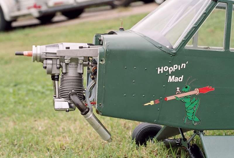

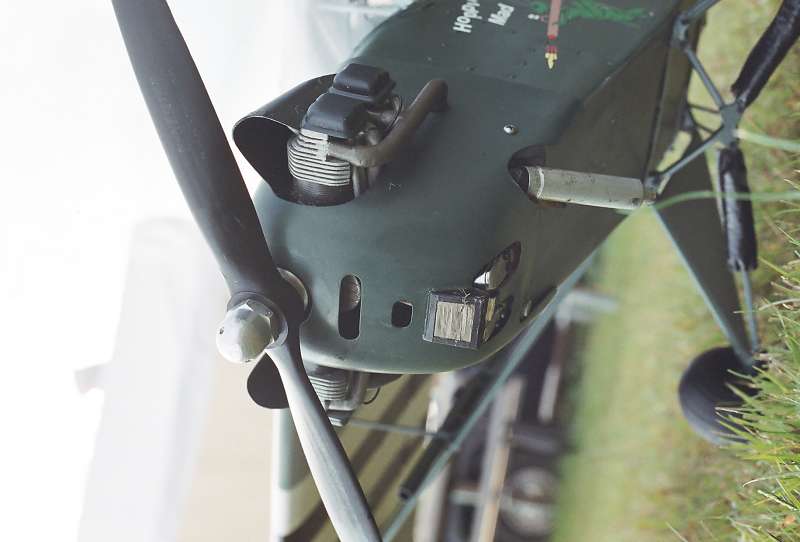

Powertoys- that's what I covered mine in-Koverall and dope. It looks like it would be heavy as hell when you put it on, but after the stuff cures, it's surprisingly light and tough. I've gotten to be semi-expert at repairing mine, mostly runway rash on the wingtips, NBD, but most recently (Past Dec 1st), I had a severe stupid attack and forgot to hook up the aileron servos (I was running my mouth to my flying buddies). I got to see what it was like to fly a Cub without ailerons (to make it worse, one was at about 15 degree right bank) I managed to keep it right side up until I got back to the runway, and stalled on my approach, it hit on the mains and chin and the impact tore the wings off at the root (pulled the end rib out on both of them) and cracked the angled uprights along the sides of the windshield. Took about 2 weeks to fix, but you really have to look hard to see the repair. That's one real good thing about the Koverall, you can dope it on and the edges blend right in. I started out with the plane at 9-1/2 pounds, it's probably past 10 by now, still flies great. The .65 saito just putters by, I've got an older style billet aluminum muffler on it , sounds great
No, but the standard thing to do is to mount it sideways, let it stick out, and install the dummy engine on the other side.
Once it's airborne, you'll never noyice it (Unless, of course, you're a real scale buff)

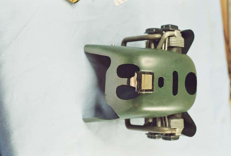

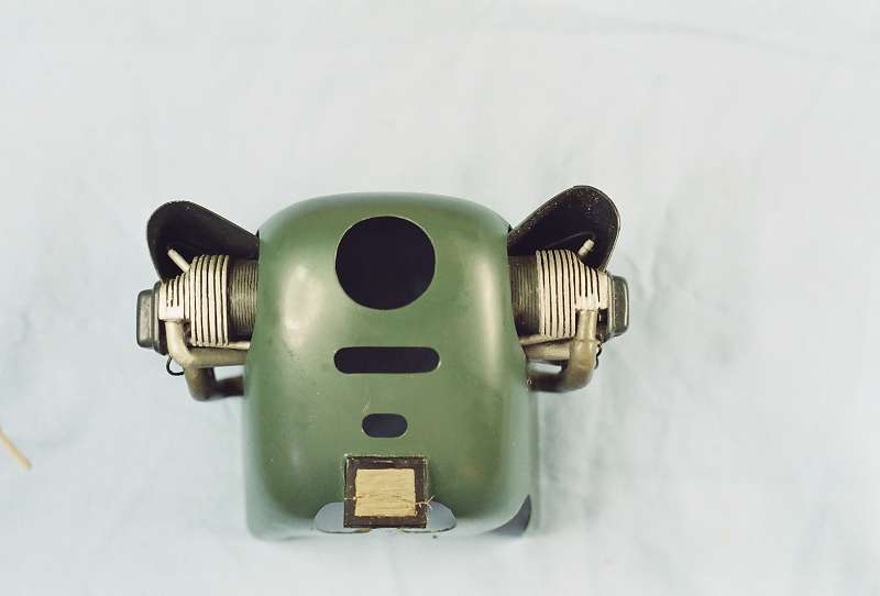

I'd have to kinda sorta agree with Nanook of the North (Minn Flyer) The Goldberg is probably on par with GP to build , probably flies better, but if you're after scale, go Sig. I don't know how the OS 70 measures, compared to the Saito, but my .65 is 3-3/4 in. from the center of the prop shaft to the forward edge of the valve covers (the part that sticks out of the cowl), and at that distance back from the flange for the prop, it would have to be about 3-1/4 to fit inside. It is easier to not worry about it and just stick the motor, uh, engine, on sideways, but us scale freaks like things all nice and tidy and hidden inside. Even if you did have to cut the cowl, it's down under the "chin" and not very noticeable at all, UNLIKE THE BIG GAPING CHUNK (sorry) that you have to excise from the pristine and HIGHLY VISABLE (sorry) side of the cowl, if you do it , ahem, the OTHER way
If you notice the "skint" place on the oil cooler, it's made of hobby ply and is sort of a sacrificial detail, because when it lands and tips up on the nose every now and again, that's the part that takes the grief; it reinforces the cowl and also helps protect the valve covers, and it's easily replaceable.
