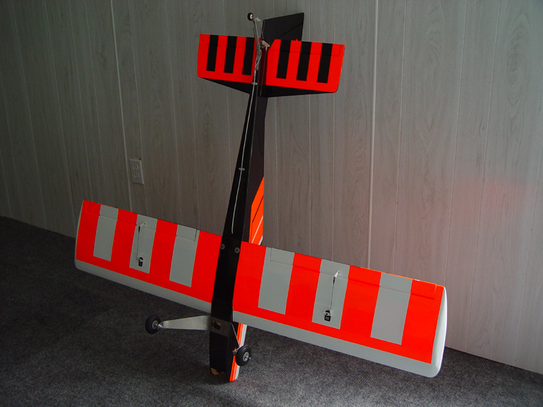

My second Tiger II below:
Aaron

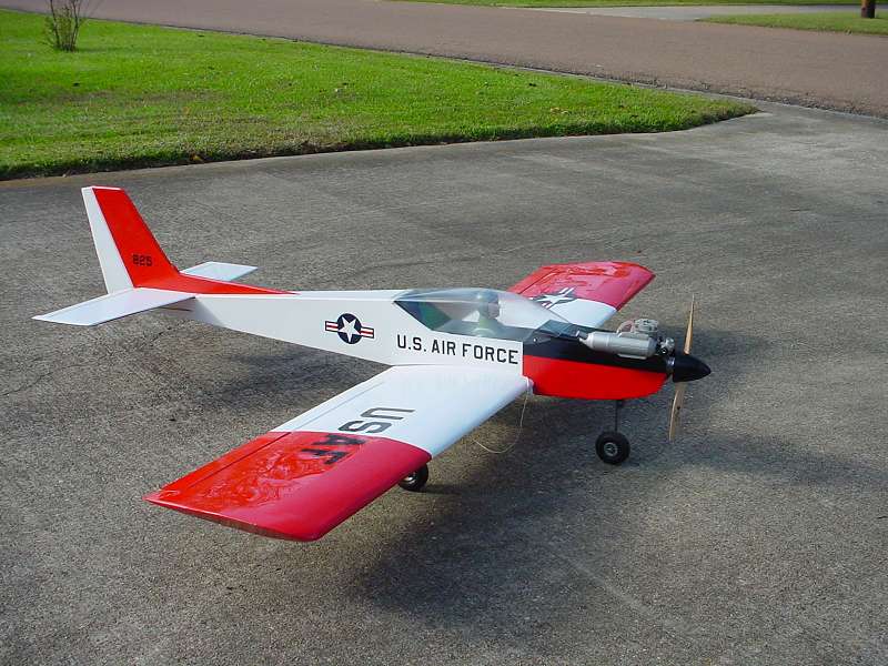

Here is my finished tiger .. I put in the servos in the center of each wing panel, and it wokred great.
Had wonderful flights today and love the plane !
Thanks for all your help
gaurav
